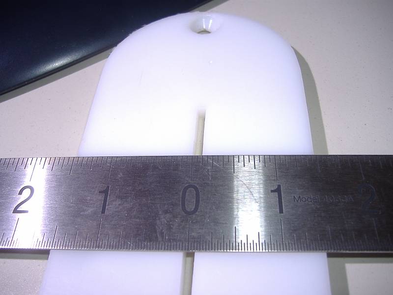

Hi,
I'm sure a bunch of things come into play, but to see what I have on my unit I brought in one of my ZCI's to measure.
In this case I'm only showing the measurement of the ZCI with reference to it self. Mine measured just under 3" wide, the rule was placed at an angle to have the top edge adjusted to 1-1/2" to each side. The 0 then falls along the left edge of the kerf.
[ATTACH]16139[/ATTACH]
Getting into the "rest of the story" is a whole can of worms which I have dug into but do not feel up to sharing at this point.

Are using shopsmith thin kerf blades or standard full kerf blades? Not sure it makes a difference but perhaps. This is why I have concluded my splitter is closer to the right side of the blade (essentially even with right edge of blade but the left edge of blade is slightly beyond the splitter (and the adjustment screw on the upper saw guard is all the way in).dusty wrote:Where it comes to rest is seldom an issue. At least not one of importance. It does bug me, however, that it is so close and yet so far.

FWIW I checked the M5(Goldie) and it positions essentially centered on the insert screws.dusty wrote:Thank you for that reminder. I have been taking the arbors for granted since the only (saw) arbors I have came with the Mark V and the ones I have are all the same.
If we are discussing the same spacer (carriage stop ring (aka rubber bumper) - 516667), we have a significant difference. Mine measures 1 3/8".
I overlooked the table carriage side to support post difference. And the support tube trunion offset. All that will change the 'difference'. I do not have a good way to measure all those things.
algale wrote:Are using shopsmith thin kerf blades or standard full kerf blades? Not sure it makes a difference but perhaps. This is why I have concluded my splitter is closer to the right side of the blade (essentially even with right edge of blade but the left edge of blade is slightly beyond the splitter (and the adjustment screw on the upper saw guard is all the way in).
The thickness of the blade base disc will indeed change the center of the kerf relative to the side against the arbor. Thinner blades(and kerf) would be closer to the arbor(the opposite of what Dusty is describing)
