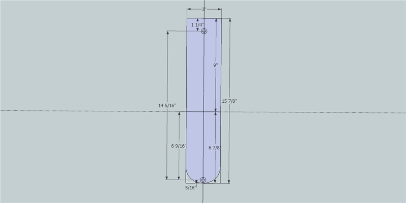

You and I get slightly different table top numbers. Do you agree with these dimensions for the insert?
[ATTACH]16332[/ATTACH]
PS: Ooops. We might not disagree. I was looking elsewhere. But please check my figures- (anyone who has made these measurements and wishes to comment).
