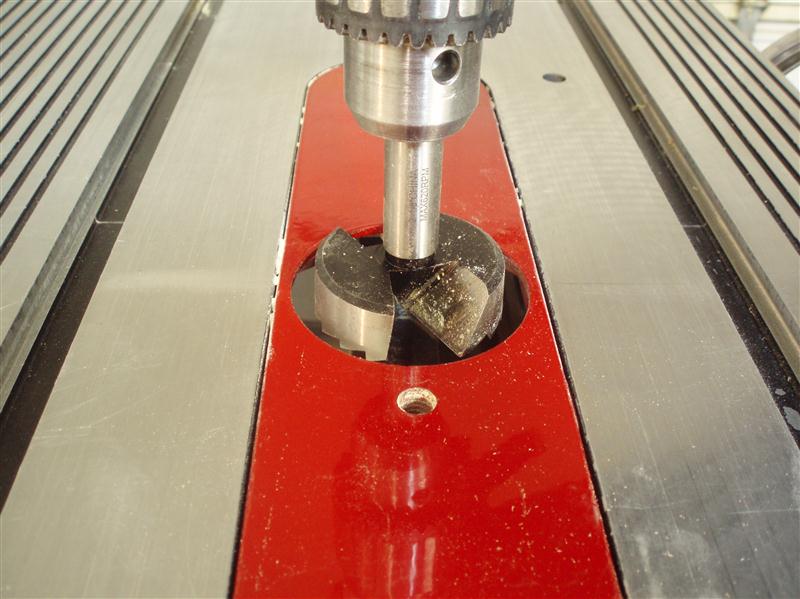

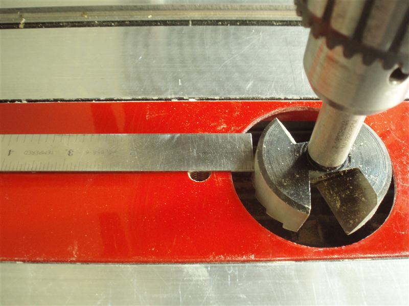

In the attached images you will see that on one axis the cutout is pretty well centered. That is because the table is adjustable on that axis.

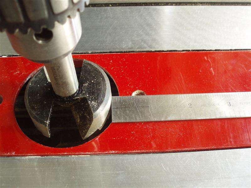

On the other axis, the cutout is off center by about 3/16". No big deal unless like I said you have mechanical interference.
This situation can be avoid by loosening all four trunnion bolts and moving the table appropriately on that axis (while not disturbing its position on the other axis:eek:).
[ATTACH]16285[/ATTACH]
Centered by Table Positioning
[ATTACH]16286[/ATTACH]
Measures 3/16" offset
[ATTACH]16287[/ATTACH]
Measures 3/8" offset
NOTE: I used the forstner bit here as a reference point only. The insert shown is intended to be used with the sanding drum. Please don't ask why I did not use the sanding drum.
Moving the table 3/32" is just not worth it to me.

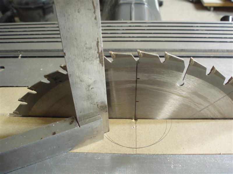

This shows the centerline of the arbor brought to the blade where I scribed a line to the insert.

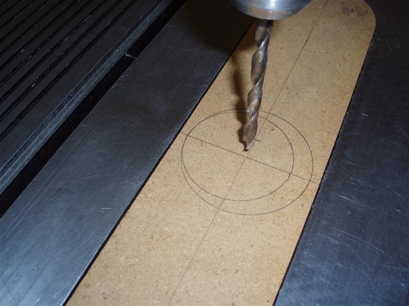

The two circles are the cut outs on the drum sander and router inserts. Their center one line (diagonal) does line up with the drill line

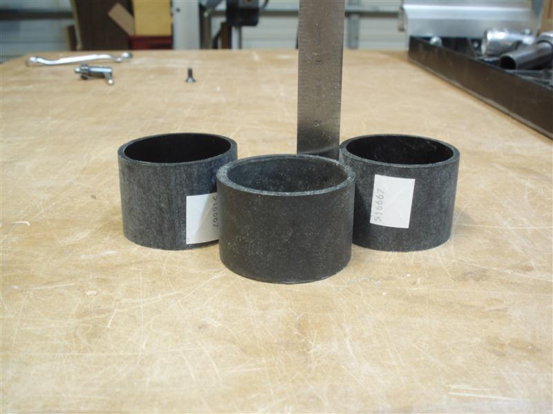

These are the two new carriage stop rings and they are not the same size as the old one. I cannot explain why they would be different. Since the old one positions the carriage so that the center line of the insert aligns with the saw blade, I have chosen not to install the carriage stop rings.
I did put one in but it moved the cut line off the insert center line. I went back to the original stop ring.

I don't suppose the new ones are 3/32" longer than the old one.dusty wrote:Reible: I think that I have returned my table to its original position. However, I don't know why I think that. I seem to have lost the logic needed to explain what I have done.

How long are they?
