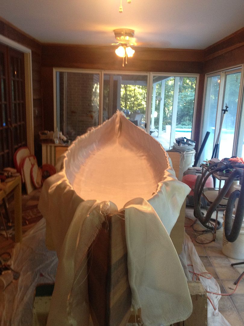

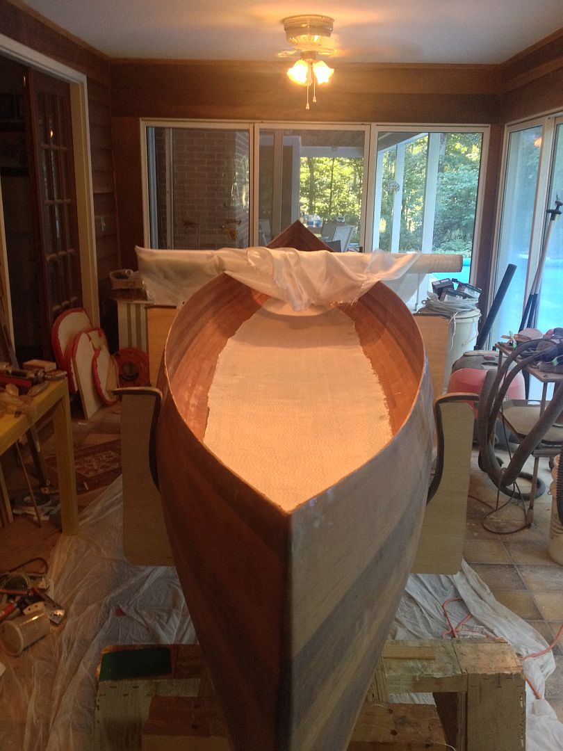

Well, can't put off my least favorite part of the job any longer.
Laying out the glass "football."
More glass.
First coat of epoxy. Don't enjoy working with glass and epoxy at all.
Trying to decide whether I want to add additional coats of epoxy. The weave looks like it might make a decent non-slip surface. Question for Shipwright (or anyone else who knows fiberglass/epoxy): is there any reason why I need to add a second and third coat to the interior?
rjent
Posts: 2121
Re: A Slow Boat To Nowhere
Post by rjent »
algale wrote:Well, can't put off my least favorite part of the job any longer.
More glass.
I built a twin outboard ski boat in the 60's. I think that your strength is there. The rest is just cosmetic. Since this could be a "portage" boat, the less glass you lay, the lighter it will be. Glass is very strong stuff .... :D
JMHO
Dick

shipwright
Posts: 1165
Post by shipwright »
You're good Al. As long as the glass is fully wetted out (transparent) you don't need to use more epoxy. It's just weight and expense.
Looks great!
