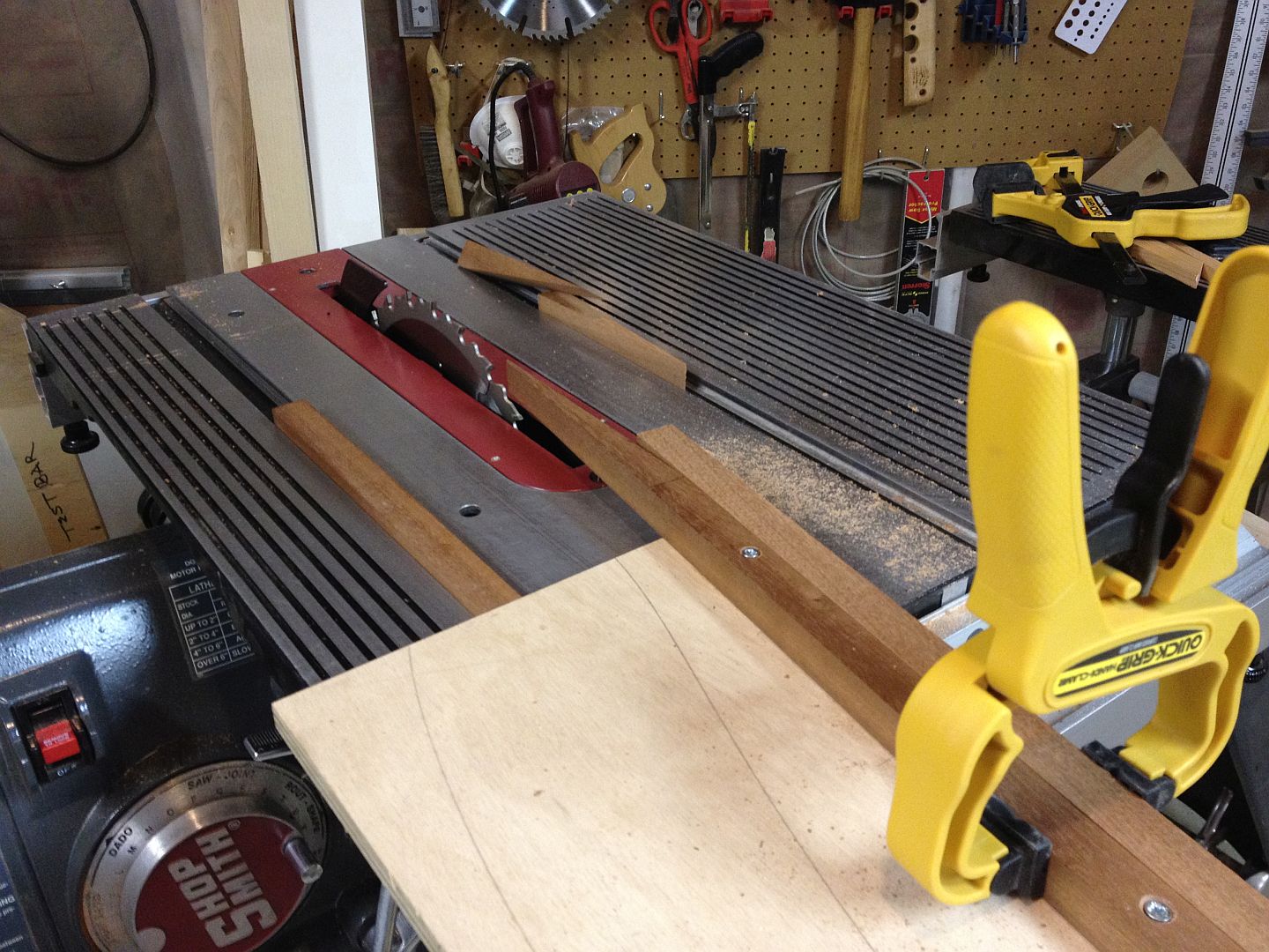

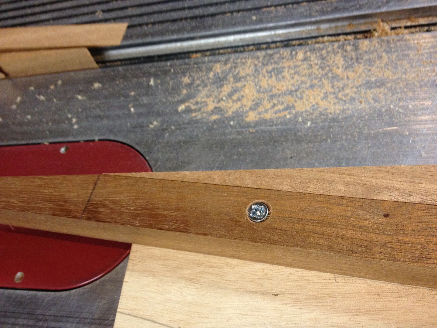

This is a little out of order, but I wanted to post a couple more pics of the scarf cutting jig that shows how it works in operation.
This shows one of the gunwale blanks (the lighter colored wood in the photo) clamped to the jig's fence (darker wood) and ready for scarfing. Note that the the fence is screwed to the base at a very acute angle to the blade (I think between 7-8 degrees), which is why the end of the fence is already tapered; it was effectively scarfed when the jig was run through the blade the first time.
And after running the scarfing jig and gunwale blank through the blade, this is the result: a perfect scarf.
Easy as pie. Just make sure you have infeed support for long pieces (not visible in the pic is that I have a roller stand supporting the long gunwale).
