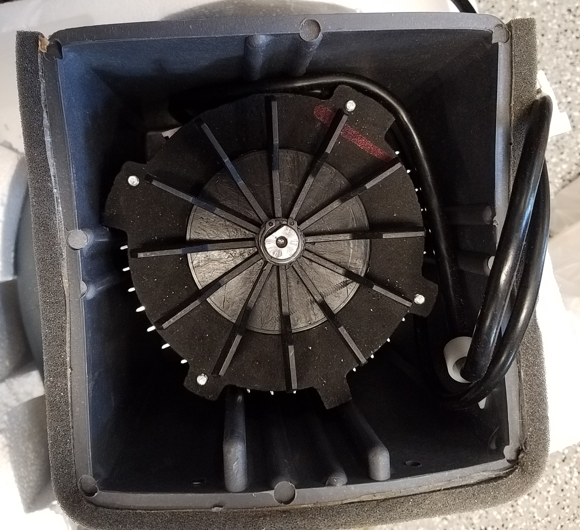

Can't do. The unit comes fully assembled and only the end cap of the motor is visible and then only partially. I have the Motor and Fan Housing already installed but has not been run yet. Got side tracked by life.
DC-6000 - mine.PNG (742.68 KiB) Viewed 2251 times
Re: New Shopsmith DC-6000 Dust Collector
I assume that is a cooling fan on the back end of the motor? So air over motor cooling.

JPG wrote: Thu Jul 29, 2021 9:30 am I assume that is a cooling fan on the back end of the motor? So air over motor cooling.
Interesting. If the housing is similar to DC-3300 air inlet and exhaust are both through the opening we see in that pic. But the 3300 has air flow through the motor, effectively making two ducts controlling the in/out flow. It is less clear, from the pics, how this one works. I like the idea of the motor being enclosed, especially if it is sealed. And cooled.
As you, I assume that the fins in this picturing are for cooling of the motor but there is no thru flow that I can find. The fins just keep the air moving. However, it appears that the DC-3300 is the same.
- David
I see very little that is similar between the two. Yes, functionally they are identical but not physically,

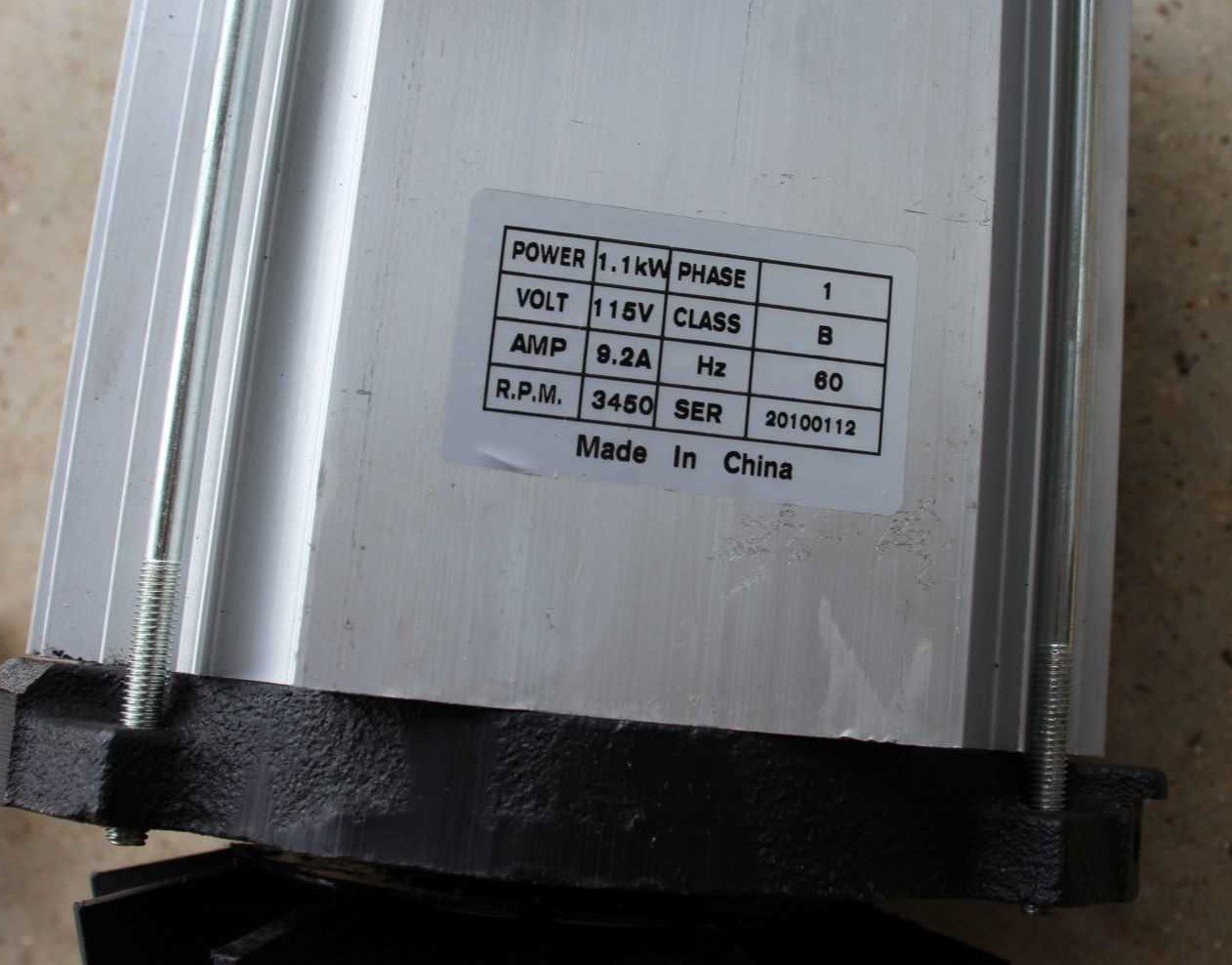

Pictures of the motor from my upgrade kit, with a closeup of the label:

Initial impressions: The label has somewhat less information than I'm accustomed to. The motor is very quiet, the cooling fan noise is by far the loudest thing I hear. It does not make the loud click during deceleration that we associate with a centrifugal start switch. It runs CW when viewed from the shaft end, opposite of the DC-3300 motor. Relating to that direction of rotation, the bolt that holds the fan/impeller on the shaft is left-hand thread. The cooling fan is of smaller diameter than the end cap of the motor. The cooling approach remains unclear to me, but among the differences note that the motor is bolted to the metal fan housing and the shaft is bolted to a metal impeller/fan, both in contrast with plastic composite on the DC-3300. Given the claimed efficiency of the motor and this enhanced conductive cooling, over the motor cooling might not be relevant. But as a PowerPro owner I'm skeptical of the cooling, trust but verify. Like the DC-3300, the motor housing is essentially five sides of a box with one end partially open to a grate. On the DC-3300 though, cooling air inside the motor is moving one direction and exhaust air on the outside is moving the other. I'm sure there is recirculation of some of the heated air, but there is a defined and clear forced-air flow path. (Like a conventional headstock Vs. PowerPro.) I'll try to work out a way to monitor motor case temperature when I install it.

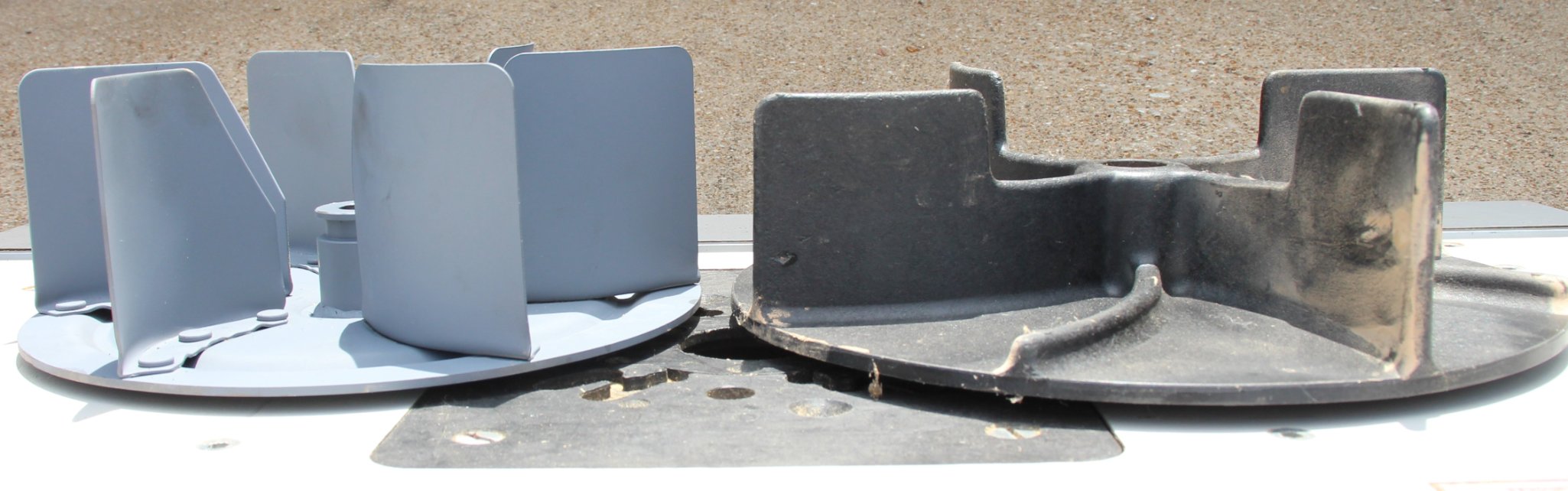

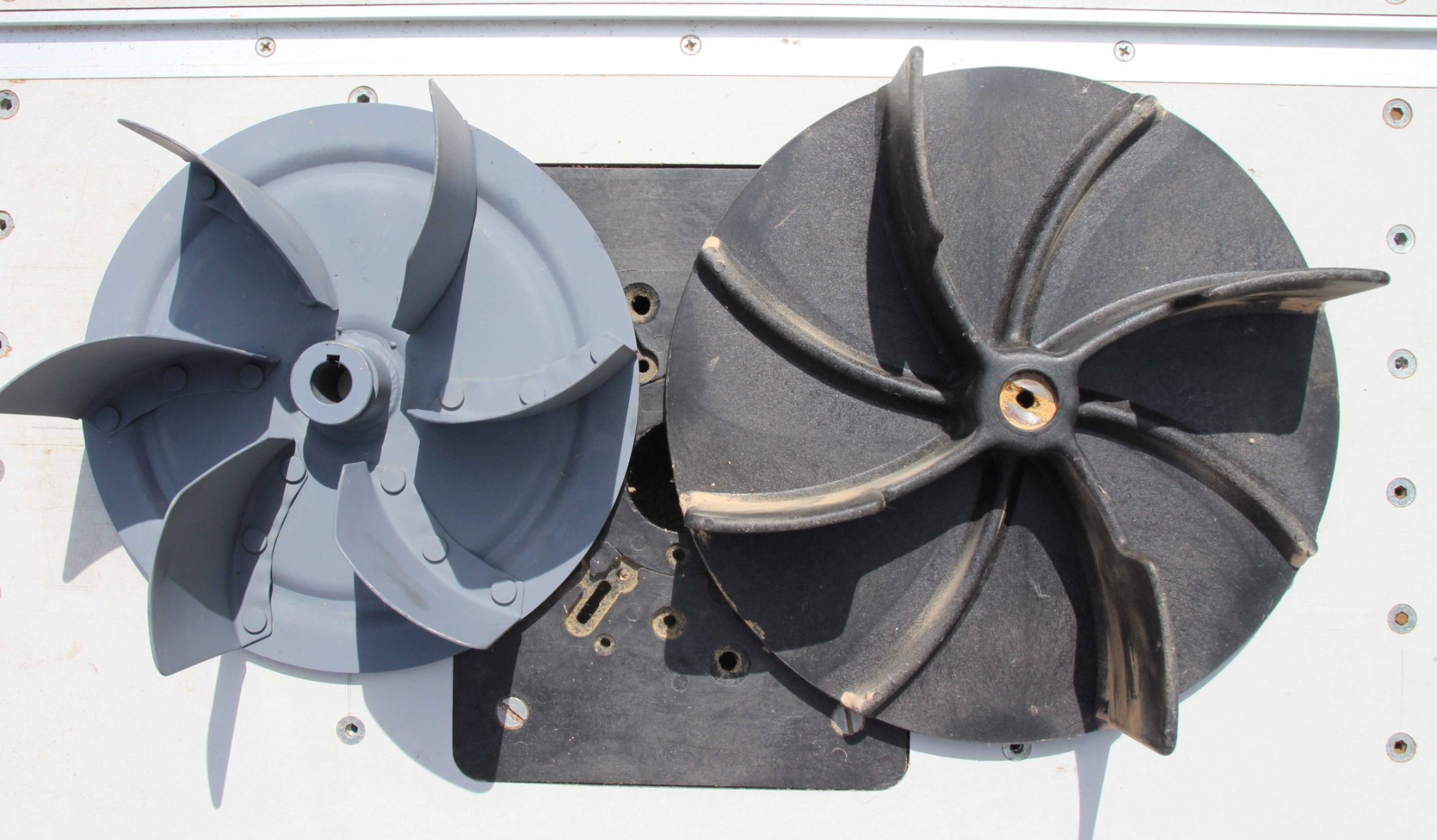

Here are new/old fan/impeller comparison photos. Noticeable changes include material, construction, diameter, height, direction of rotation, blade shape, and number of blades. I didn't mention it on the motor, but shaft diameter and key size are slightly different (metric Vs. SAE) between new and old. In both photos, the new one is on the left.

I have taken to calling these fan/impellers because the DC-3300 version is called an impeller and the DC-6000 version a fan. To me, they are both impellers. Perhaps there is some nuance in the definitions.(?)
Neither the DC-6000 fan/impeller nor motor have any indication as to who made them. I found that surprising on the motor (which does say made in China, but does not identify the manufacturer).
