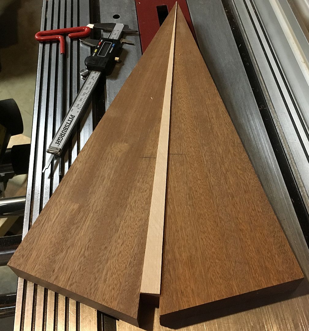

How would you go about doweling these three pieces (parts of future canoe deck) together using the Shopsmith?
I am thinking in vertical drill press mode, pieces on edge, table tilted to counteract the slope. The miter gauge locked in place with an extension to serve as the fence.
Open to other suggestions.
shipwright
Posts: 1165
Re: A Slow Boat To Nowhere
Post by shipwright »
With epoxy the dowels would be just for looks ...... and you can't see them. :-)
Put them together with a masking tape hinge, open, add thickened epoxy and close.
That's it ........ that's it!
(You can squeeze it a little with a rubber band or bungee to reduce the glue line if you want)
algale
Posts: 4841
Post by algale »
shipwright wrote:With epoxy the dowels would be just for looks ...... and you can't see them. :-)
Thanks as usual, Paul!!!! Just saved me quite a headache.
