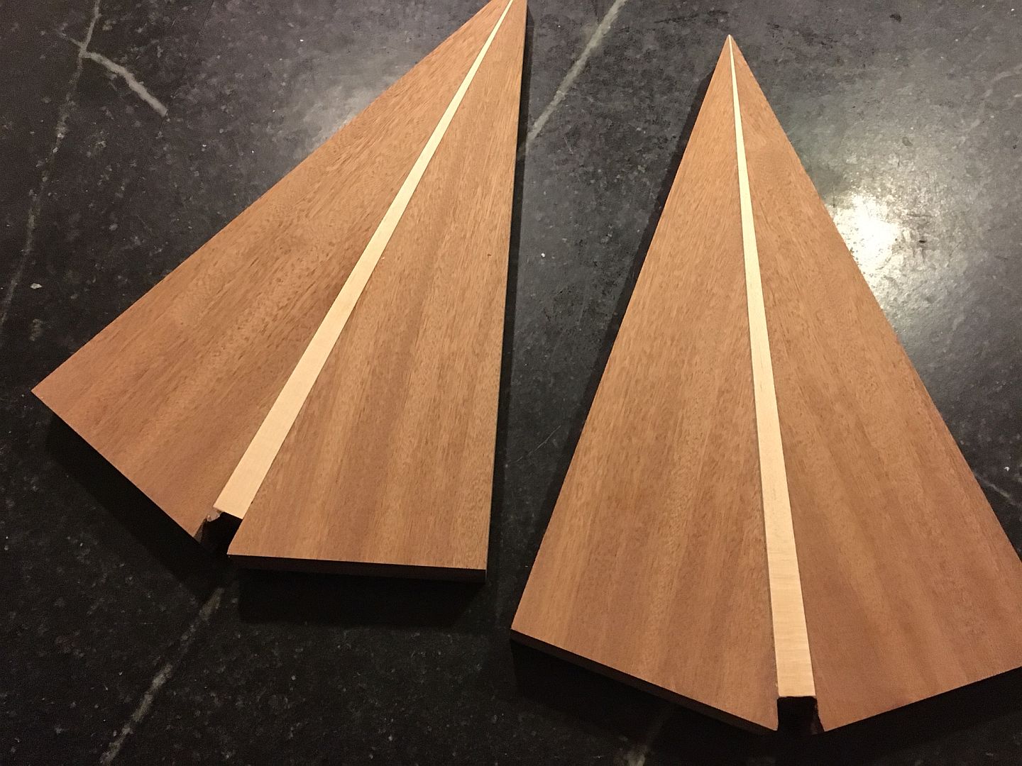

algale wrote:
shipwright wrote:With epoxy the dowels would be just for looks ...... and you can't see them. :-)
Put them together with a masking tape hinge, open, add thickened epoxy and close.
That's it ........ that's it!
(You can squeeze it a little with a rubber band or bungee to reduce the glue line if you want)
Thanks as usual, Paul!!!! Just saved me quite a headache.
Headache indeed! Compound angles (I think?). And opposite on opposite sides of the center piece.

How about using the horizontal boring, rather than trying to keep the board vertical on it's edge?
algale
Posts: 4841
Re: A Slow Boat To Nowhere
Post by algale »
beeg wrote:How about using the horizontal boring, rather than trying to keep the board vertical on it's edge?
I think that would be the way to do it, but I'd have had to figure out a way to shim it so the doweled edge was parallel to the rip fence/at a right angle to the against the fence to keep the doweled edge at a right angle to the spindle.
Anyway, with Shipwright's blessing, I glued them up with thickened epoxy only -- no dowels necessary.
beeg
Posts: 4790
Location: St. Louis,Mo.
Post by beeg »
algale wrote: but I'd have had to figure out a way to shim it so the doweled edge was parallel to the rip fence/at a right angle to the against the fence to keep the doweled edge at a right angle to the spindle.
Use the scrap cutoff from the angle cut, on the back straight edge.
Use the other side.
Posted for 'future' reference. ;)
Now about that center 'wedge'. . .

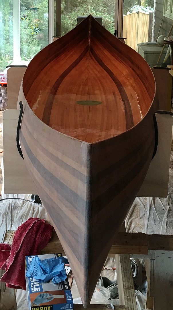

First coat of interior varnish. The book said to wait until all the trim (gunwales, decks and seats) were installed but that seems crazy in as much as it would just get in the way. So, now I sand this coat out and apply another.
Tip to future canoe builders: you do more sanding than anything else.
On the interior there are three or four randomly spaced dime-sized spots where (despite wetting out the fabric completely with epoxy and it being adhered to the substrate) the fabric is white. I suspect the sizing on those areas was damaged. I don't believe it will make anything other than a cosmetic difference and since the canoe is far from perfect, I'll just live with them.

Deck blanks glued up (thanks Shipwright). The Shopsmith belt sander came in handy to level them and clean off the epoxy. Then a quick random orbit sanding.
