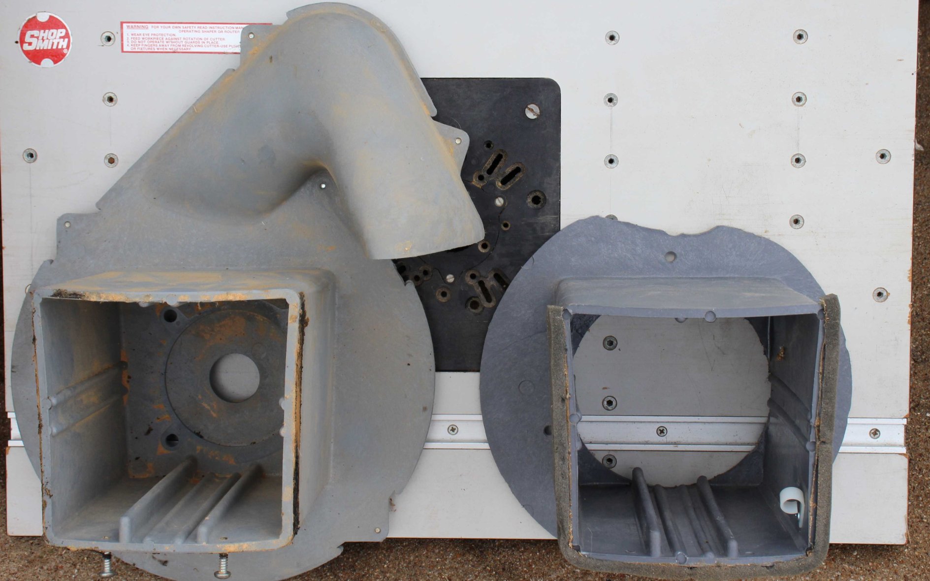

I believe the reason that the new motor housing reflects so much post-fab machining and the reason that mine and ssuel's have a different shape occurred to me this morning. It is clear to me, a near-certainty, that the new motor housing is hand made from a DC-3300 motor housing:
Motor Housings 1 (2).JPG (252.78 KiB) Viewed 1619 times
Motor Housings 2 (2).JPG (439.77 KiB) Viewed 1619 times
Essentially the DC-3300 fan housing and motor mating surfaces are cut away. The strange dip I noted at the top of both mine and ssuel's is where part of the air duct is cut away. And in my case these changes were poorly executed. The mating surface on mine came into contact with the cutting tool during this operation and was seriously damaged.
Problem, IMO: I don't see how this can really seal on a "good" one either. There is differential air pressure between the large volume of the housing / hood / collection bag and the motor housing. It might be a fair seal, but I use a 1 micron hood for a reason. Once the stuff has been collected, I want it to stay collected.
- David
RFGuy
Posts: 3101
Location: a suburb of PHX, AZ
Re: New Shopsmith DC-6000 Dust Collector
Post by RFGuy »
Wow....I had assumed, erroneously I guess, that these were all new P/N's. I am really surprised if they are re-working existing housings and/or manufacturing new ones that they are then cutting down like this. Glad I didn't purchase one of these "upgrades".

dusty wrote: Thu Aug 19, 2021 9:13 pm ...What I am unable to envision is how saw dust from the bag gets up to the exhaust port. Is the back side of the motor housing (where the motor mounts) not a closed chamber?
Unlike the DC-3300, on the DC-6000 the motor mounts to the fan housing not the motor housing. The DC-6000 motor housing has both ends open. One end then becomes closed (-ish, IMO) when it mates to the fan housing. (See pics above, the DC-6000 motor housing is the darker gray.) That is where I think mine leaks, the 'flat' mating surface between it and the fan housing. I don't think it leaks around the motor mount because it has a rubber gasket/seal there, and the pressure differential is the other direction. I think the foam rubber "short seal" just above that grate on the inside is also possible. If/when I put it back together I'll seal one of these to isolate.
Note - when I removed the motor housing there was quite a bit of sawdust trapped between it and the fan housing in that flat mating surface. I did not remove the motor, just slid the motor housing off. I think this tends to support my theory that there was airflow between the surfaces.

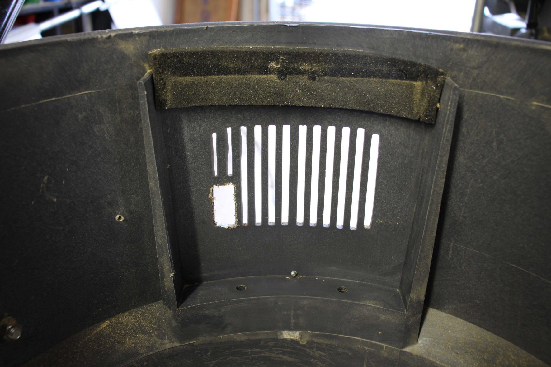

DLB
Posts: 2294
Location: Joshua Texas
Post by DLB »
Trimming the protruding screw flush reduced the gap between the top of the motor housing and the main housing from a ridiculous ~5/16" to a disappointing ~7/32". Looking down through the top gap I can see that the gap at the bottom is now closed. This was not a surprise, I knew the screw did not protrude far enough to be solely responsible.
