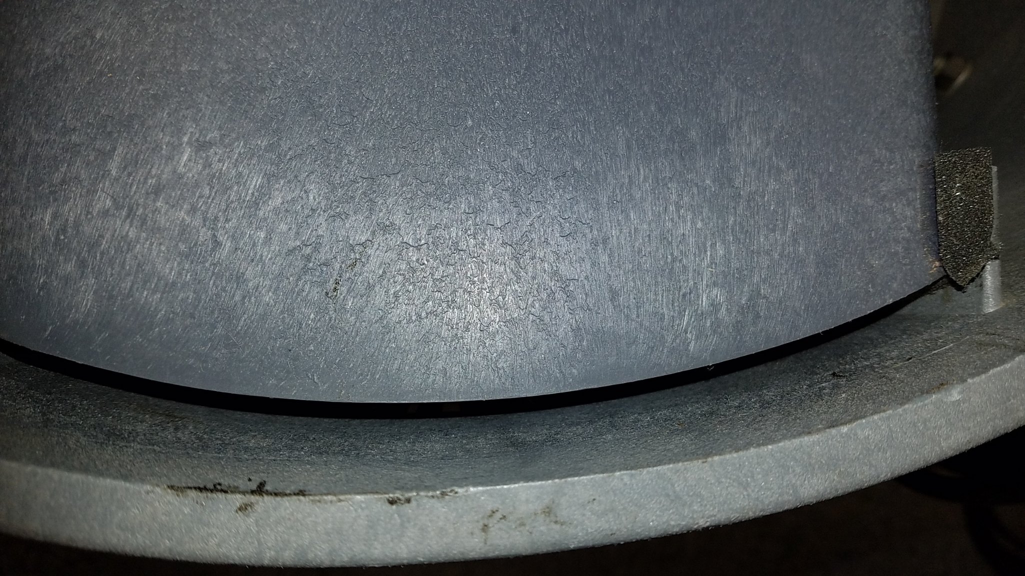

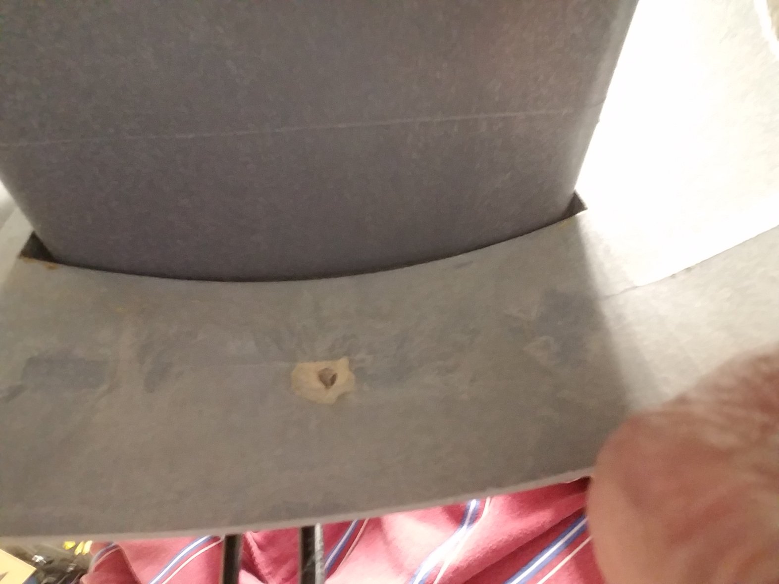

I opened mine back up this morning and I now seriously suspect that I have air leaks as bad as yours.
I am unable to close a gap between the Motor Housing and the inside will the the dust collector. I am thinking that this gap is the result of improper assembly as much as inadequate sealing.
I also wonder if it would not be better if the 4" union was installed after the DC is set in place. Doing this would allow the union to be installed into and remain in the opening.
Top of Motor Housing (foam seal removed)
The 4" union meets the DC wall.  Should it protrude out into the manifold area?
Bottom side of Motor Housing.

dusty wrote: Tue Aug 24, 2021 3:43 pm Do you know what the screw is for. I suspect it might be the spring steel clip that holds the dust collection bag. I have the clips but no screws that protrude into the inside.
Yes, for the clips on mine.
There ought to be a "Short Seal" in that gap. Foam rubber with an adhesive surface.(?) It's not present in your pic. Do you have that?
Yeah, it's not a great fit. I'm kind of ignoring this part for now, plan to seal it up when I believe I'm putting the thing together for the last time. I think this is leaking back into the input, maybe losing some CFM but not losing dust back into the shop on mine.
- David
