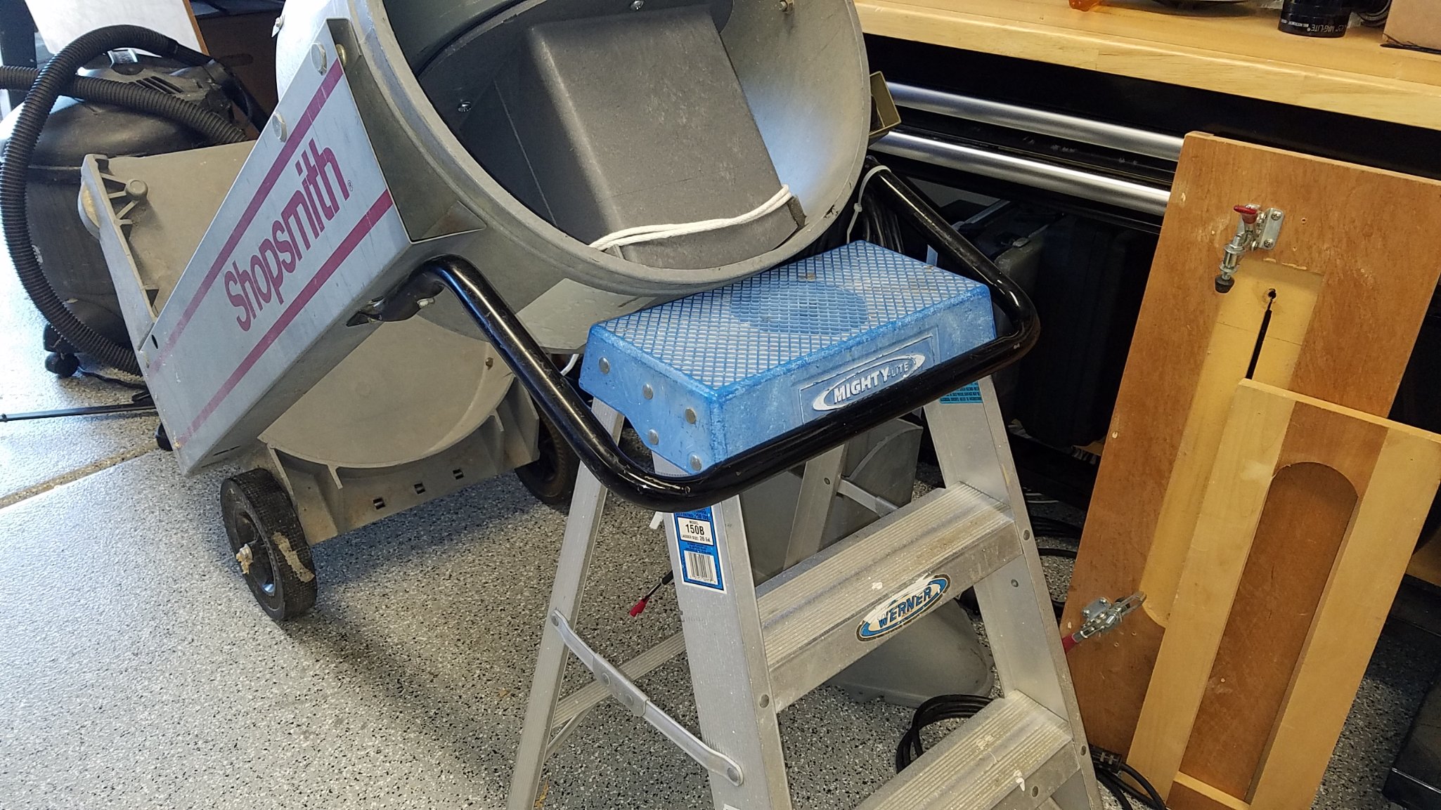

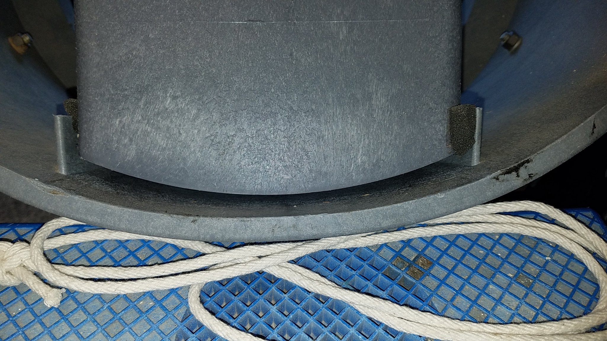

Re: New Shopsmith DC-6000 Dust Collector
Dusty, If you want to evaluate leaking between the motor and fan housings it's pretty simple. I'd place the Motor/Fan assembly with the inlet down between the rails of a Mark V. Remove the four large sheet metal screws from the motor housing. Mind the wires, and simply lift the motor housing off. The motor will remain attached. If there is any sawdust there that was trapped between the housings I think that suggests an air leak. If you do this I'd really like to know if there is any sort of gasket or seal between the housings on yours, and the condition of the face of your motor housing. (See my pics above, mine showed evidence of damage from machining ops.) I currently believe this is the primary leak on mine.dusty wrote: Tue Aug 24, 2021 5:36 pm I have the "short seal" if it will reattach. If not that stuff is available in many different forms.
For the leak (gaping hole" across the top of the motor box, I going to trim some flashing to fit the contour and attach it with double sided rubber window/door tape. It works wonders around window casings - why not here. I am contemplating how I might use the same stuff all the way around the motor housing.

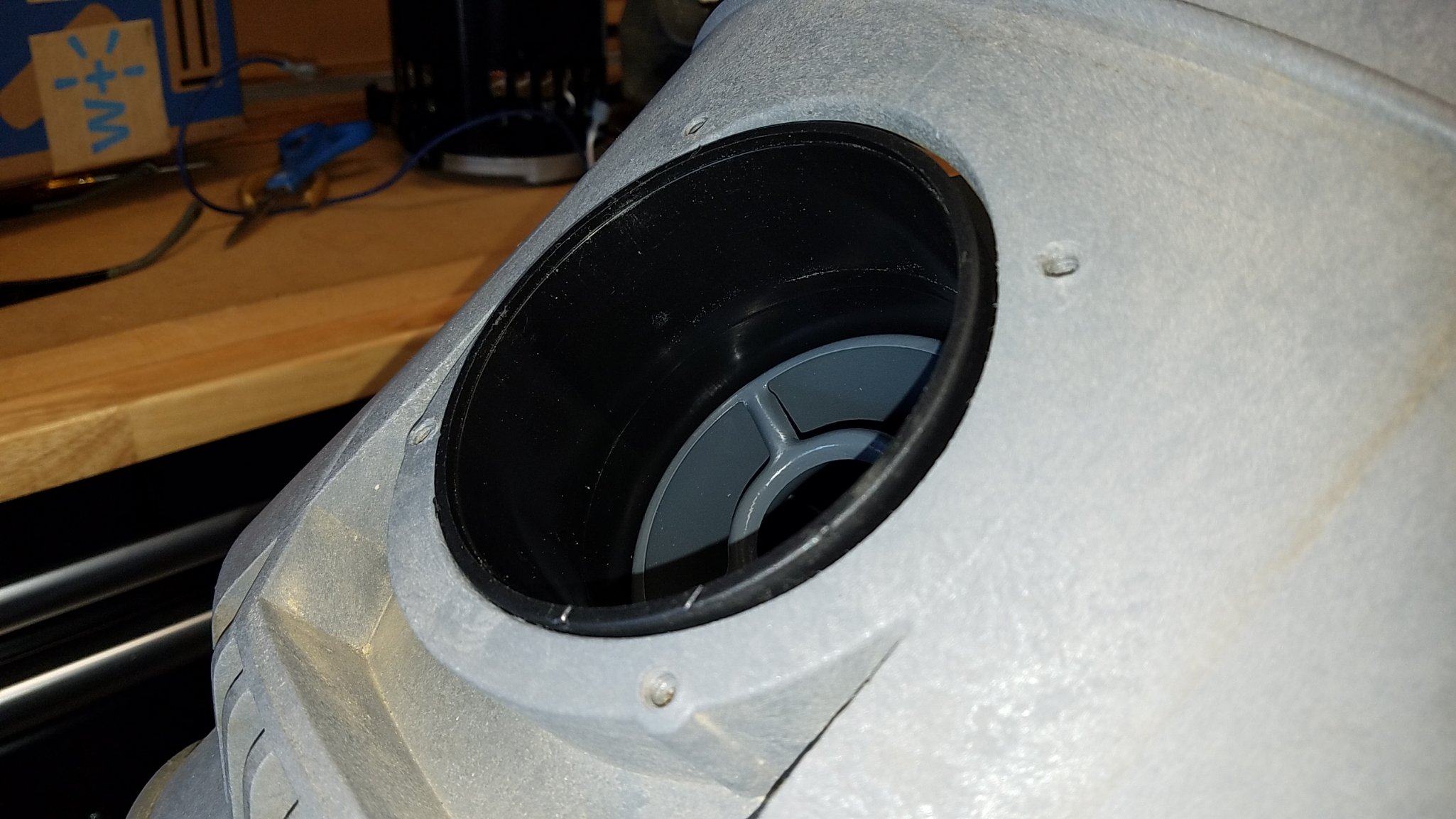

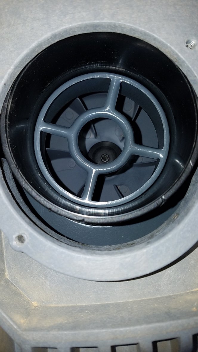

I have not made saw dust in significant quantity to have shown evidence of a leak there. I am surprised though to hear that there is no gasket .
I have gotten off that track momentarily. I am trying to understand the gap across the top of the motor housing. My current theory is that when the gap exists there has been an assembly error. Not an error that can be corrected by reassembly though.
I now suspect that the axis of the fan and motor do not properly align with the axis of the dust collector input by about 1/8". I can close the gap by repositioning the fan housing but when I do the 4" union becomes misaligned. My purpose today will be to substantiate that claim or to disprove it.
Note that not all of the gaskets are installed and the union is installed backwards so that it could mate with the 3-way input (the manifold). I did not want to remove the foam.
- Union is properly aligned but gap is open
- 20210825_075327.jpg (281.18 KiB) Viewed 1200 times
- Gap is open
- 20210825_075654.jpg (601.49 KiB) Viewed 1200 times
- Gap is closed but union is improperly aligned
- 20210825_074928.jpg (116.74 KiB) Viewed 1197 times
- Gap is closed
- 20210825_075040.jpg (533.91 KiB) Viewed 1196 times
