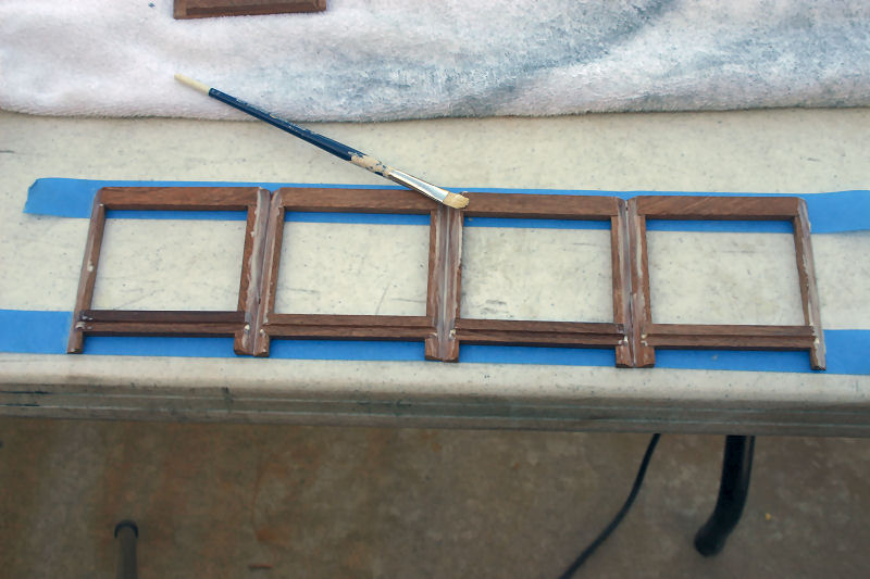

Here's some pics of where I left off. Did my glue up using blue masking tape to hold the 4 sides together.
[ATTACH]8416[/ATTACH]

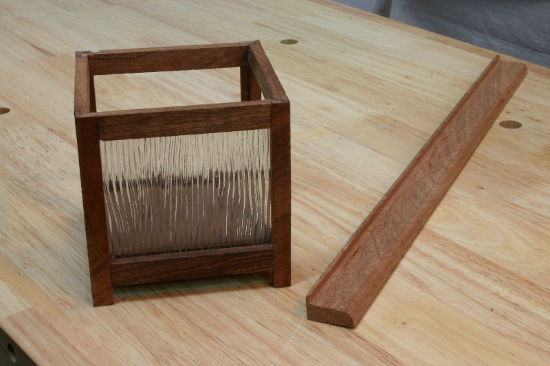

Here's the lantern with one piece of glass in it. She's topless at this point as you can see.
[ATTACH]8418[/ATTACH]
The glass takes up the entire width inside and is virtually the same width as the opening. The lantern is about 1/4" narrower than it should be due to over chamfering / oversanding the 45° edges each by about 1/8" so to get the glass to fit, I need to put a chamfer on the edge which I found is not an easy task to do with conventional sanding techniques. Glass doesn't sand very easily. You can see how the stiles (verticals) are narrower than the rails (horizontals).
A wise man would just scrap the prototype and go into final build but......I want to salvage it.
Gee, just writing about my problems gave me some motivation to work on them. Avoidance just doesn't get you anywhere!!

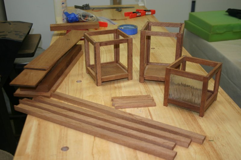

Home stretch. All that's needed is completing the tops, sanding, finishing, and glass installation. Should have that completed in a month or so.
Seriously, hopefully much sooner. Can't believe how pathetically slow I've been. Having to think too much. Worried about making a mistake and making scrap....then charlese's point about buying extra B.F. will become a reality.

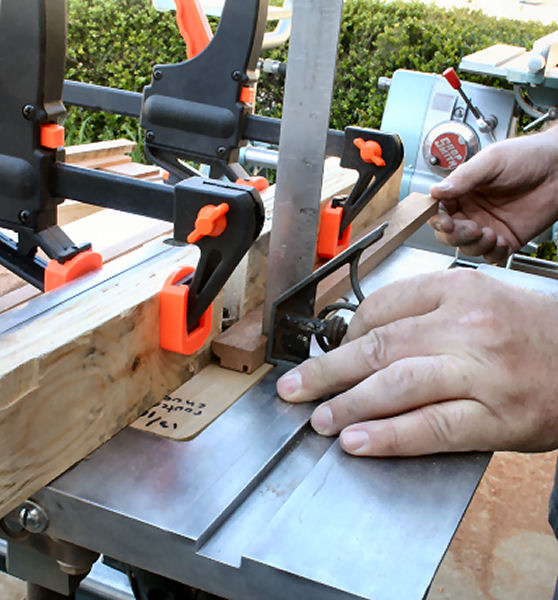

.[ATTACH]8721[/ATTACH]
What a charm it was using my recently acquired Pro Planner to plane the stiles vs. hand planing them. I just didn't have the skill to get them real uniform by hand. Pro Planer hit .250" on the nose.
