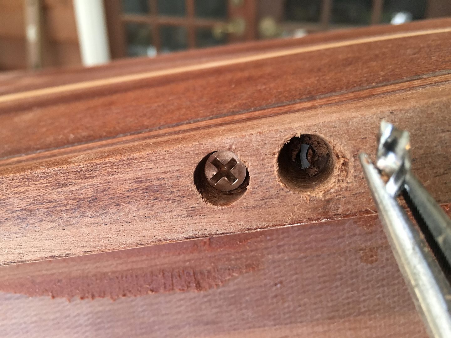

What size was the drill bit? How about chipping out SOME wood around the bit, then grab the stub with a needle nose pliers to twist it out?
Re: A Slow Boat To Nowhere
Thanks everyone. The bit was a WL Fuller general purpose # 8 tapered bit (set up for use with one of their countersinks). According to this chart http://wlfuller.com/html/taper_point_drills.html, it was 11/64th (presumably at its thickest).

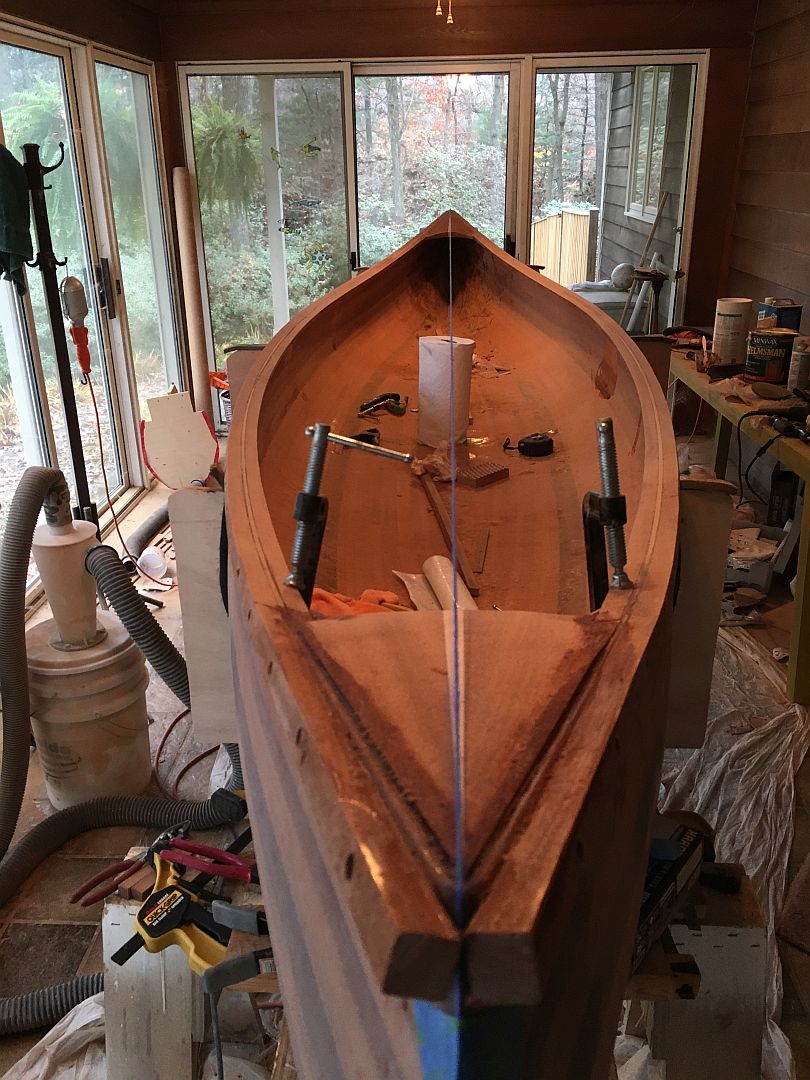

Well, it wasn't 100% bad news today. While I wait for the epoxy to dry on the second deck so I can shape it and the gunwales, I set up a line to see if the maple stripes on the decks lined up, and they come pretty close.

Long tension pin with id > bit od.
Grind teeth on one end(use thin cutoff wheel).
Looks like Ed's suggestion.

You could chip away enough wood to expose the end of the bit use it as a locating pin to drill out the material around it with the counter boring part of the original countersink drill assembly. .... if it is the countersink that I'm thinking of. Then, after removing the broken bit, you already have the plug to fit the hole.
Thanks again, everyone. Even if I have ignored some of the perfectly good advice I have received on the Forum during this build, I have appreciated all the helpful advice and supportive comments each of you has offered.
Now, if I didn't already have the countersink/counterbore and matching plug cutter for this bit, I'd be inclined to go with Ed's or JPG's tools -- but I had been thinking along the line of Paul's idea already and will give it a try.

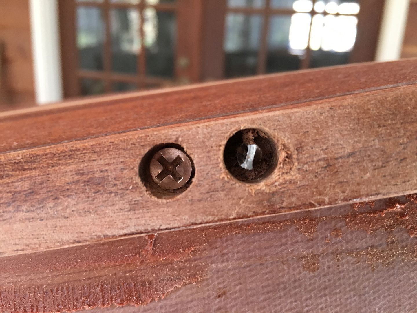

Success! I started with a box knife to expose the end of the drill bit. Then I took the countersink/counterbore and twisted it by hand until there was enough wood removed that the counterbore was "seated" on the drill bit. Then back into the drill to make the counterbore. This exposed the drill bit enough to put the needle-nose pliers on it.
Unfortunately, I wasn't able to get all the drill bit out because it snapped deep within the counter bore.
But now I should be able to cut a sapele plug with the matching plug cutter and cover it.
Thanks, everyone!
