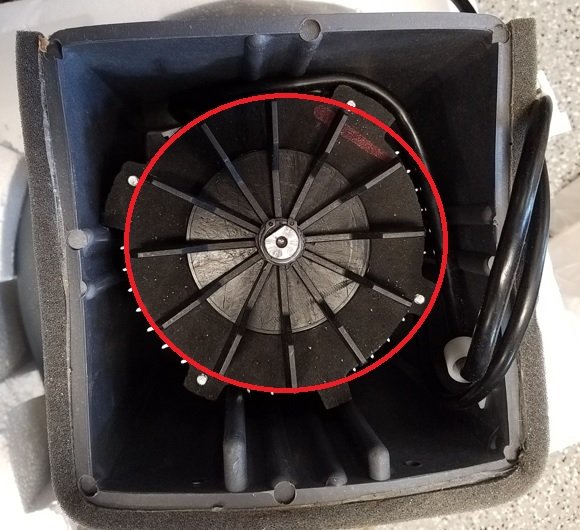

Is it being suggested that cooling air is being drawn from the fan side of the fan housing into the motor housing. I have been under the impression that the area between the fan housing and the motor was sealed. Am I wrong? Is there a free flow of air into the motor housing from the fan housing?
Is there a cooling fan on/in the back side of the DC-6000 motor?
Please clarify. Are you asking if there is a second fan, besides the one that's exposed? Or did you mean DC-3300?

DLB wrote: Sat Aug 28, 2021 8:13 am
dusty wrote: Sat Aug 28, 2021 5:13 am
-David
Isn't Dusty talking about this fan?
