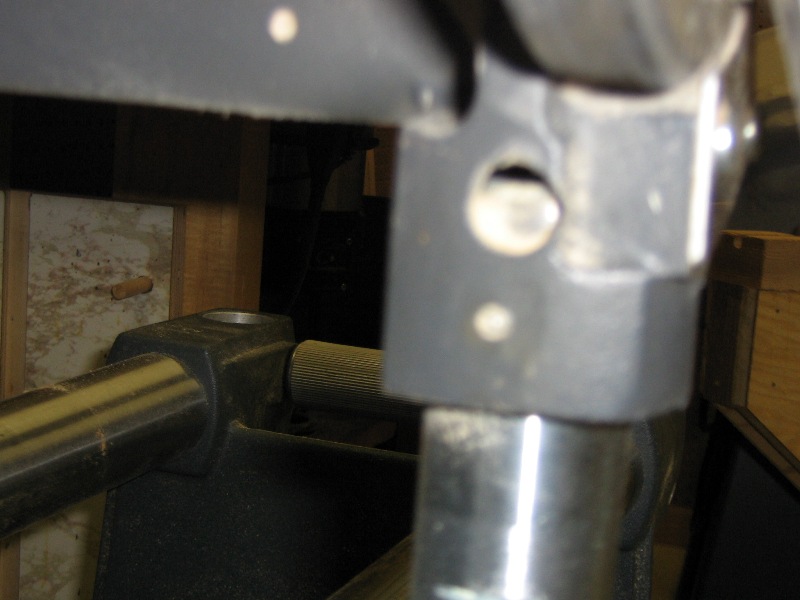

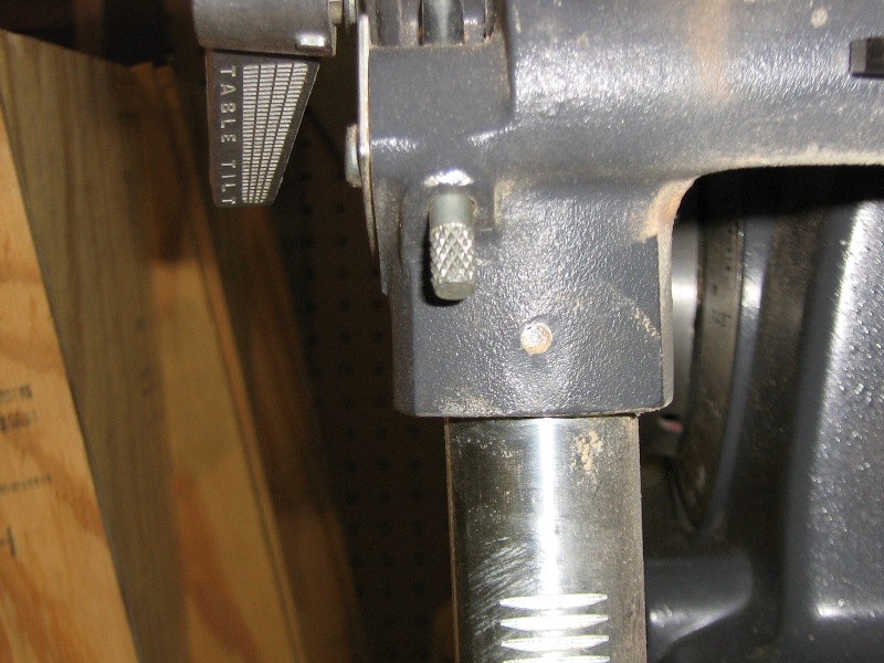

Could you post a picture of the pins that are discussed?

Here are the pictures of the two pins on the front post. There is one on each side. The rear post has the same thing. Just use a punch and hammer them through from the outside. They will fall out through the center of the post. Mine has the new posts with teeth on both sides.

stephen_a._draper wrote:Here are the pictures of the two pins on the front post. There is one on each side. The rear post has the same thing. Just use a punch and hammer them through from the outside. They will fall out through the center of the post. Mine has the new posts with teeth on both sides.
Thanks for the pictures!
