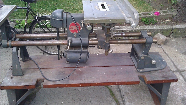

Just a heads up guys, that I am now the proud owner of a Shopsmith 10-er! Here's a picture of the thing when it first showed up; I've spent the day taking it apart and scrubbing/sanding away the rust. She's getting nice and silver again (I've still got a lot of work to do on that bench). The motor runs beautifully too!
My housemates and I need to clear out an extra storage room before it can be put to use, but I'm excited!
