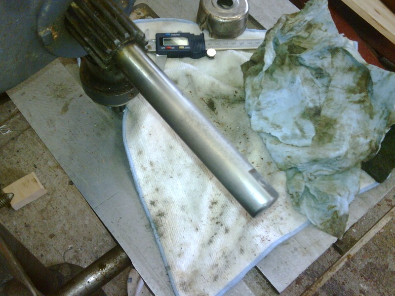

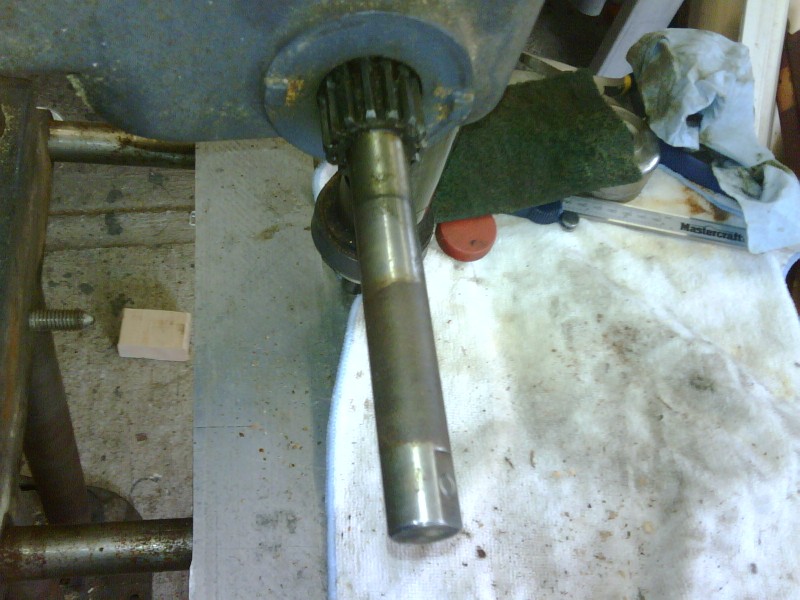

From the picture there appears to be only light surface rust on the tubes. On mine I "wet sanded" them using green Scotch brite pads dampened with Evapo-Rust, in a few spots where there was pitting I used sandpaper. I am pleased with the way they turned out.aldenw wrote: In terms of cleaning this bad boy up, are there any tips you've got? Steel wool and oil? That one on the website you linked to sure does look spick and span (though I don't need mine to look that nice)!
Here is a picture of my pinion shaft before
[ATTACH]17968[/ATTACH]
and after
[ATTACH]17969[/ATTACH]
using this process.
Then wipe them clean and wax them. Johnsons original Paste Wax (JPW) is preferred but unavailable in Canada so I used TreWax clear paste wax.[HTML][/HTML]
- Pinion shaft before.jpg (111.27 KiB) Viewed 2516 times
- Pinion shaft after.jpg (127.9 KiB) Viewed 2510 times
