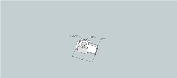

I'll try to describe the part (#86) in sufficient detail that you could have one milled. I will attach an attempt at a Sketchup drawing of the part. I am unable to make Sketchup do some of what I need to detail the parts dimensions.
The part is essentially a piece of round bar stock 3/8" in diameter and 3/4" long. There is a 7/32" hole drilled through the bar stock 1/4" from one end. That 3/32" hole is surrounded by a 3/8" counter bore that is .057" deep.
[ATTACH]18963[/ATTACH]
mrhart hold down (Custom).png (14.3 KiB) Viewed 4378 times

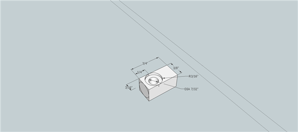

Another attempt to communicate the dimensions:
Hope this helps.[ATTACH]18964[/ATTACH]
