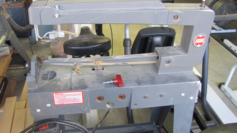

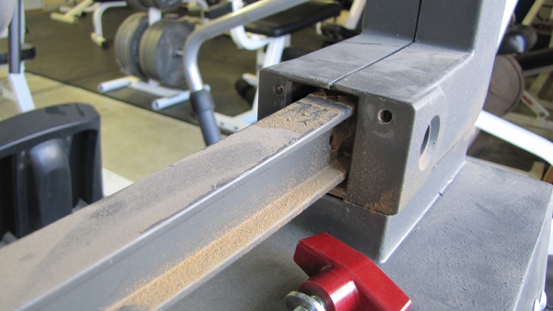

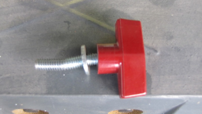

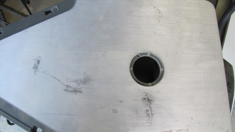

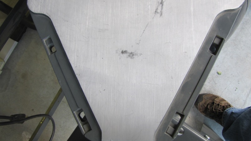

Sorry for the delay in getting pics.
I believe I'm missing part(s). I haven't found any source with an exploded view that I can see.
[ATTACH]18874[/ATTACH]
[ATTACH]18875[/ATTACH]
I know I need a replacement for this.
[ATTACH]18876[/ATTACH]
I can see I am missing the insert, there are more holes than screws (bigger as well) and what goes in the channels?
[ATTACH]18877[/ATTACH]
[ATTACH]18878[/ATTACH]

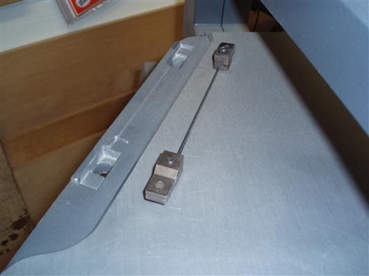

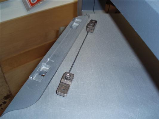

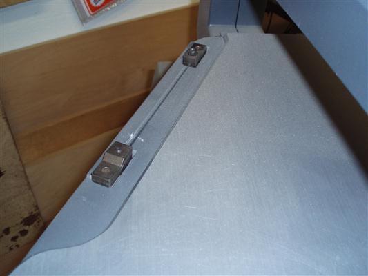

You do appear to be missing the rear cradle (part 87 in this diagram).
Regarding the table insert, there are a couple of holes to receive the spring clips that are mounted on the insert (similar to the aluminum bandsaw table).

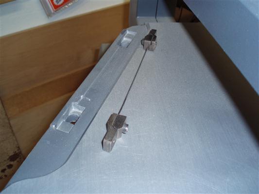

In the last picture, you can see the blade mounting jigs (one on each side of the back of the table). A blade mounting block goes in each hole and the blade is guided by the boss between the block holes.

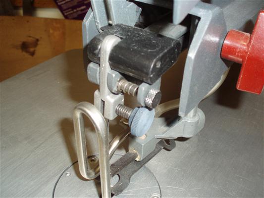

I have some pics but I don't know if they will help.
Here are the first ones.
[ATTACH]18882[/ATTACH]
[ATTACH]18883[/ATTACH]
[ATTACH]18885[/ATTACH]
[ATTACH]18886[/ATTACH]
[ATTACH]18887[/ATTACH]
