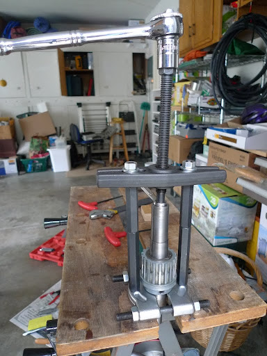

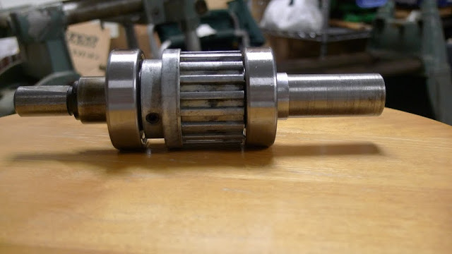

Gilmer Drive assembled
Post by cllib »
With the USA bearing made in China. The Gilmer drive is reassembled.
The quill bearing feels good so I don't intent to replace it. There is one question about the quill bearing. Why the old one has so thin inner race? So if I remove it by the Harbourfreight Tool, will it be " damaged ?
Regarding " 1) You have waaay too much room in yer 'garage'."
It's a illusion because I use wide angle lens, 24mm, my "wife's" two car garage looks big. I had to have her car outside to do my restration. :D
55 SS Mark V restoration work in process
heathicus
Posts: 2648
Location: WhoDat Nation
Post by heathicus »
I can buy that it's an optical illusion. The boards on that Workmate look about 6ft long!
