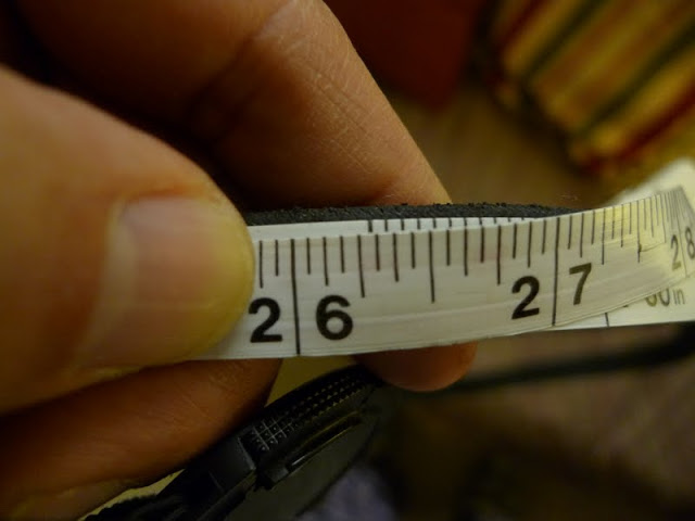

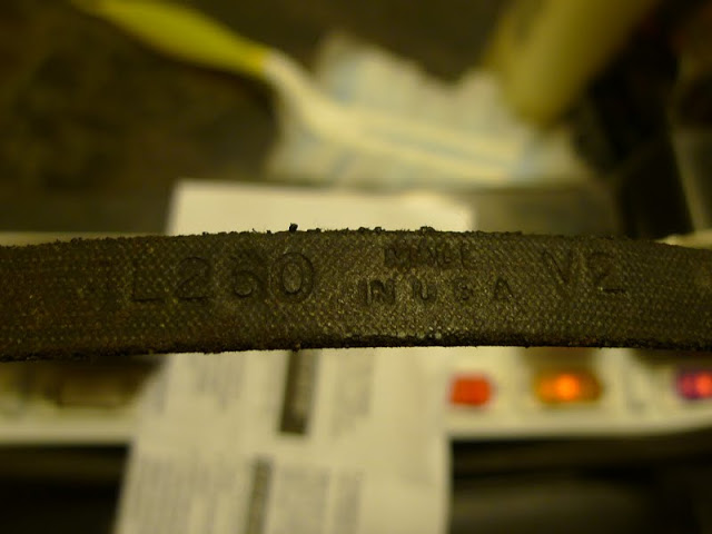

1. My belt is a "4L260", it outer width is 29/64", length is 26 1/4". Is it still good to keep? or buy a new one.
2. Is the "substitute" still not that good than the one from SS?
I've got my questions:

29/32 is a bit 'skinny', but not ready for the trash can.
The length will affect the speed range.
Belt 'length' is usually a 'mean' dimension, not an 'od' length.
IIWM, I would get a replacement from SS. I know of no direct replacement currently readily available. For a while SS had procurement problems, and tried an alternative belt with disastrous results.
OK to use the existing belt, but it will not allow the speed control to behave as its design intended.

I just re-measure the width. it's 28/64".
55 SS Mark V restoration work in process
It needs to be close to 9/16" wide. That is the major reason no 'after market' automotive belts are acceptable(that and the length). I am not recalling if it should be 25.5 or 26.5 in.cllib wrote:I just re-measure the width. it's 28/64".
Belt should also be 26.5. 4L265 , I'm running a 4L260 but not sure how many Rpm I'm losing.
