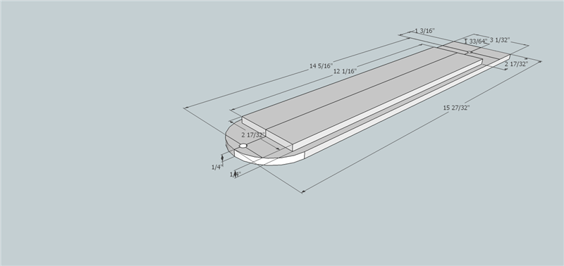

Based on my own limited exposure to only three different Mark V tables, I believe you will find that a 1/4" thick insert will be very, very close to perfectly flush with the table top.
As has been stated, if too thin, they can always be shimmed but why do that if you are making them. Make them thick enough to not need the shim. If too thick, you can either discard them (as has been suggested) or make them thinner.
I have had more trouble getting the holes in the right place than in getting them the right thickness. Now that I built my zci sled, I don't have that problem either.
[ATTACH]20012[/ATTACH]

dusty wrote:Based on my own limited exposure to only three different Mark V tables, I believe you will find that a 1/4" thick insert will be very, very close to perfectly flush with the table top.
So back to basics sir. I have'nt made one yet but I need to asap as I've had issues where I "should" have had one in.
Thickness of 1/4" will be fine.
I can trace the shape from the SS one.
Drill and countersink the holes.

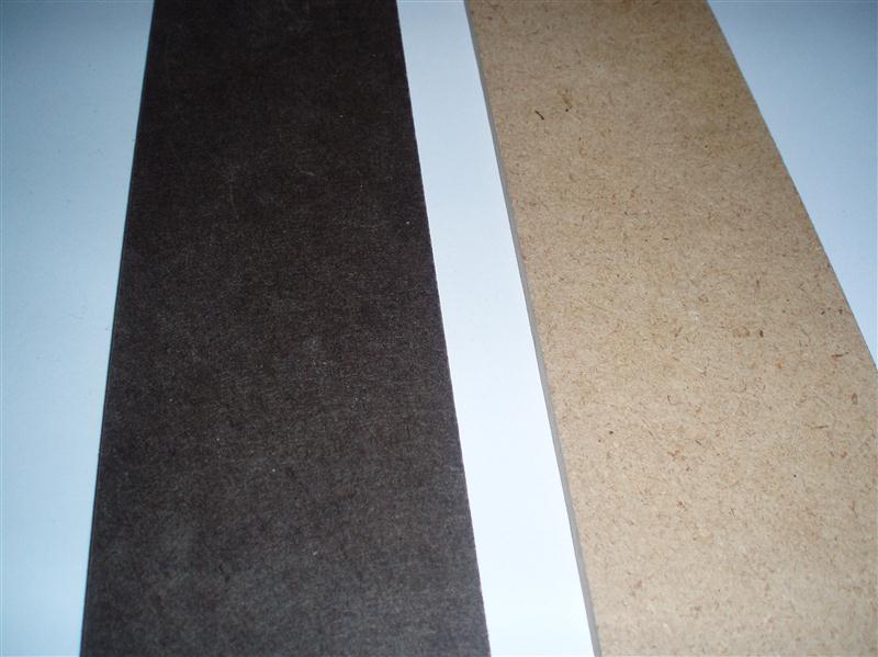

Everone mentions 1/4" hardboard, I haven't seen that in the stores. I ve seen some "hardboard" thats dark brown with a white laminate on one side, but it's not that thick. I bought some to make patterns with, works good but it's kinda soft and leaves fuzzy edges when you cut it.
Any pics of real hard board?

heathicus wrote:What is generally referred to as hardboard is labeled "Eucaboard" at my local Lowes.
I think 1/4" eucaboard measures 3/16". Not a big deal for most applications but not good for TS inserts (IMHO).
mrhart wrote:So back to basics sir. I have'nt made one yet but I need to asap as I've had issues where I "should" have had one in.
Neither of these are "real hardboard" (used to be called masonite and was waffled on one side while slick on the other).
The darker one is actually a 3 layer laminate and is .004" thinner than I would like. The other is 1/4" thick but is not as stiff as I would like.
[ATTACH]20034[/ATTACH]
The lighter colored one is what I have been using until recently. I have begun an evaluation, however, using real wood. What is in test right now are a couple made from cherry cutoffs that I planed to a precise 1/2" and routed to fit snugly in the cut out.

dusty wrote:Neither of these are "real hardboard" (used to be called masonite and was waffled on one side while slick on the other).
The one on the right the lighter one looks like 1/4 MDF to me.

I thought I found the stuff at the Home Depot web site. They list 2' x 4' panels of tempered hardboard that is 1/4" thick, but the fine print in the product description says it's actually 3/16" thick.
I have a ZCI made of laminate flooring that is about 8mm thick for my Model 500, but I haven't gotten around to routing around the edges so it's even with the surface of the table. I also made a round one for the bandsaw, but that too needs routing.
