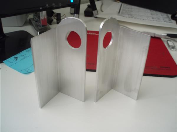

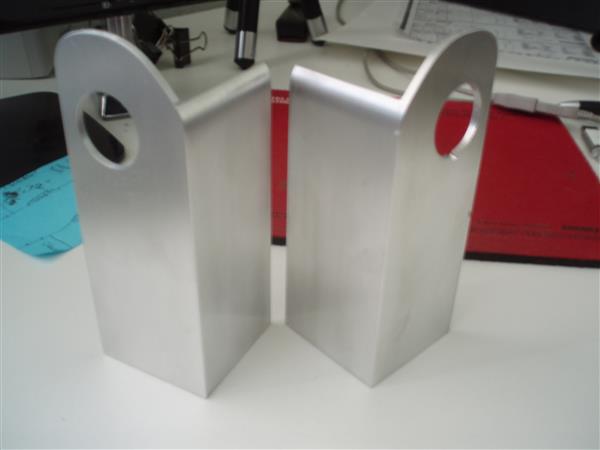

wasatch wrote:Here is a picture of one of them. I still have to scotchbrite and paint them.
I saw these brackets and decided to make a slightly different version for use on my upcoming infeed table.
They are smaller and require less work to complete.
The only functional difference is that they must be used with a support bar]20700[/ATTACH], [ATTACH]20701[/ATTACH]
They are not finished. I need to drill holes for the screws that mount them to the table.

I used Dusty's idea of trying everything upside down on a table to try out the range of motion of my outboard OFT support mechanism(good idea). I've tried three different combinations of brackets on the outboard side and there is always table droop when going from flat to angled but I think I'm OK with that. The two brackets on the SS table side work great and it is my opinion that a slight table adjustment on the outboard side to go from a flat to angled table isn't much of a problem as it takes seconds to re-adjust and will require quite some time invested to engineer anything else, plus the costs and complexity involved in the finished bracket. I didn't want to use non-shopsmith pipe or devices, other than the new aluminum brackets to make this table function. You know how fast little bits and pieces add up with your shopsmith SPTs.

I don't want to show my OFT outboard bracket yet, I have some work to do on it. I drew and cut the table side brackets on a CNC machine. I am very happy with the OFT.

These particular ones were cut from what I believe was a 4' length. Lowe's and HD both carry it in stock. It normally is in a rack along with flat iron and threaded rod.camerio wrote:Where do you find aluminium angles like that ?
Thanks for the list of materials.
This thread is by far a very useful one by its quality in descriptions and pictures.
Thank you guys for sharing this.
Most interesting and that is what I like on this forum.
I don't know the specific department but it is not with lumber or plumbing.
These particular ones are 1/8" thick. It is 2" aluminum angle.camerio wrote:These aluminium angle how thick are they ?
Next time I go to town, I will check with the Home Depot (we do not have any Lowes' Store in Quebec city) I think the nearest one is in the Ottawa area.
I have checked the longer pieces for straightness with a precision straight edge and they are dead on. I have one piece that I keep in the shop for use as a fence. Sometimes, when I have the table tilted and need an extension for the rip fence (out onto the outfeed table), I clamp it in place. Works great for a quick solution.
