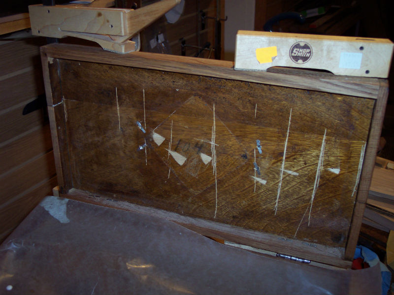

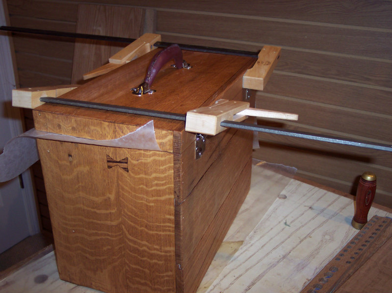

Exhibit B: I used the split-rivets to install the new chest Handle. All went fine until the last planned smack with the ball-peen hammer.... then the top of the chest split apart. That was the last factory glue joint that hadn't come apart on the carcass, until now!
[ATTACH]23420[/ATTACH]
I had little choice but to re-glue the thing as is. We'll see if that holds up. I did get a long bead of wood-glue in there, with a good uniform squeeze-out all along the crack. As you can see, the original wood panels are some really nice QS oak, one reason a rebuild of an old piece can look good.

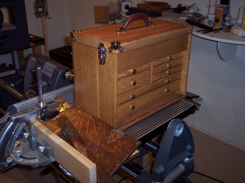

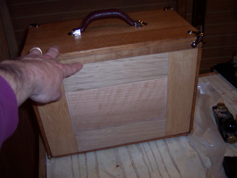

The top repair I think is going to hold up. Now I've added most of the new hardware. If you look very close at this design, you can see each edge of the chest has a slight chamfer in the middle, but sharp edges near the corners. This can look a little odd during the work, but it looks better when the metal corners are installed.
I still need to fabricate a good front-panel, with some post & socket arrangements to keep it in place when the top is latched. It will happen, when I get to it....
[ATTACH]23426[/ATTACH]

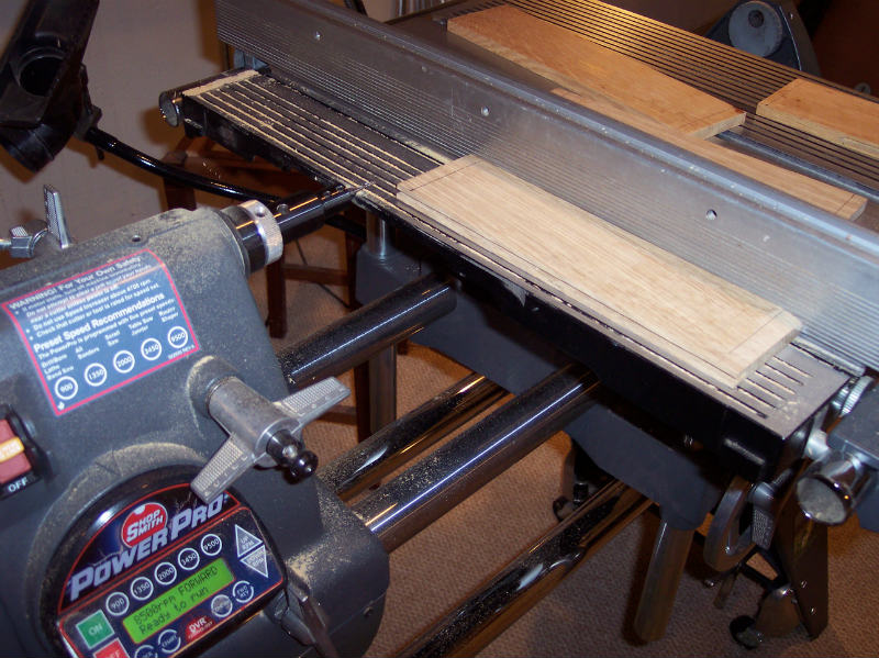

Here the 4 pieces intended for the frame (not yet at final size) are receiving some grooves:
[ATTACH]23459[/ATTACH]

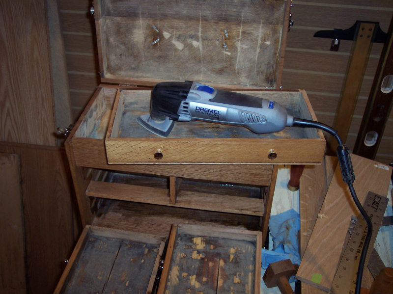

This I was not looking forward to. Sometime in the 20th century, drawer linings a lot like tar-paper were put in. I had to chisel most of it away. Then I got out the DremelGimmick which is actually not bad for this job. Some of the stuff, if I get it down to a uniform vellum-like texture, I'll call good enough. New felt will go over those parts.
Note also, solid-bottom drawers mostly have cracks in them due to cross-grain joints. I'm leaving those alone for the most part, no point in re-joining them. The more successful designs use composite or plywood or tin drawer-bottoms.

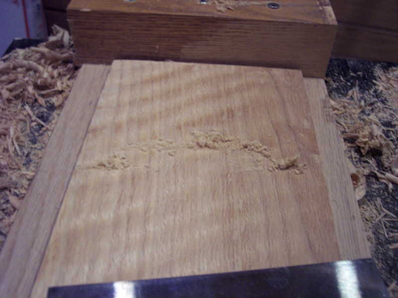

I was fortunate to see Nick Engler and Jim McCann teaching side-by-side that weekend. One excellent session was on hand-scrapers. They can do wonders, but it takes work to sharpen them. Nick espoused a sytematic grind/hone/burnish-a-hook approach. But Jim McCann just hits his scraper with a mill-file and moves on. For a few years I tried doing it Nick's way, but I realized after reading another forum just lately that I'd probably been creating too large of a burr "hook," which was subsequently too fragile. So I tried the Jim McCann method and I got a smaller incidental hook, but it does the job quite well. Here's some nice miniature shavings which accompany the smoothing of the recently-resawn oak panel:
[attach]23659[/attach]

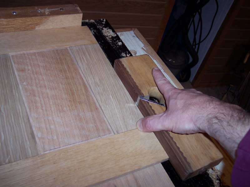

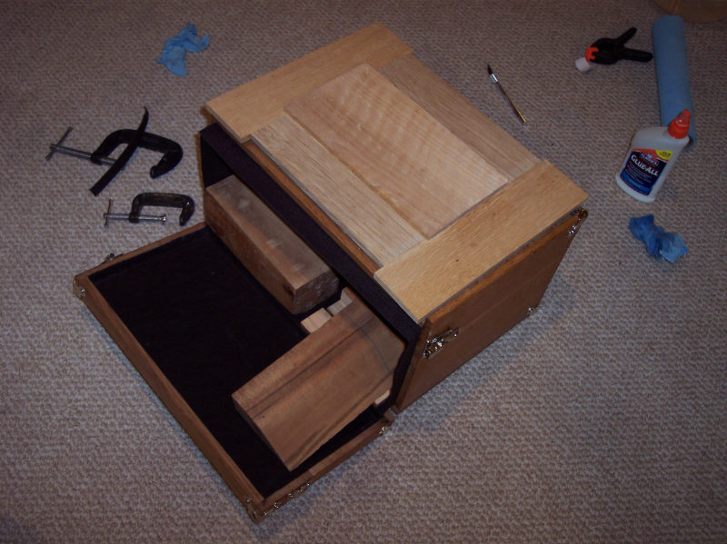

I cut a rabbet on the new front-panel on the OPR table. Then, upon test-fitting, I saw that the bottom of the chest-carcass has a "bow". So I manually trimmed up the rabbet to more or less conform to that bow:
[attach]23693[/attach]
Upon further trims, I'm pretty happy, EXCEPT I cut the rabbet on the wrong face, so for all time the wrong face is exposed. I sort of liked the opposite face better in terms of grain directions, OOPS. Oh well, there are enough waves and lines that I guess I could argue for either way....
