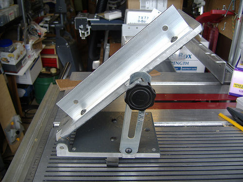

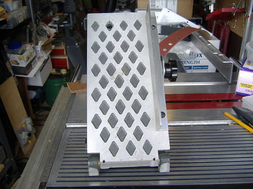

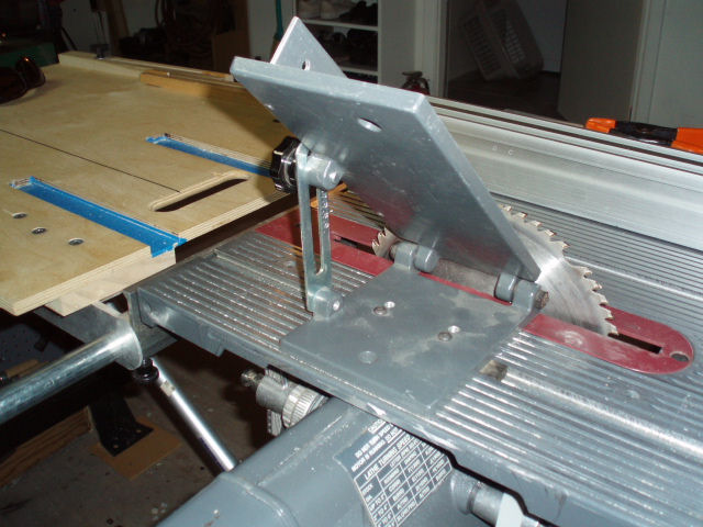

Might this be the beast?
[ATTACH]22942[/ATTACH]
[ATTACH]22943[/ATTACH]
[ATTACH]22944[/ATTACH]
These photos from my SS pics collection no doubt snagged off this forum awhile ago.:)
bevel gauge P4290007.JPG (73.61 KiB) Viewed 4676 times
Peter
prmindartmouth wrote:Might this be the beast?
What you have pictured here is the Bevel Miter Gauge (555461). I believe that it was initially offered as an accessory to be used with the Joint-Matic
Yep! That's it!;)
