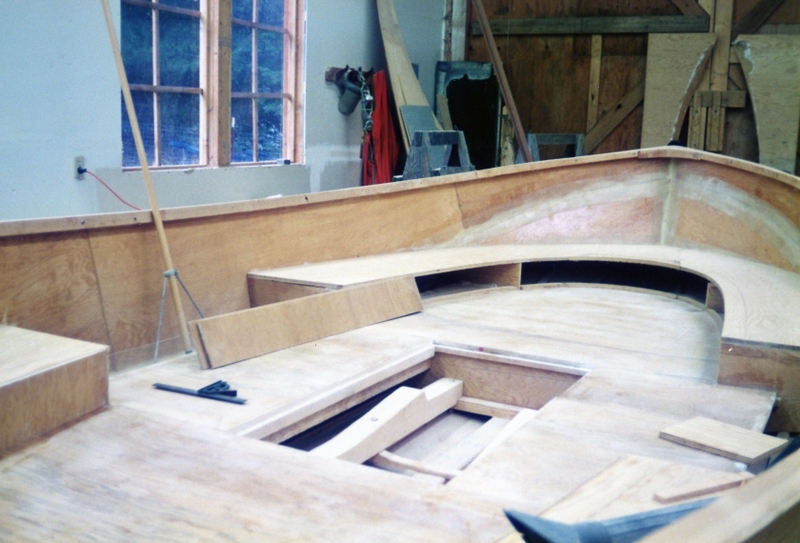

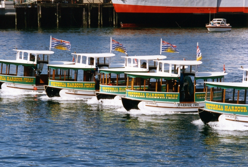

Then so would this. I built 16 of these and none of them has a stem. Epoxy is grand stuff!!
[ATTACH]23153[/ATTACH]
[ATTACH]23154[/ATTACH]
Paul M

Those are great! How long were/are they?shipwright wrote:Then so would this. I built 16 of these and none of them has a stem. Epoxy is grand stuff!!
Paul M

The Harbour Ferries are 20 feet and carry 12 passengers.
There's a project post on them here and a build blog is attached in the post.
