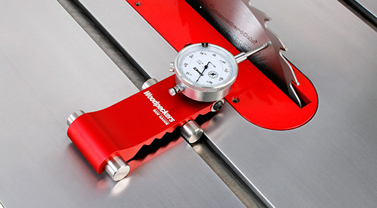

I do not know what to thing about these reading. .005 difference between the
A-line-it and the PeckerWood unit.
Wow: Which one is correct, the A-line-it has a +- 5 inch reference to the slot the PeckerWood has only a +- 2 inch to the inside lower side groves of the slot.
From a non engineering view the longer reference would seam to give the true results but I can see this is going to take heck of lot more study.

You bought both dial indicators??? Well, serves you right then! I looked up the Woodpecker and without owning one I would be concerned about using it on the Shopsmith 510/520 tables which have grooves in them because the outboard support of the woodpecker gauge might ride partly in and and out of a groove and either force the body of the gauge to not register securely on the piece riding in the miter slot or your dial indicator might register off of the groove rather than the miter slot. Looks like it would work well on a solid table.onevw wrote:OK
I checked the slot to the blade with the a-line-it on found it out about .002
I then checked the same slot and blade with the Woodpecker unit and found it out about .008
Wow
Rick
[ATTACH]23892[/ATTACH]
Al
- main_saw_gauge.jpg (60.18 KiB) Viewed 2830 times
