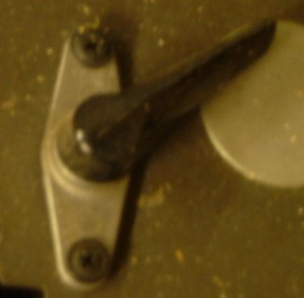

db5
If you sent me a PM about the lever to disengage the headstock from the rack, I didn't get it. You can contact me at chknspit@cox.net. I could sure use the lever!!

dgreen810 wrote:db5
After my cute response to you about "Okies" it wouldn't blame you for not sending me an email. :)
DG
Been busy, got sidetracked with other stuff and never took the picture but I'll make an effort to do that manana (that's Mexican for "whenever" but sometime.

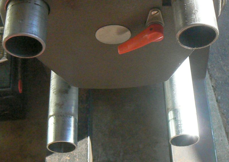

db5
The lever I am interested in is attached. Borrowed a pic from JPG's disassembly of a Mark VII.
[ATTACH]24702[/ATTACH]
Dg
Disengage Lever.jpg (81.25 KiB) Viewed 2938 times
FWIW, that is a lever knob that was prevalent in that time frame. Perhaps a look into electronics suppliers will reveal one????
db5
Posts: 1192
Location: Oklahoma City
Post by db5 »
[ATTACH]24707[/ATTACH]
dgreen810 wrote:db5
The lever I am interested in is attached. Borrowed a pic from JPG's disassembly of a Mark VIIDg
I will send that to you. Your address?
