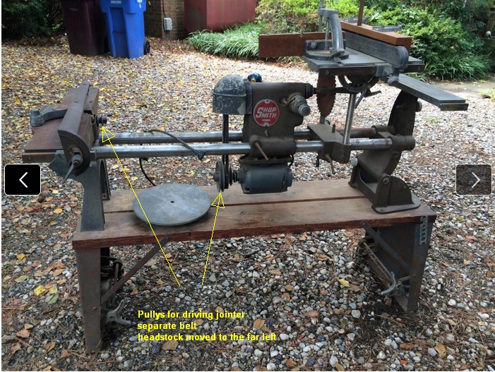

heathicus wrote:That's a nice machine. It will take some work, but should clean up nicely. You've got the jointer and jointer headrest which is kind of rare. And the miter bar that lets the Mark 5 miter gauge and hold down be used on the 10ER. The 10E/10ER was made 1948 through 1953. The pulley with 1953 embossed on it is to drive the jointer and is separate from the 3-step pulley on the motor to drive the quill.
So how does that pulley configuration actually work? I'm not sure I follow what you mean.

Do you mean it attaches to the motor shaft? I've searched online and can't seem to find the jointer manual. Does anyone have access to that and could perhaps post a copy?

tnerbelbag wrote:So how does that pulley configuration actually work? I'm not sure I follow what you mean.
This document shows how it mounts Shopsmith 4-inch Jointer Mounting Kit Instructions
And this is the owners manual Magna 4" Jointer Owners Guide

Thanks, that is very helpful. The only thing I'm a little unsure of is the pulley that came with mine is probably 9 or 10" and has 1853 and 1953 embossed on it. Here is a link to a picture of it.http://i1007.photobucket.com/albums/af1 ... /Pully.jpg

I've never seen the jointer motor pulley first hand, but I don't think that is the original Shopsmith part. But if it works, it works!

heathicus wrote:I've never seen the jointer motor pulley first hand, but I don't think that is the original Shopsmith part. But if it works, it works!

I do not think the '1853' is a SS part.
[ATTACH]26155[/ATTACH]
10 er jointer pulleys.jpg (376.17 KiB) Viewed 5924 times

Good catch, JPG. I thought he had taken the pulley off and that was it in the linked to picture. But closer examination of the 10ER picture shows it's a different pulley.
