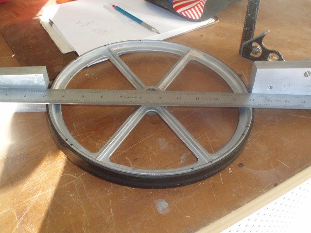

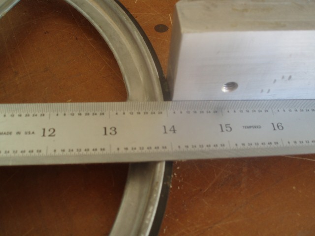

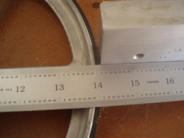

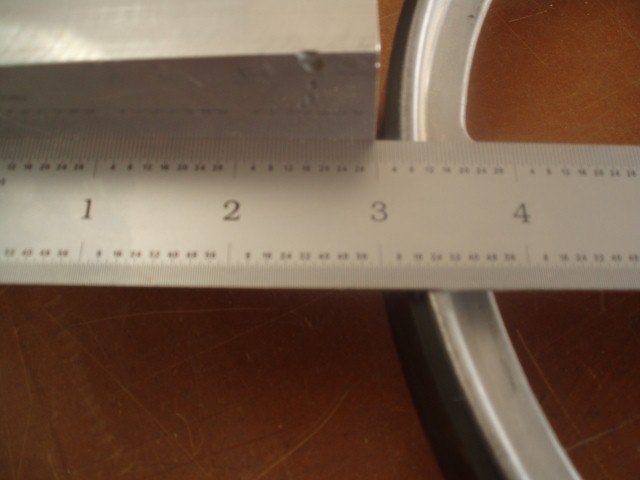

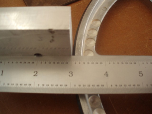

[ATTACH]26990[/ATTACH] [ATTACH]26991[/ATTACH]
[ATTACH]26992[/ATTACH] [ATTACH]26995[/ATTACH]
[ATTACH]26994[/ATTACH]
Additional Comment Posted March 5, 2015 -- Despite the photographic evidence, there does appear to be a slight difference in the diameter of the upper wheel when the front side measurement is compared to the rear side measurement. I must have jumped to conclusions that supported my beliefs when I did this original post. What now confuses me is that it appears that the upper wheel is slightly (1/8") larger on the rear side than on the front. This would imply a bevel of approximately 1/16" which is consistent with comments made by JPG. This confuses me because that would indicate to me that the blade would "tend" to move to the front of the which it does not. I am revisiting this discussion because I am attempting to make a decision on new tires. The diameter (11"), the crown (if there is one) and the bevel are critical, in my mind, to choosing the correct tire. Some of the tires are advertised for bandsaws with crowned wheels. I see that the Shopsmith tires are now a bright orange - who sells bright orange tires besides Shopsmith?

Look at the rims in Dusty's pix above. 'Back' rim is thicker. Wheel is flat and beveled. Front/rear od varies by about .1".

Yes the wheels are not shaped the same (inside and outside). But the rim is the same diameter both inside and outside. Notice also that the inside of the wheel has been drilled for balancing.
Read the ruler in the pictures. The ruler displays the diameter of the wheels. The first two pictures are the front side of the wheel and the next two are of the rear side. The aluminum blocks are against the tire on both sides.
