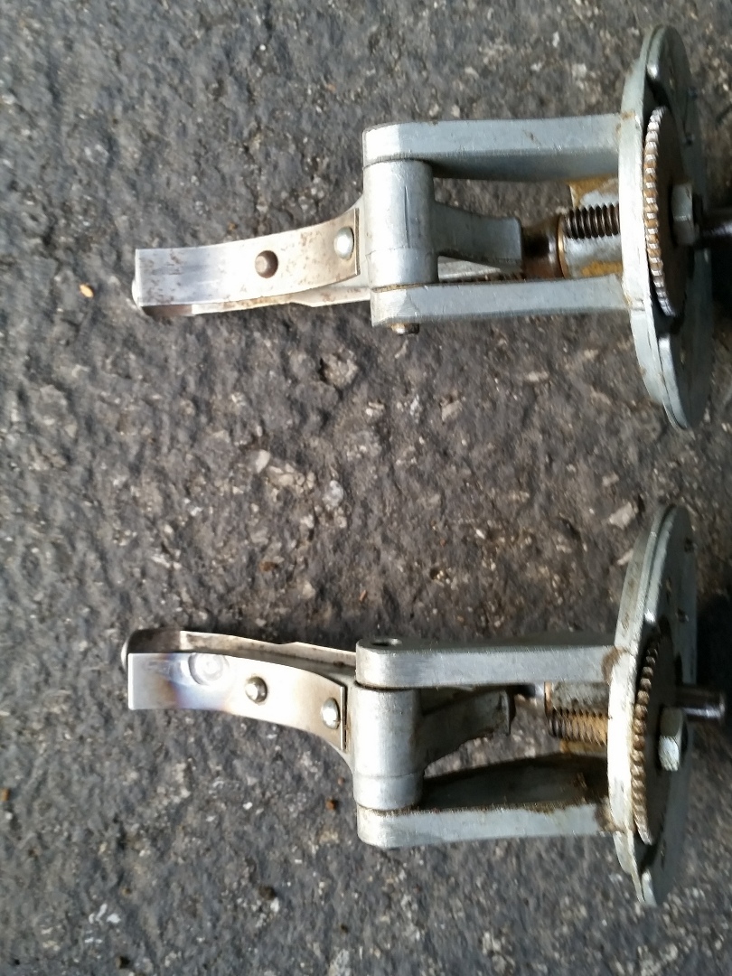

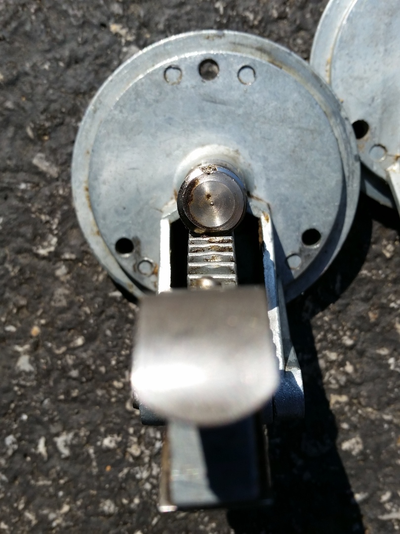

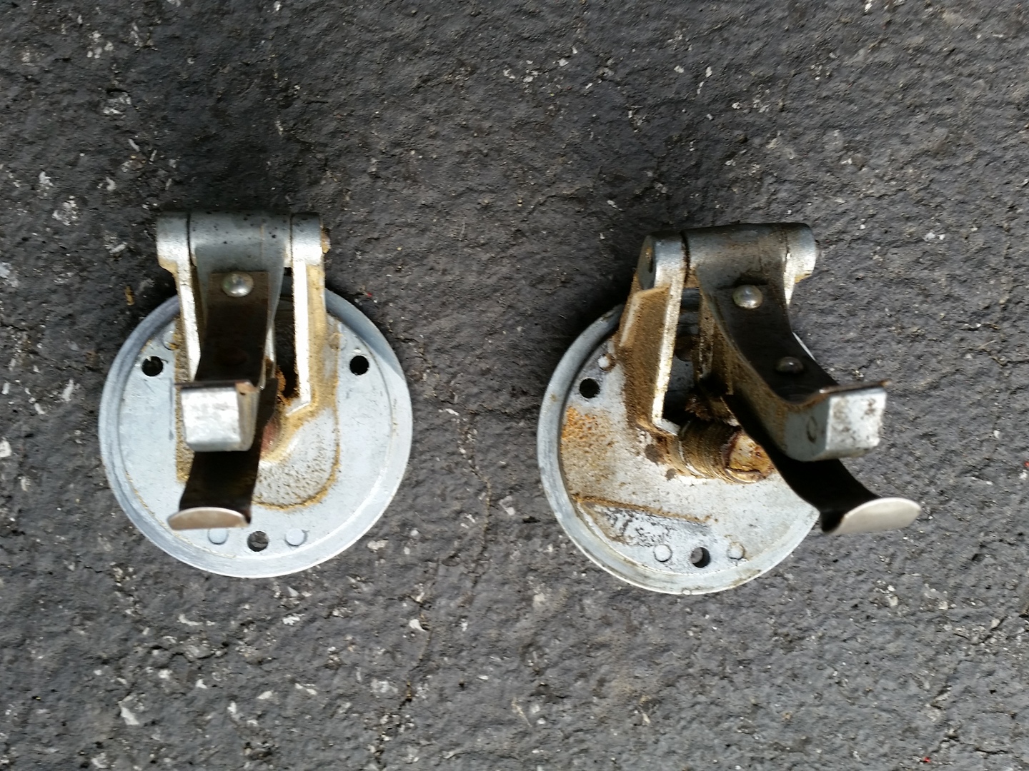

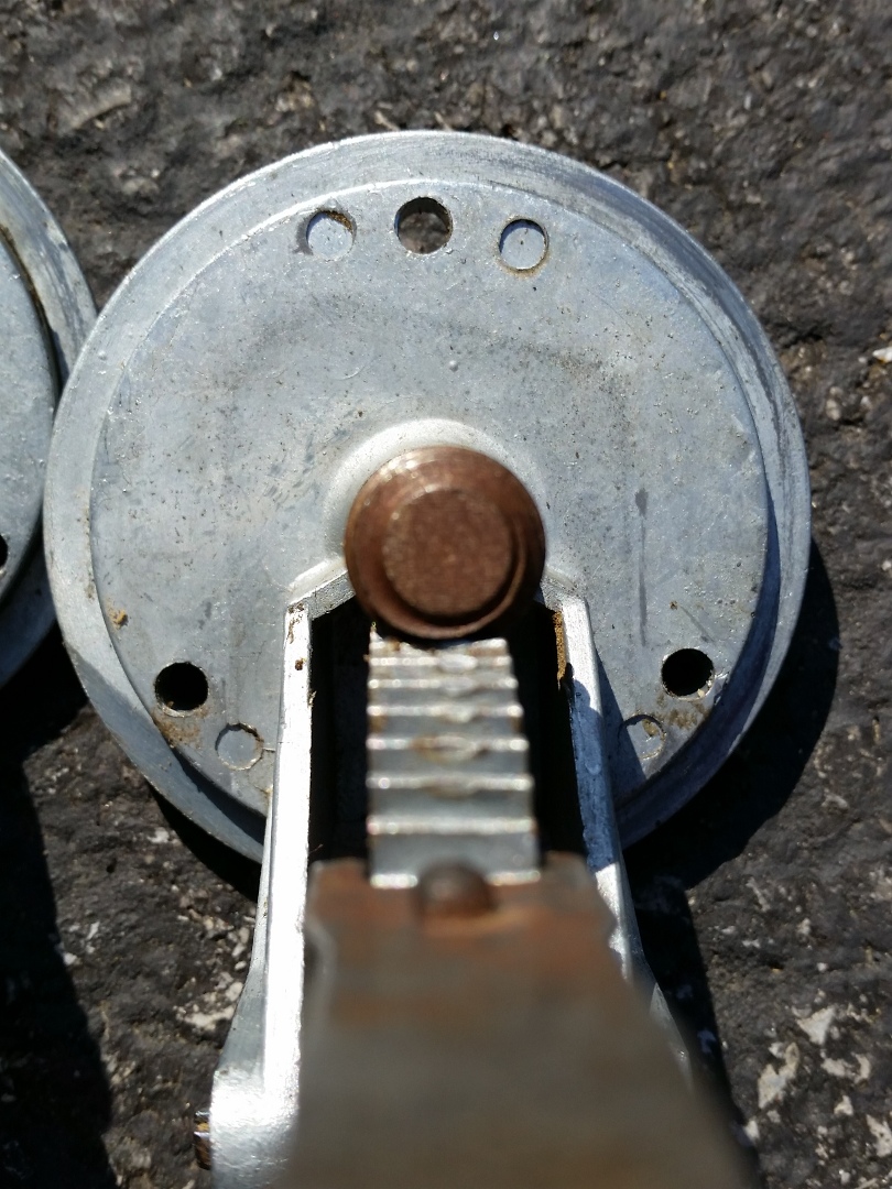

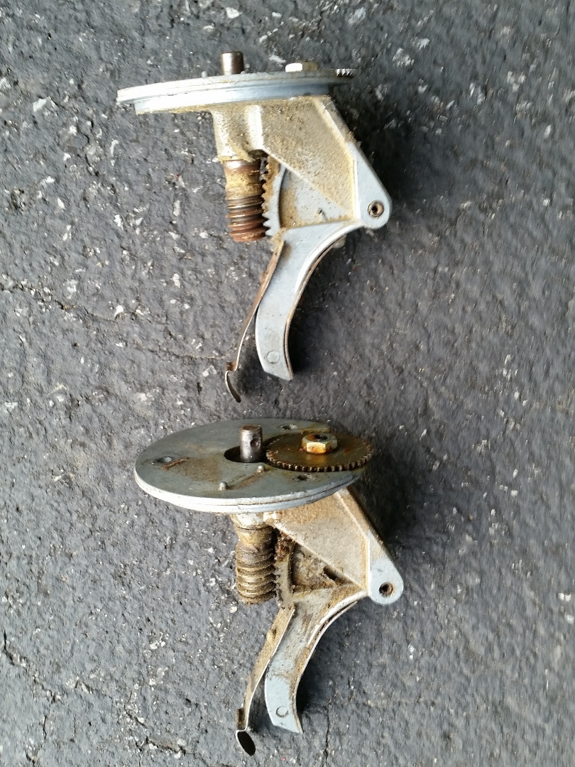

I've taken the porkchops out of both the "good" (500 upgraded to 510, which I've run and is difficult to reduce speed) and the "bad" (500 with broken speed changer, I've never run, which will be used for upgrading to Power Pro).
Both had "gunk", I'm guessing grease mixed with sawdust.
The racks look good, legs aren't splayed, there's a bit of wear on both sets of teeth.
The worm gears, on the other hand, both seem to have problems. The "good" one appears rusty. The "bad" is nice and shiny, but there's some... scrapes along the teeth at one point... I hate to use technical jargon, but they're buggered up ;-)
And the "bad" one, the plate that contacts the idler shaft, is "dented", the idler shaft ground a circle in the plate, which also shows heat discoloration.
Before cleaning... After cleaning, showing ground in circle and discoloration... After cleaning, showing rusty worm gear and shiny, but buggered worm gear. So, I guess I should try to remove the rust, any suggestions?

And last, the view from the end, before cleaning, the legs don't look splayed...

On the ground in circle and heat discoloration, I'd say the your control sheave's bearing was frozen up. Which caused both the circle and the heat discoloration.

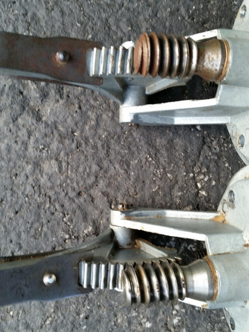

I've attached a couple more photos.
The worm gear seems to be centered on the rack.
I note that there's a some play, side-to-side, in the racks. Just a little bit, maybe a hair, not enough for a piece of paper, in the "good" one, maybe three times as much in the bad one.
Regarding the "blued" one having the loop attached to the button. Not sure what the "button" is, but the loop from the control shaft was looped over the leaf spring on the porkchop.
As far as being bent... I put a straight edge to the sides of both, at several points. The middle four teeth all touched the straight edge. I rotated the shafts and didn't observe any wobble.
I've come upon a photo of rack, with the wear slightly off center, like both of mine. I don't know it that's a good thing ;-)

- Worm and Rack on the "Good" porkchop
- PorkchopWormAndRack_Good_Smaller.jpg (349.69 KiB) Viewed 2583 times
- Worm and Rack on the "Bad" porkchop
- PorkchopWormAndRack_Bad_Smaller.jpg (269.45 KiB) Viewed 2583 times
