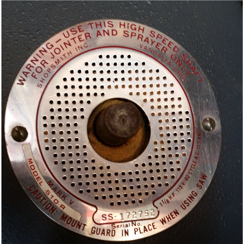

Ok, looked more closely at the label, the 510 is indeed a sticker, that says 510-R. And it says 1 1/8 HP.

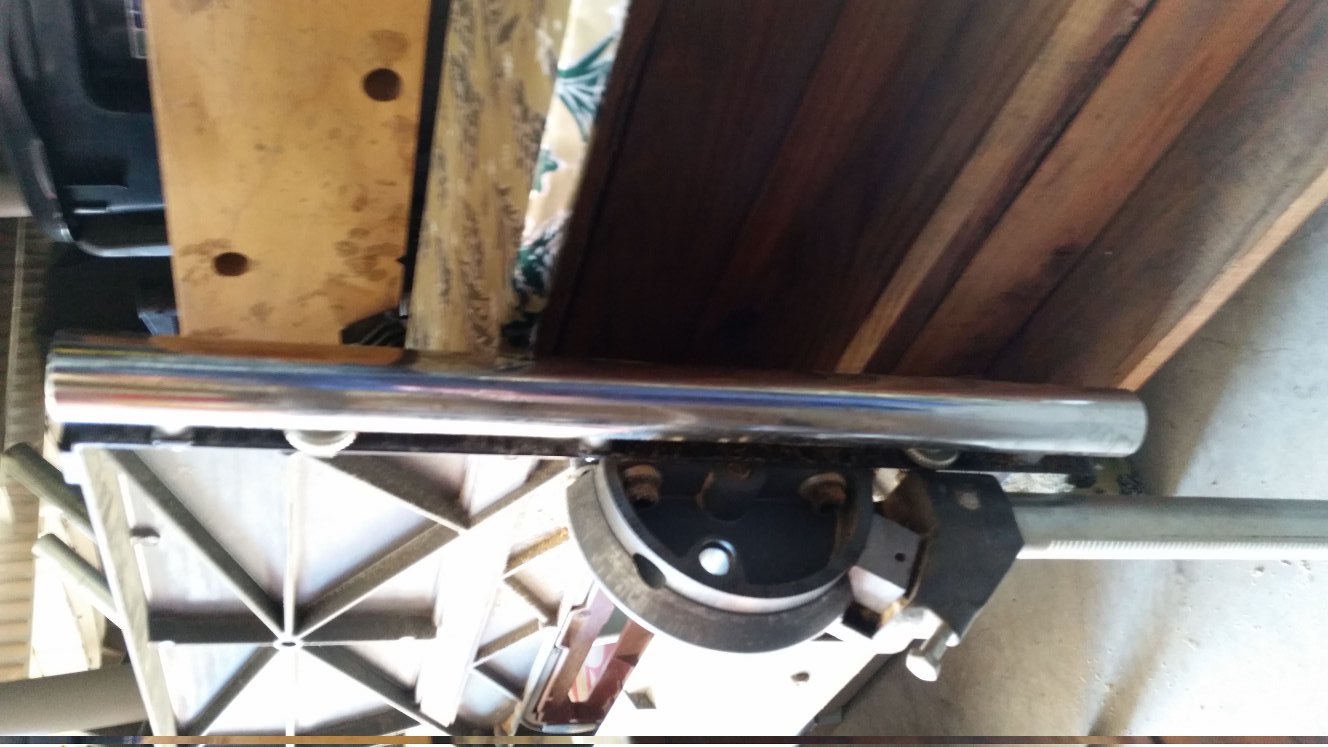

I don't know quite what you meant about the rails. I've included a picture of the side of the main table.

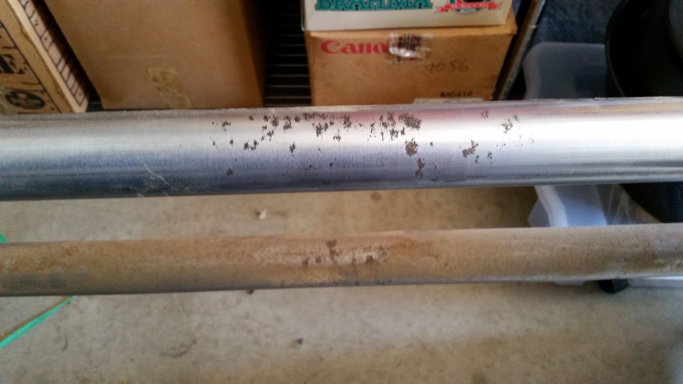

Way tubes... there's a spot of "rust", it's black not brown. Doesn't wipe off or scrape off with fingernail. I'm assuming a little steel wool, and then waxing would deal with it. Or.. not? Is it worth spending $100 for a set 4 of shiny, used, tubes. I've attached a photo.

"Is it worth spending $100 for a set of 4 shiny, used tubes"? Not for my money. It is only worth it if you want shiny tubes. Even then, you can shine what you have to look like new.
Be aware...the bottom two tubes are referred to as Bench Tubes and they will not shine up like the top two which are referred to as Way Tubes.

Cornell wrote:Ok, looked more closely at the label, the 510 is indeed a sticker, that says 510-R. And it says 1 1/8 HP.

Way tubes... there's a spot of "rust", it's black not brown. Doesn't wipe off or scrape off with fingernail. I'm assuming a little steel wool, and then waxing would deal with it. That will do! Or.. not? Is it worth spending $100 for a set 4 of shiny, used, tubes. I've attached a photo.

The rails are on the front and back of the tables. They be 'tubes'.

Where'd the pictures go? Trying again... Ah, they were too large...
Headstock disk showing sticker that says 510-R, and 1 1/8 HP. Main Table side, showing rail. Way tubes (and Bench tubes), showing corrosion. Top tube was wiped clean, the lower tube shows how dirty it is.
- Way tubes, showing corrosion. Top tube was wiped clean, the lower tube shows how dirty it is.
- wayTubes_cropped.jpg (118.99 KiB) Viewed 4443 times
