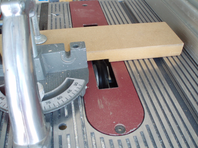

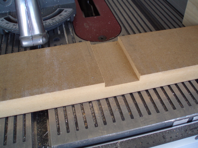

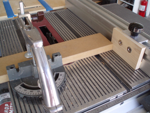

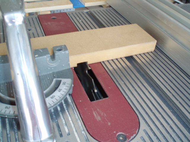

Paul has a better dado set than I do. I cannot cut a 1 1/2" wide dado so I would have to do this in at least two passes per piece.
Step 1: Set up per Photo 1 so that the edge of the dado furthest from the end of the 2x4 is right on the desired dimension (left side of blade makes a critical cut).
Step 2: After cutting all required pieces, move the fence toward the blade and align the right side of the blade for the other side of the dado. This too is a critical setup (right side of blade is critical).
(Photos 1 and 2 depict step 1) while (photo 3 depicts step 2)
Photo 4 depicts a wide dado cut with a 3/4" wide dado blade by making two passes..
Set up and cut a test board before cutting anything for use.
