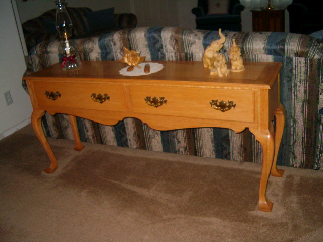

Buckeye: I use mostly red oak in my shop. Mainly because it is less expensive. Quarter sawn white oak sells at a premium. That is only purchased if the ray effect is wanted on the surface. I've only built one table using white oak and found it a bit harder to machine then red because rays are more likely to chip out.
The difference in tones is common in all the red oak I've run through my shop. This became obvious to me in my first project - a couch table. I randomly glued up pieces to make Queen ann legs. Didn't realize the color differences until sawing out the legs. This difference became more obvious after finishing. (Oh well! Wife says it's O.K.) Now I TRY to separate pieces with color changes. Some of this change is the way finish is absorbed. Some is sapwood vs. heartwood. Much of the differences have faded over the years. (about 20 yrs)

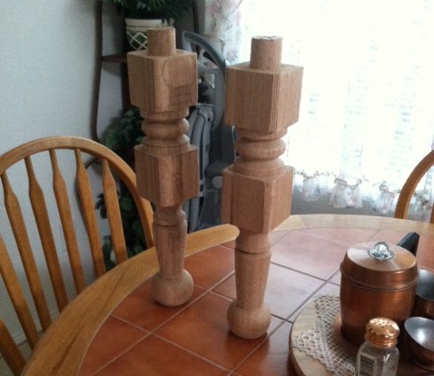

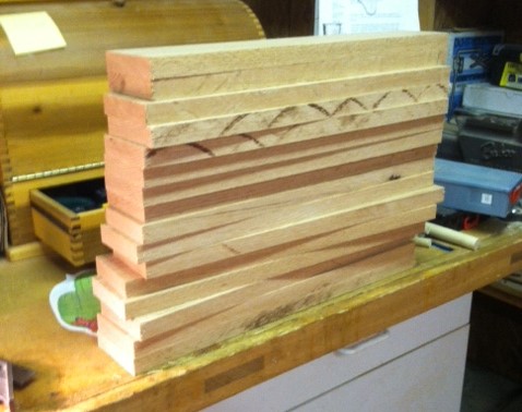

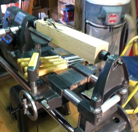

Legs for the bench were made in three steps.
1) saw boards to proper width and cut off to proper length
2) face glue boards together to form blanks
3) lathe turn to shape desired. Don't forget the top tenon. (hint) be careful of fingers getting thumped by the parts remaining square

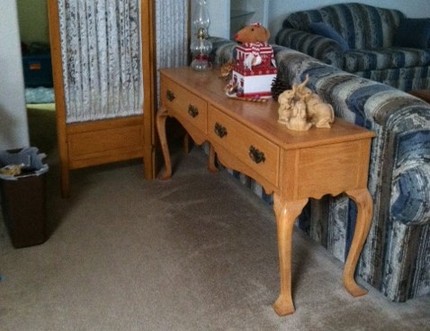

This was my original project. If you enlarge it you can see color chanes in the legs and also the edge boards of the top.
EDIT: FOUND A BETTER PIC OF THE COUCH TABLE
