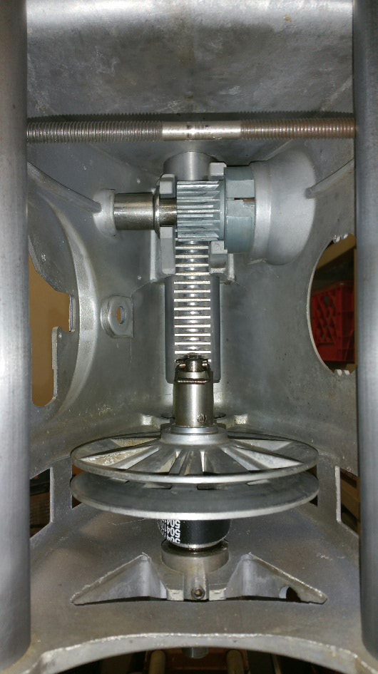

I've started to assemble the headstock. It's coming together smoothly. Based on all the talk about which groove to put the poly-v belt ('62 headstock) I took extra time making sure the belt was straight...it turned out evenly at two grooves per side.

According to the first pix, it is in the fourth groove.silenthope wrote:Well, my father always said "measure once, cut twice!" ...or was it...???
Revisited the poly-v belt alignment, and after rereading Dusty's technique, decided that it actually should be on the third groove for "the planet's to all line up"! Much happier now.
I also added a second washer on the idler pulley eccentric due to the screw not wanting to seat all the way.
silenthope
- Posts: 83
- Joined: Thu Feb 11, 2016 12:29 pm
- Location: Tucson, Arizona
Re: Mark 5 Restoration - Tri-60 Project!

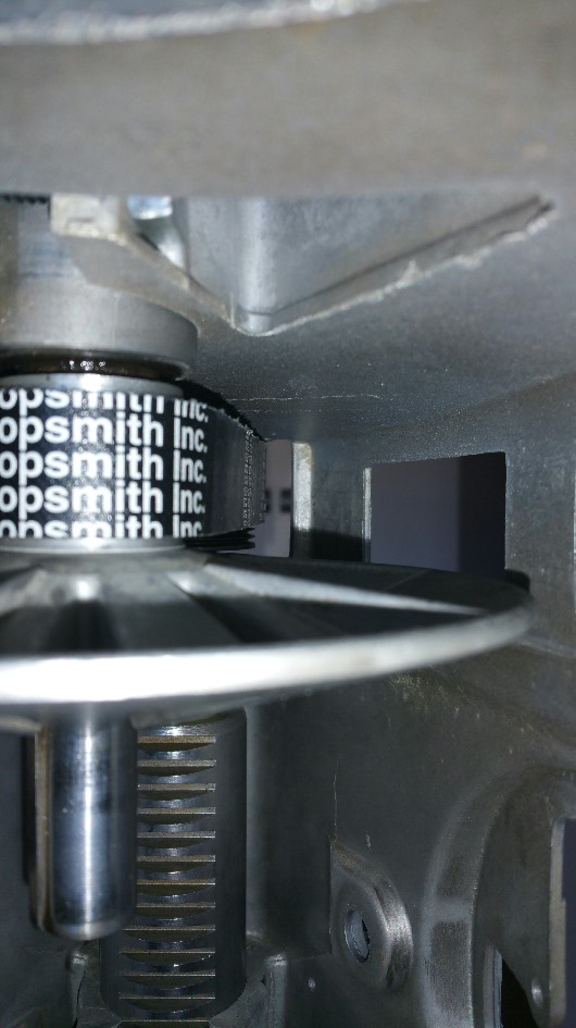

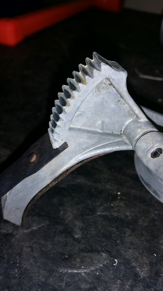

JPG...I stand (humbly) corrected!!! From the second picture, would you say the alignment is correct? I moved the belt until I had no "bend" as the belt traveled from one pulley to the next. I was very satisfied that it was straight. From the third picture, it seems that the idler bearing and eccentric bushing are in the correct position. Do you agree?JPG wrote:According to the first pix, it is in the fourth groove.
Thank you for your keen scrutiny, it helps minimize mistakes!

The belt appears flat in the second pix.
The eccentric is correctly positioned in the third pix.
Not knowing which idler shaft you have I cannot say re the idler shaft/bearing. That said, it does not look 'out of place'.
If you have the water pump bearing, the groove locates the bearing within the eccentric. Since you do not have the second screw on the eccentric, I assume that is the case.
