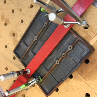

This may be the final try on this. Had some left over bars from my old Ford 8N mower that are fairly heavy and I've got some shims on each end and clamped till the dish is flat to the table. If this doesn't work I may have to resort to some heavy force like my Jeep!
- IMG_0432 Bar over Table.jpg (53.41 KiB) Viewed 5410 times

I wonder if Shopsmith's lifetime warranty (which IIUC extends beyond the original purchaser) still covers cast-iron bandsaw tables?
I don't believe that heat will do much to "correct" cast iron, short of melting it back down. And as for bending it flat, I strongly suspect that it would break first. That table must have been milled "green", and then moved as it aged. That was a common mistake with early Asian machine castings. The Tiawanese eventually got pretty good at machined castings, just in time to be underpriced by their cousins on the mainland.
