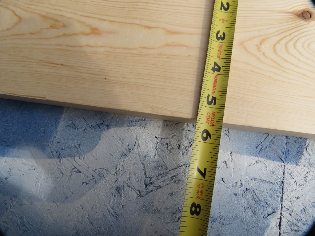

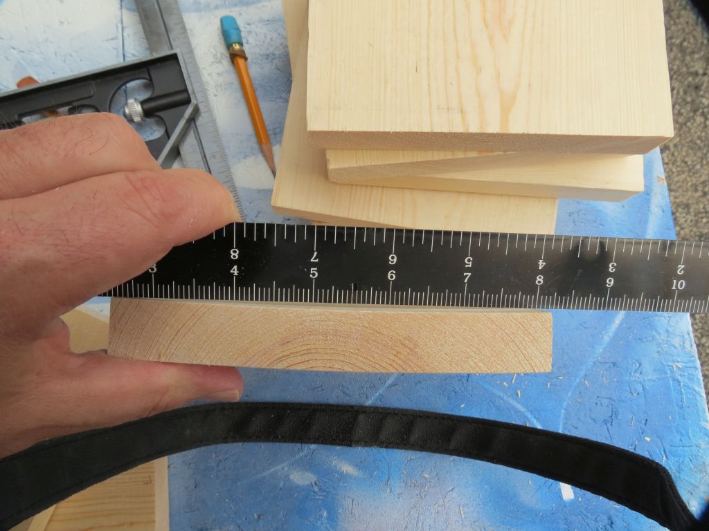

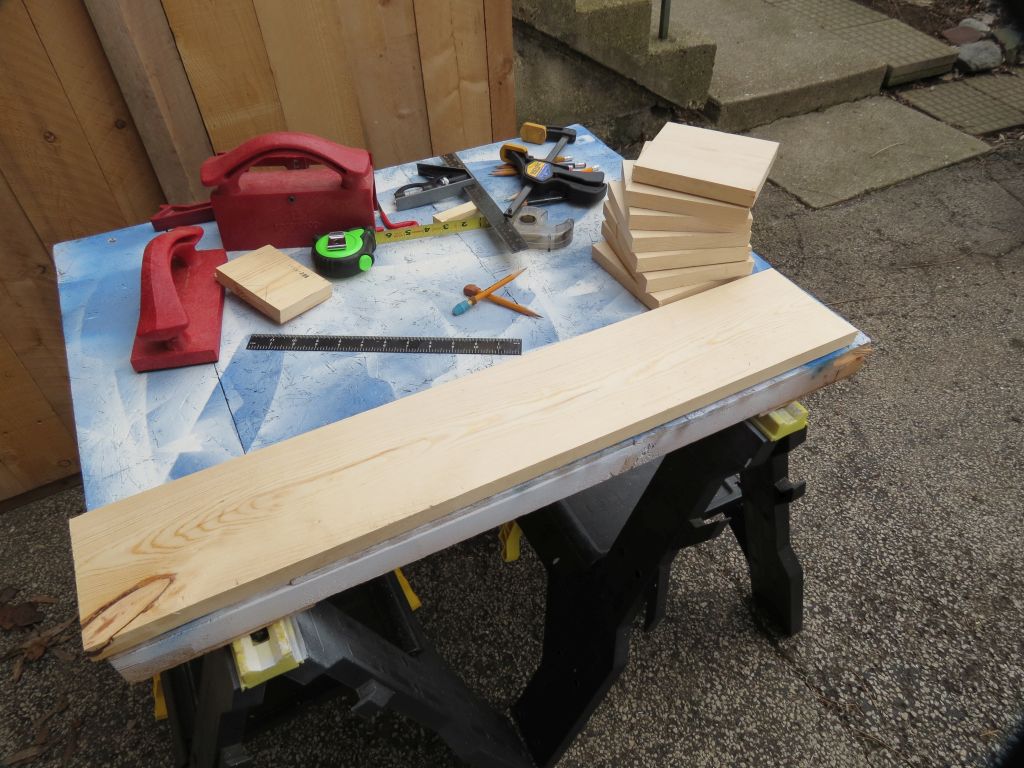

So you should now have your wood and be ready to get started. It is good idea to check the wood you have to make sure it is what you think it is size wise. When I measured the stock I have it was 5-3/8" rather then the 5-1/2" I was expecting. I went a redid the drawing working with the new number.

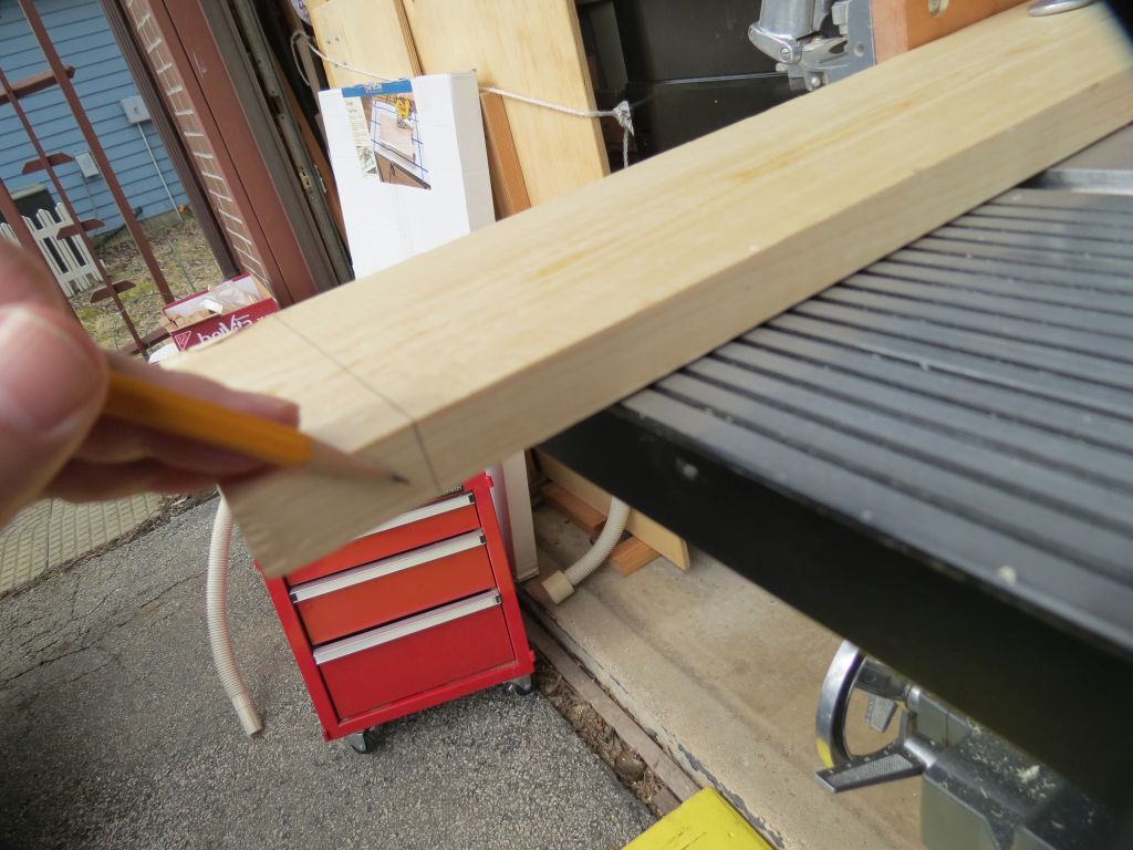

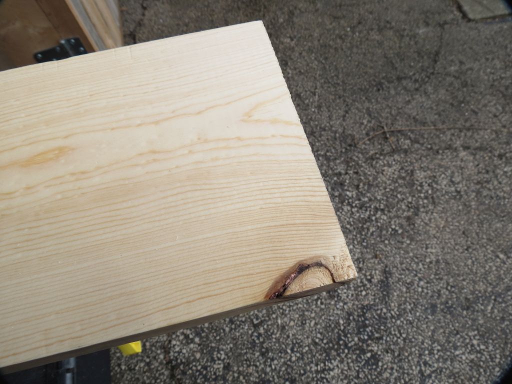

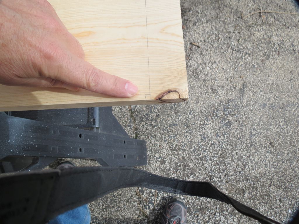

I also looked at the end and found this knot that I did not want in my pieces.

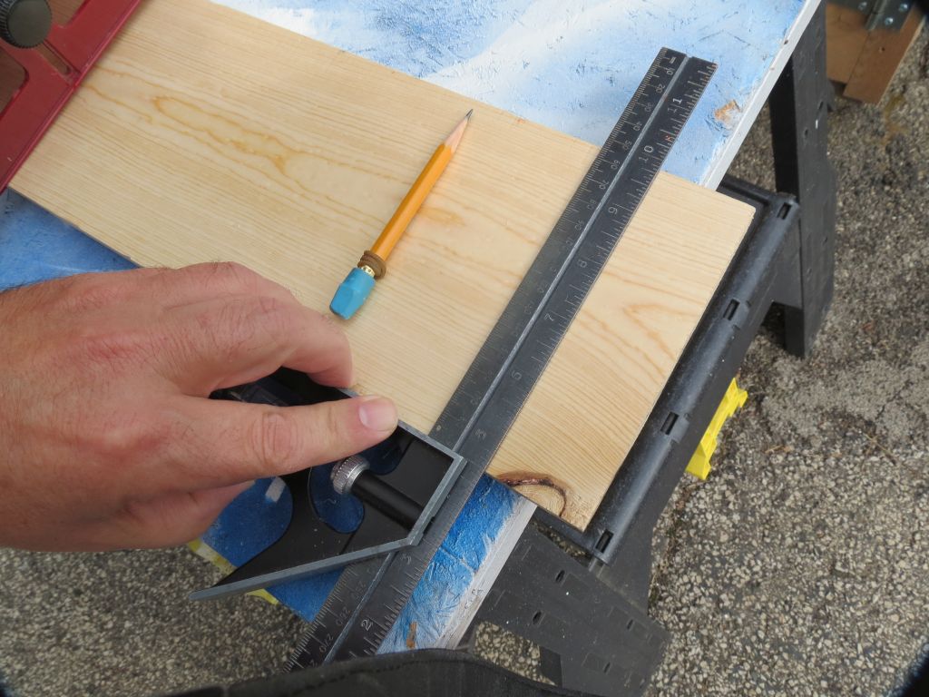

I then marked the part I wanted to cut off.
I then mark a datum mark on the edge that I will be using against the fence and that is the same edge I use for marking with a square. This is not critical for this project but it is a good idea to get use to keep a reference edge.

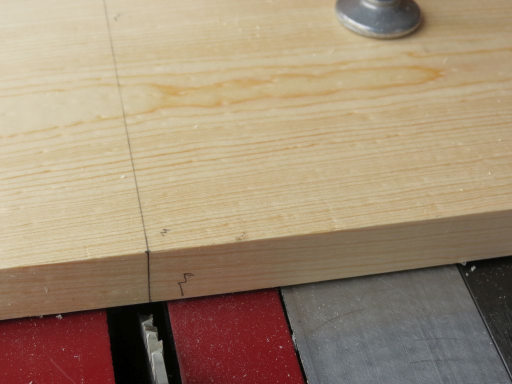

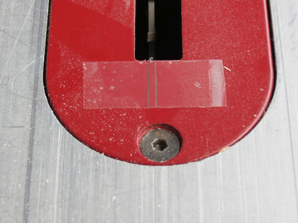

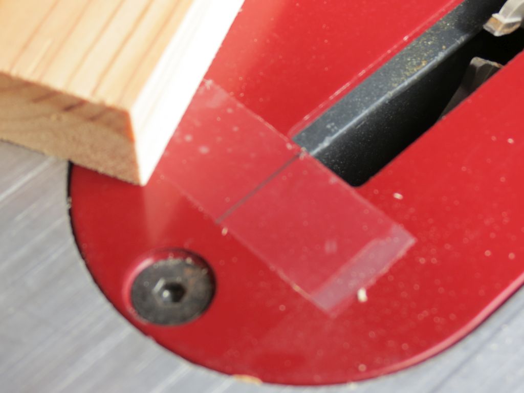

Next I want to get the saw ready so I can cut to the line and not just use line of sight or guess. I do that by using magic transparent tape, a strip put down on the table insert just before the cut out.
I then use a piece of scrap wood and make a cut to establish the left edge of the blade. You make the cut and turn off the saw then slide the piece back to where the tape is and mark.
The line should look like this but be in focus better.
You use this line by making a line matching the location on the face. The line and the one on the saw table get lined up and you make the cut. Keep in mind that the waste side must be on the side of he line that gets cut.

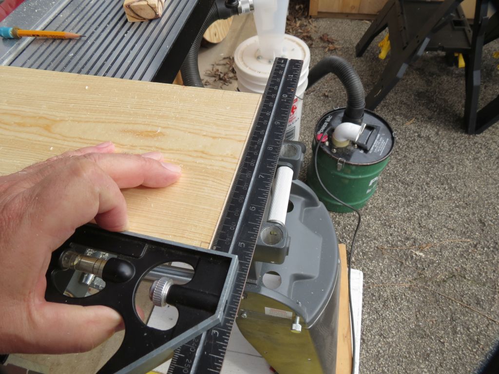

After the cut it always a good idea to make sure it is square.

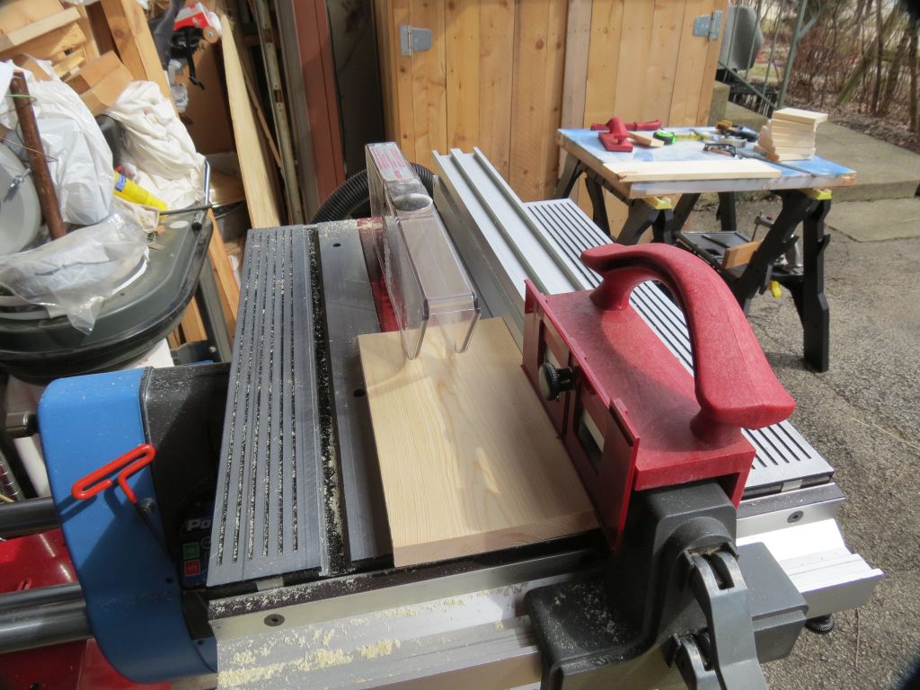

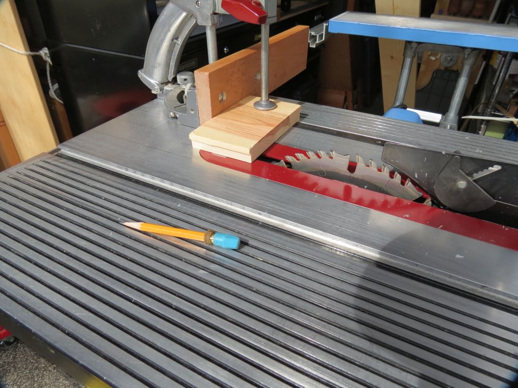

Now you could start marking to make the 7 pieces that are the trays or you can set up your fence with a block and make all 7 pieces the same size and not have to measure each one. I think that is a better way so here we go.

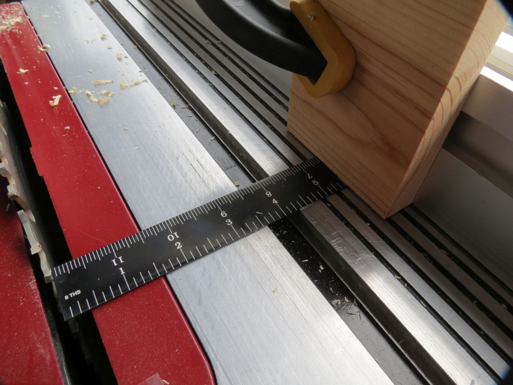

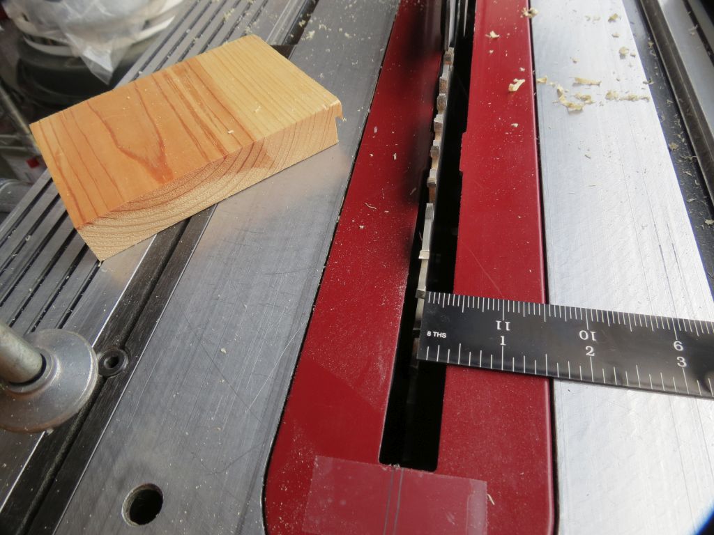

Put the rip fence down and rotate the blade so a tooth that is closest to the fence matches where the ruler sits.

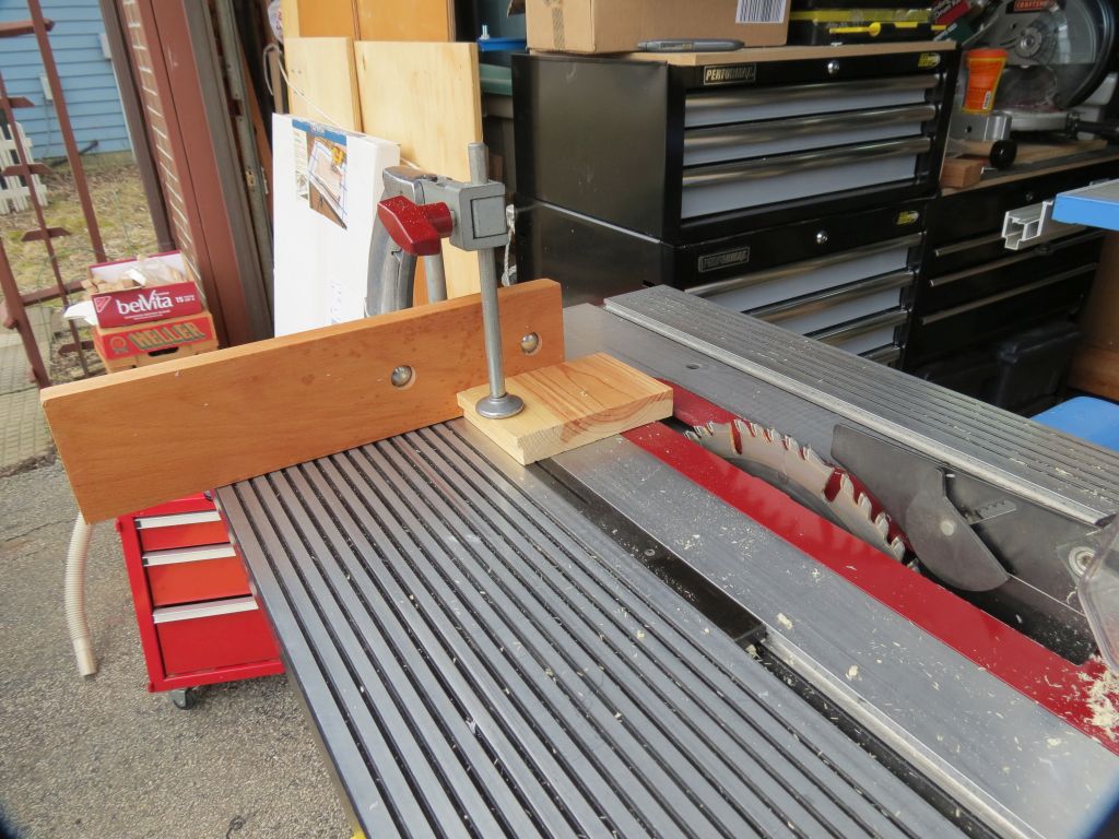

A scrap clamped to the fence is then used to measure the distance you want from the block to the blade. In our case that is 5-1/2".

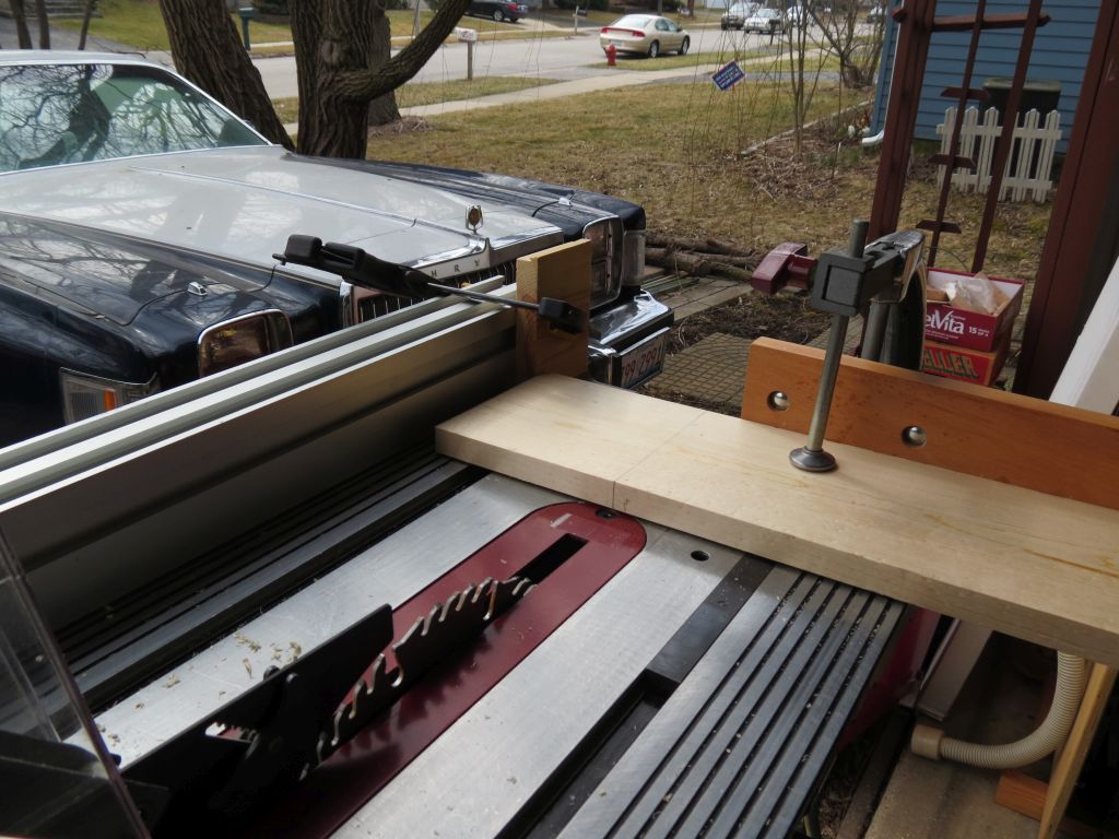

This block is now moved up on the infeed side so the stock can be pushed against it and then clamped by the miter gauge. You always do this if you have a through cut and want to use the fence as a reference.
You are now set to cut the seven piece. Just keep moving the board to the stop and cutting to length.

You will have to measure this and draw the lines like before. When you get to the saw you will see you have a problem. You know where one side of the blade is but not the other. In order to make the cut you need to establish were the other edge is.
You will do pretty much what was done the first time but with the miter gauge now in the right slot. Just cut and turn off the saw then slide back and mark.
Now you have both edges. Just make sure the waste is to the waste side and you will be good to go.

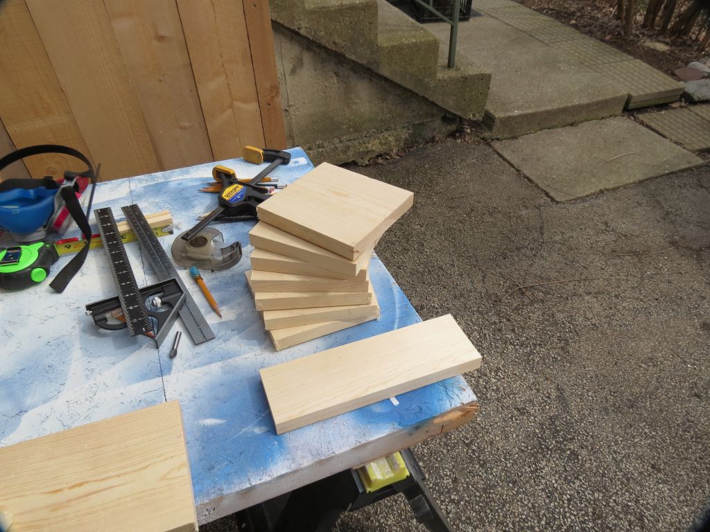

This is all the parts out of that board.
You can now cut up the pieces out of the second board. Since that is pretty much what I have already shown you I will assume you can get that done.

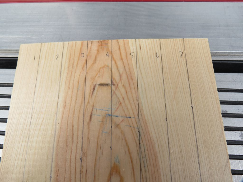

We need to divide up our rack so we can route 7 slots. I've provided a drawing at one point but who wants to do all the measuring??? I will now show you an old wood workers trick to make this pretty easy and still be accurate.

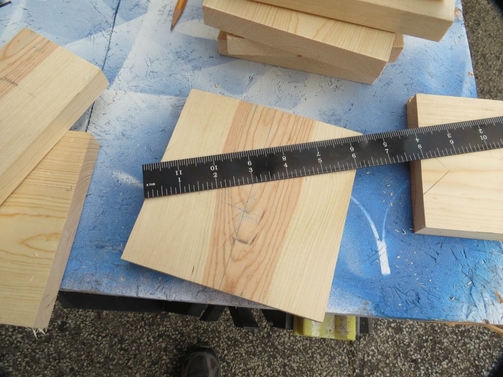

You start by laying the rule so the edge of the rule is on the edge of the work piece. They you find a nice even number to use to divide into. In this case 6 is our number.
Half of 6" is 3" so we can mark that and that will be the center of the board.
And of course half of 3" is 1-1/2 and half of that is 3/4". I went ahead and did all of them but we really only need half of the lines as you will see later. Here are the seven lines which will become the 7 slots.

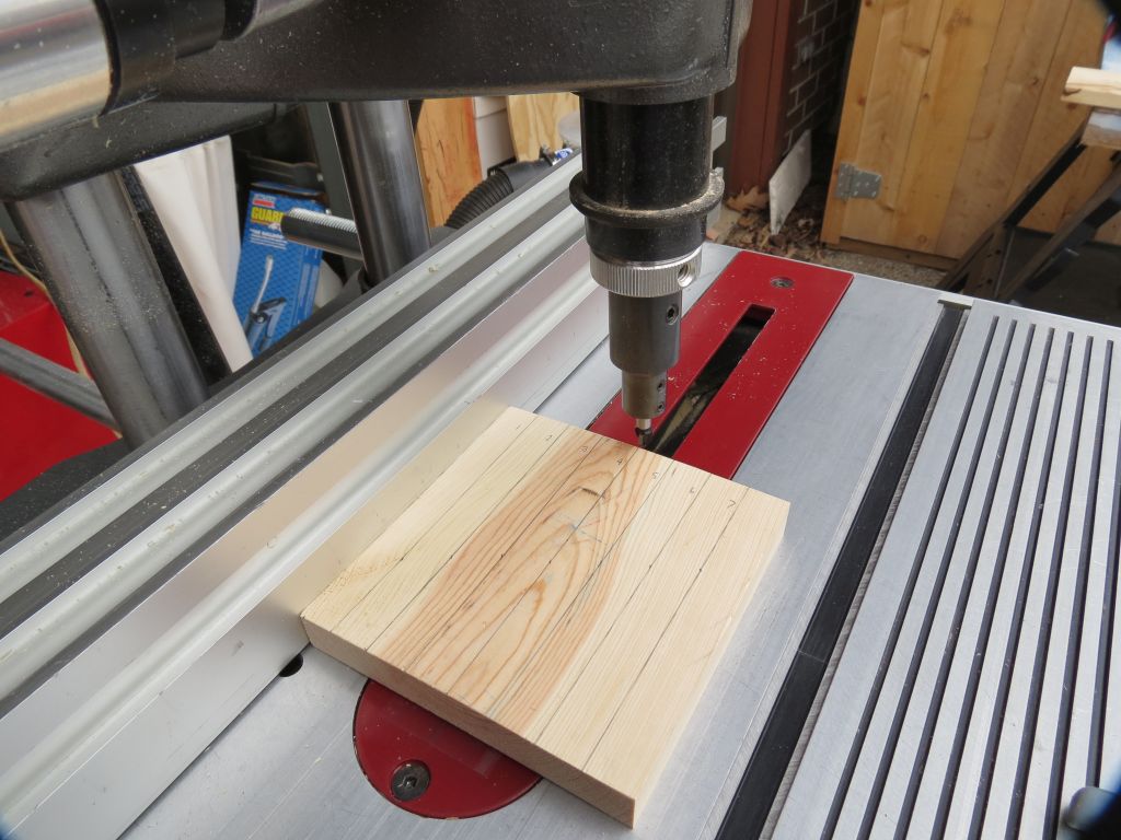

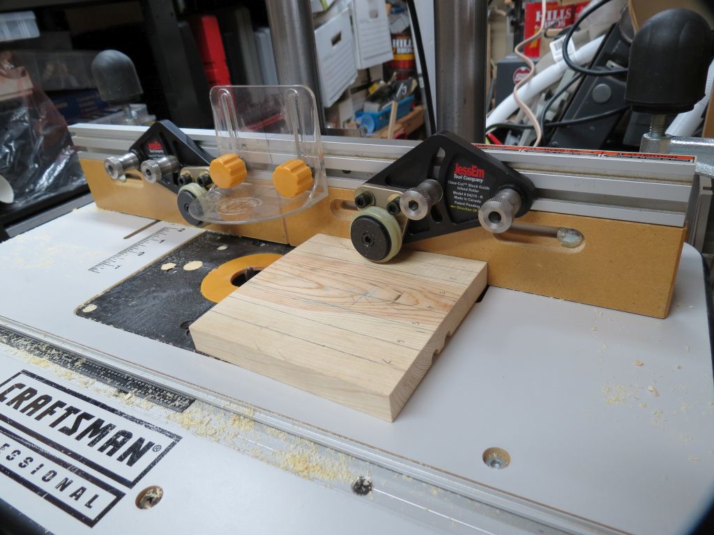

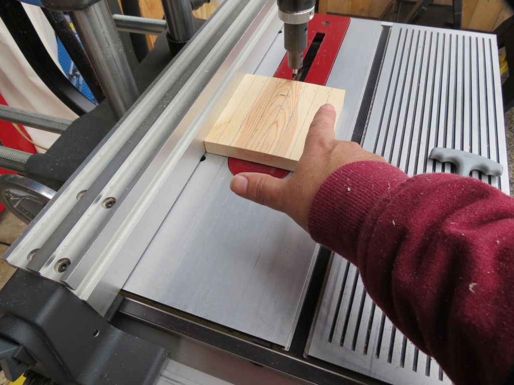

Now that we know where you want the slots we can set up to route them. First I'll show you have it is set up on the shopsmith then we will go to my router table and so the routing.

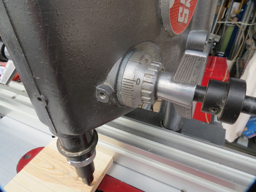

The shopsmith runs a little slow as a router but if you go slow and let it cut you will get there. First you need to go vertical, well unless you have the powerpro and dual tilt but we are not going there today.

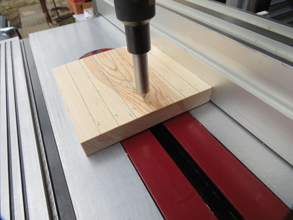

Next you need to set the fence so you can route where the lines are. They make a device to help you do that as seen here:
Or just a visual with the bit works for this as the bees will not be complaining if the holes are a bit off.
You should be able to make these cuts in one pass but if it feels to hard to do then do it in two passes. We want something on the order of 5/16" deep but again that is not critical.
Since you have the router above you then use the right hand rule. The thumb faces the fence and the fingers point the direction you move the work piece.

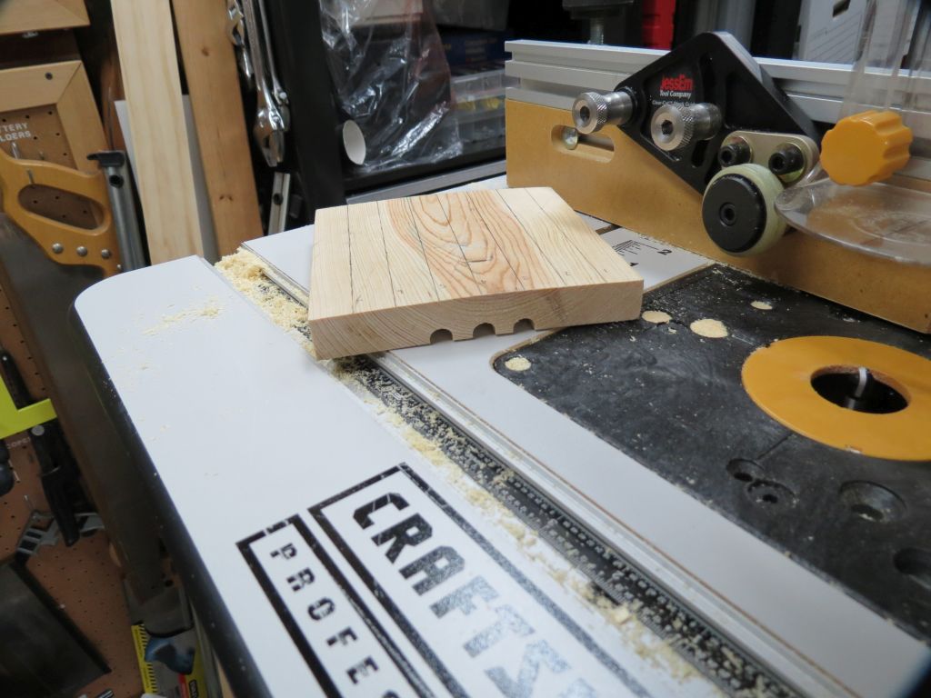

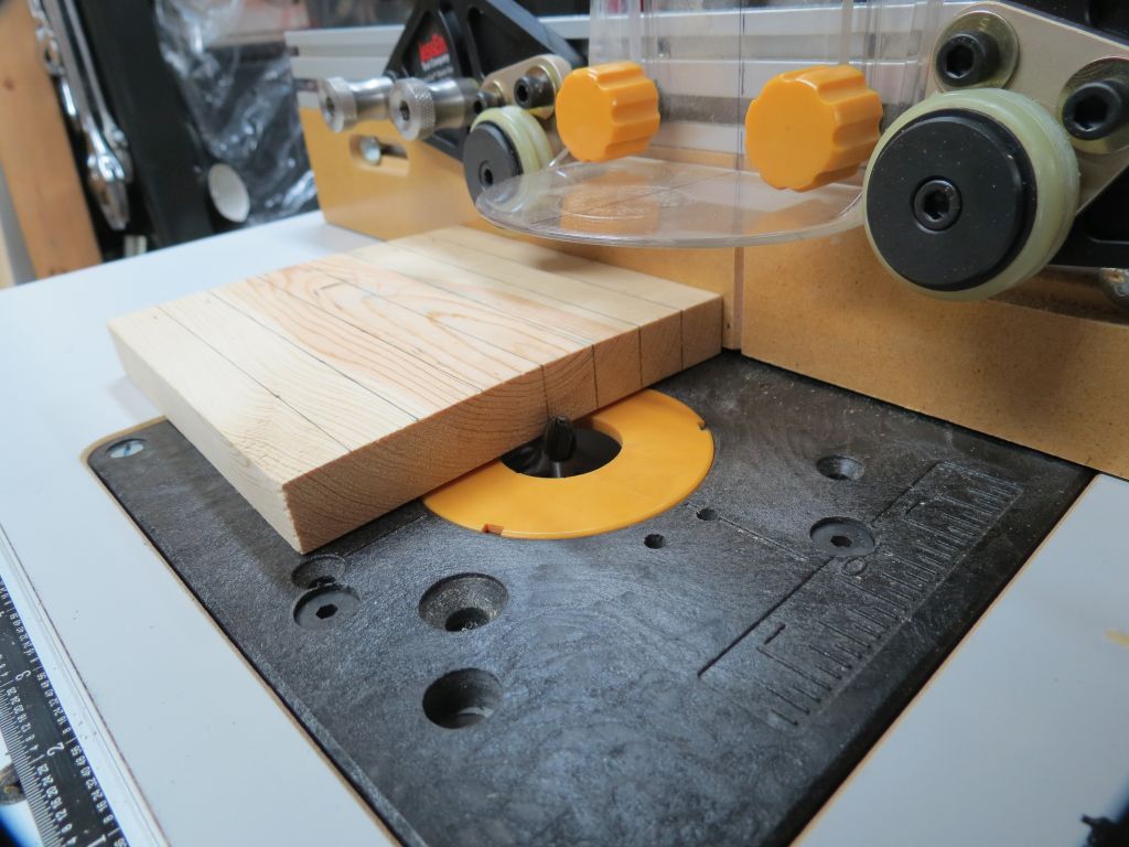

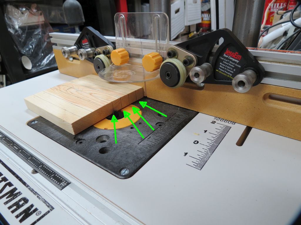

Now to the router table and cutting some wood.

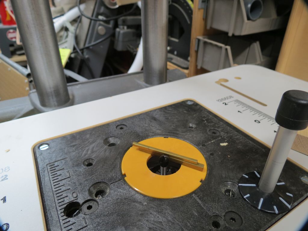

First I set the depth of cut using brass bars.

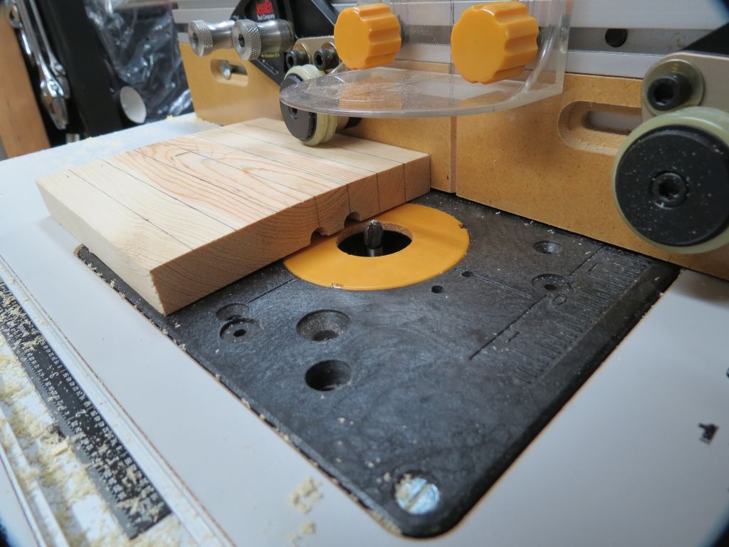

I then eye-balled the bit to line placement.
Keep in mind we really only need the lines pointed to in green.
With things lined up and locked you router all 7 boards.
Then you line up to make the next slot and cut it.

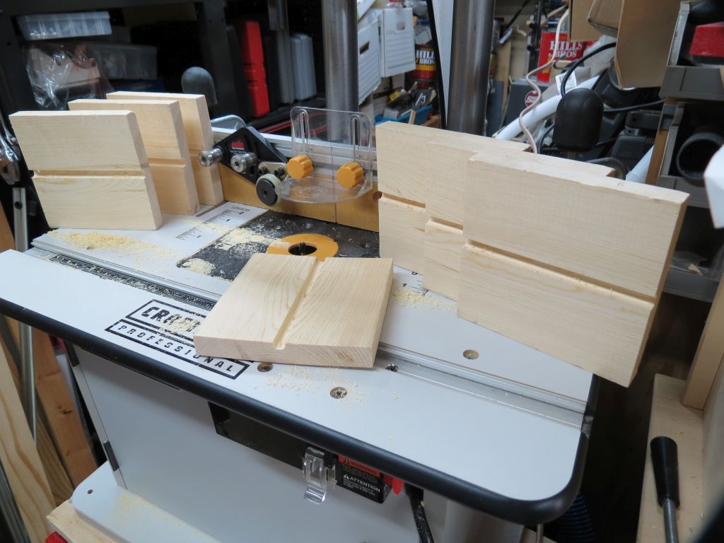

This time once the first cut is done you rotate the stock 180 degrees and route the slot on that side.
When you have finished this second pass
you then move on to do this to all seven pieces the same way.
Back to lining up the next slot, cutting, rotating and cutting and working through the pile. Pretty soon all the slots are cut.

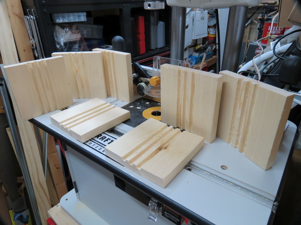

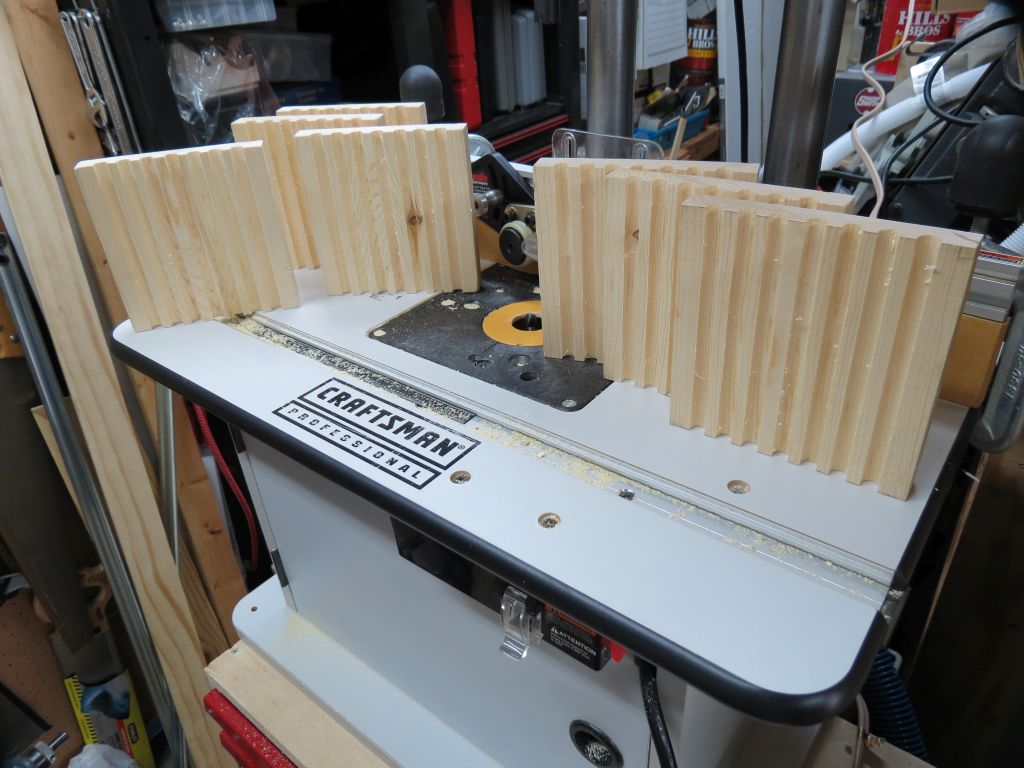

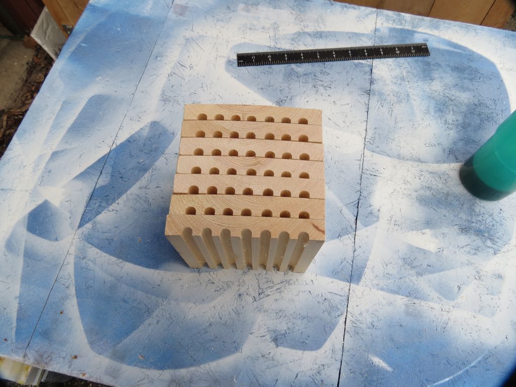

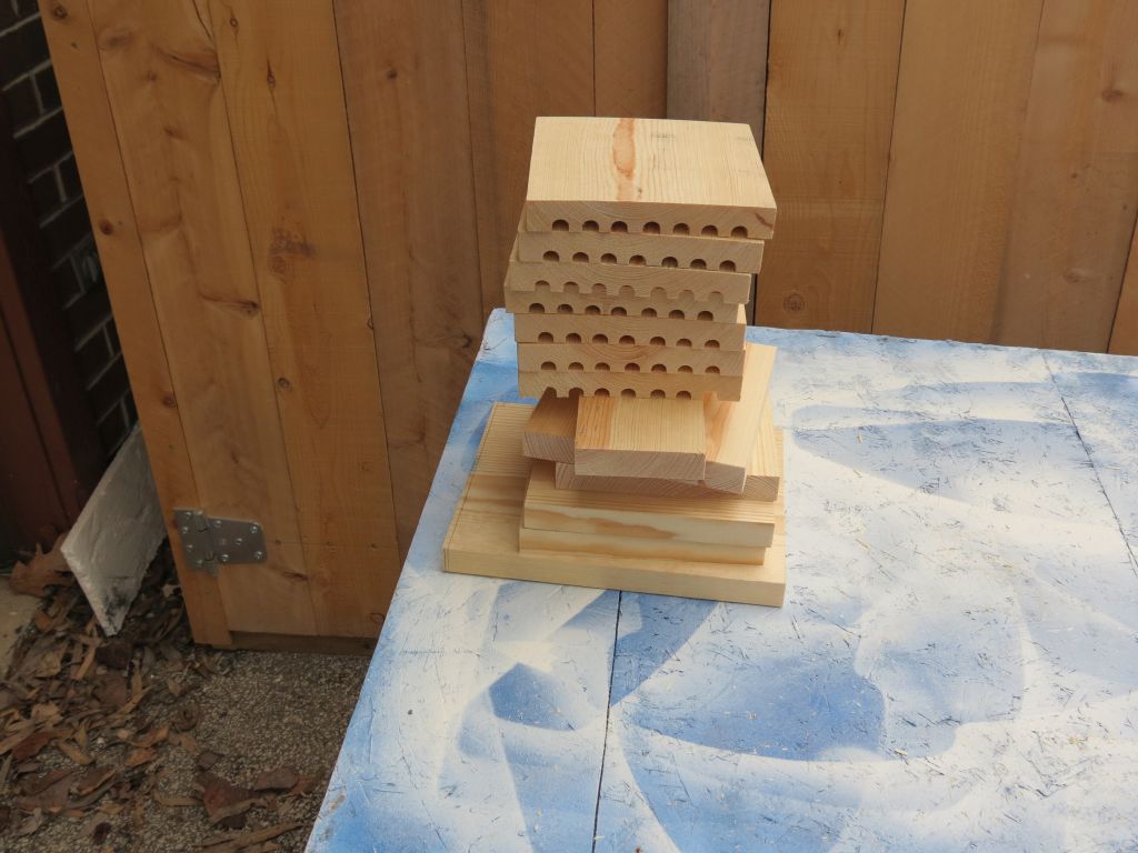

So here is the stack of parts
The racks
And this is as far as I got
Weather permitting I will be back on this tomorrow.

I dont know how you read a tape measure, but to me it looked like 5 3/8s not 5 5/8s instead of 5 1/2" :D
Good thing I caught it b4 JPG. :eek:
Thanks for all, will be building one off your design but using 5 1/2" ;)
Re: Today in your shop (mason bee house anyone?)
ERLover wrote:I dont know how you read a tape measure, but to me it looked like 5 3/8s not 5 5/8s instead of 5 1/2" :D
Perhaps you need to check what you read. I was expecting 5-1/2 but the lumber as shown and noted in the text show that the piece was 5-3/8.... were did you get 5-5/8 out of this?????

Boy am I glad you posted this I was going crazy trying to figure out what he was talking about. I saw 5 3/8. For the life of me I could not find any picture of a measurement that looked like 5 5/8

Maybe just a typo?
