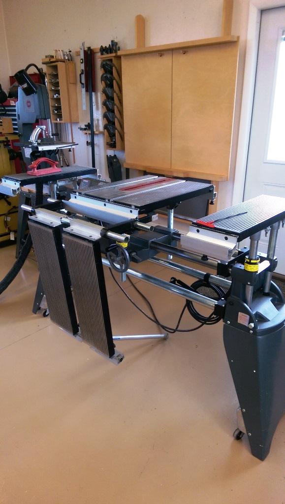

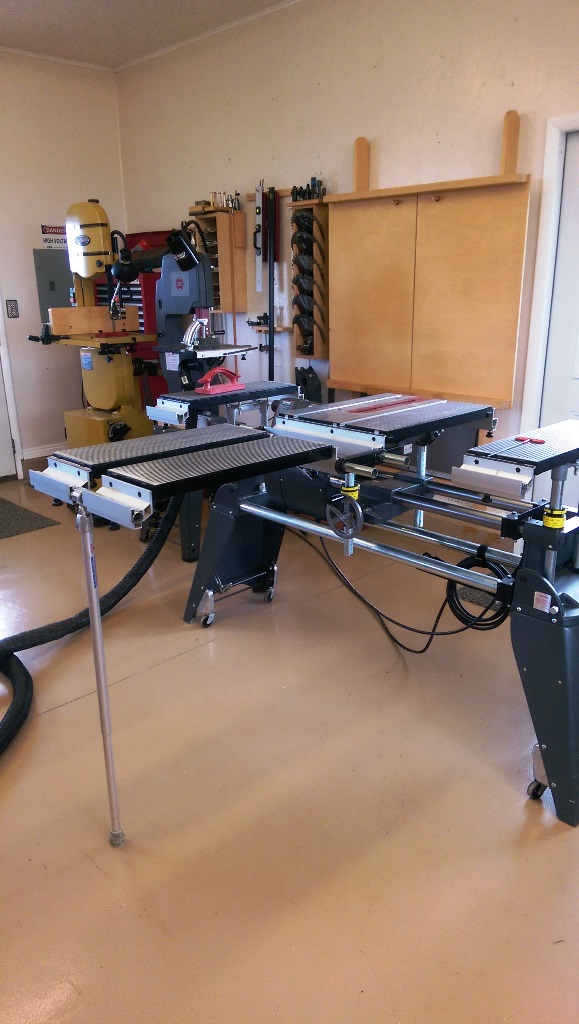

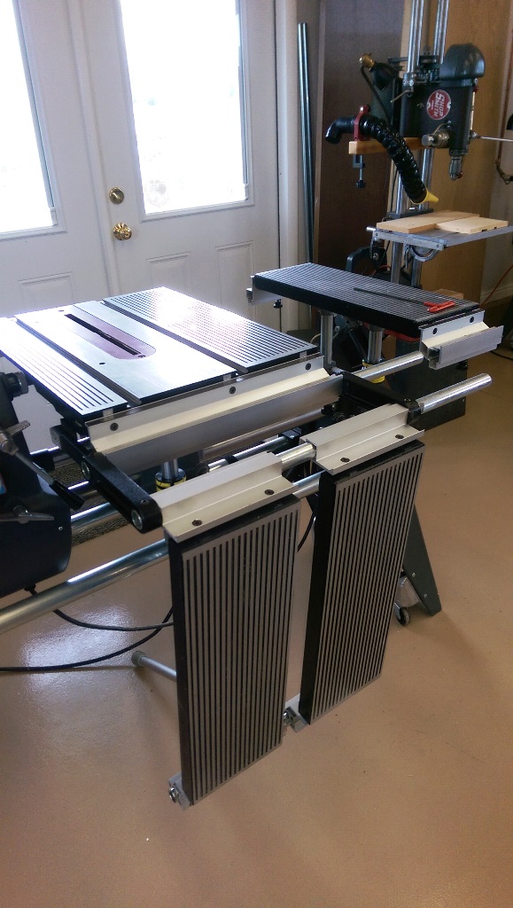

OK, so I went out to the shop today and played with the SS extension table brackets.
http://www.shopsmith.com/ownersite/cata ... racket.htm
It is very easy to drop the tables down without removing them. Just loosen the set screw in the telescoping leg that tightens against the connector tube, loosen the black nobs on the two floating tables and lower them down. As an alternative you could remove the telescoping leg completely from the pivoting bracket but that is not really necessary.
I set the floating tables up on the in feed side but the same thing works on the out feed side. I am not sure I would want the tables attached all the time on either the in feed or out feed side but they can be folded down out of the way with the SS brackets when needed.
I also decided to slide the connecting tubes all the way to the right so they were flush with the left hand bracket. Keeps the area around the head stock clear if you leave them attached.
