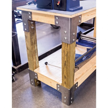

I certainly would get the best quarter-sawn quality materials to start with as others have stated.
I know it's not the same thing, and yet it is the same thing, only different.
Through Eastwood.com, one of the companies I use for welding gear, I am leaning toward one of their shop table kits for a bench, that isn't a woodworking bench per-se. See http://www.eastwood.com/eastwood-shop-table-kit.html
The steel brackets are laser cut and CNC bent for accuracy to produce parallel, plumb, square and strong connections that can be bolted, or welded if that's your need.
They show a 4x4 & 2x4 frame in the photo, but one can build them with tubing and angle iron. I have seen plastic ones (ok structural foam) that sell for the same price as these. These will hold up to some serious pounding that I just wouldn't do on my woodworking bench.
Everett
Eastwood Shop Table Steel Brackets.jpg (44.82 KiB) Viewed 8264 times
