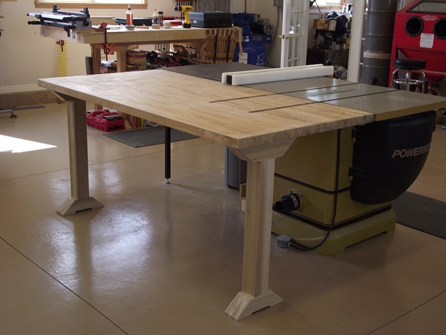

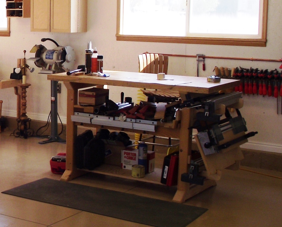

Plywood is much softer than hard wood so it is way more susceptible to damage. A good maple top should last a life time. Many companies make laminated maple bench tops in various sizes. They are 1 3/4" thick but some are thicker. I have a small utility bench I made from one and the out feed table for my table saw is made from another. Definitely more expensive than 3 or 4 sheets of plywood but worth it in my opinion due to the weight and durability.moggymatt wrote:After attempting to do a project this long weekend, and for the umpteenth time having to move the same items around to make room to get started, I decided to clean house instead. It was a good day of progress but Dam it was hard getting rid of all the stuff I MIGHT use some day. Epically all the cut offs. Now I have a clean bench top and I'm thinking it's time for a new woodworking bench. I've been using a double layer of solid core doors for my top for years and they have served me well, but they are all beat up.
I've looked over all the articals but haven't been able to find one on the pros/cons of using built up plywood instead of a built up hardwood for the top.
Anyone have an opinion?
