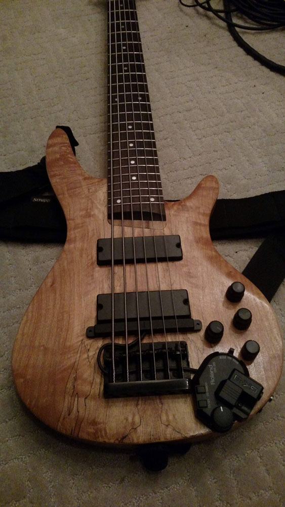

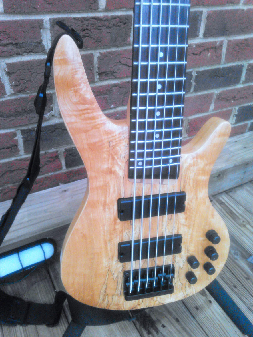

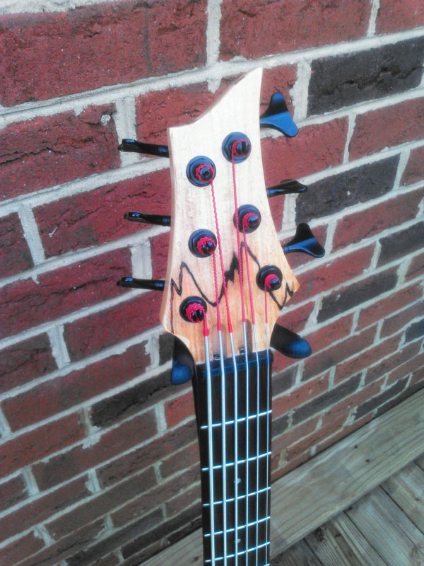

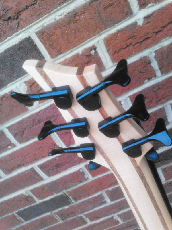

Thanks. Here's a picture of one of the more recent builds. This is a 6-string bass I made, featuring a spalted maple top over swamp ash.
6-String Bass
6-String Bass

It isn't the best picture and doesn't do the grain justice. This is a hand oiled finish. There is more quilting than the picture may indicate.

Looks pretty nice to me! I play guitar -- mostly acoustic these days -- and of course I dream of building my own some day.

Thanks. I recently added a synth pickup. At least this picture gives you a better idea of the grain. This bass features separate volume controls for each pickup, active/passive push/pull, bass/treble, mid volume/frequency sweep and a piezo volume on the push/pull knob. The piezo pickup is under the bridge. Now, with the synth pickup, it supports more different tones and sounds than should be allowed. (laughing)
