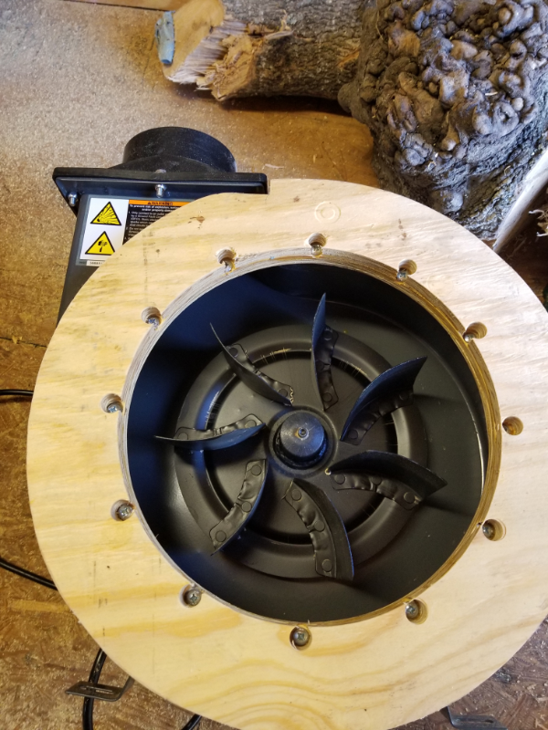

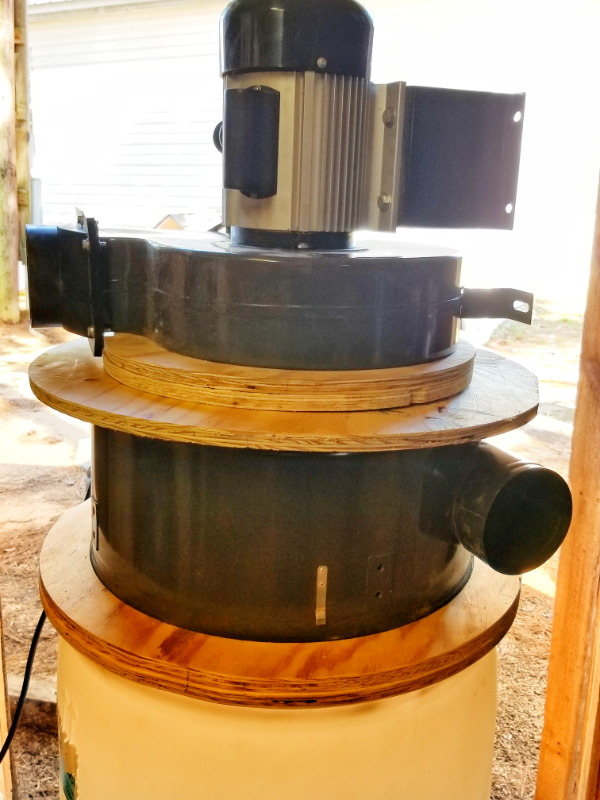

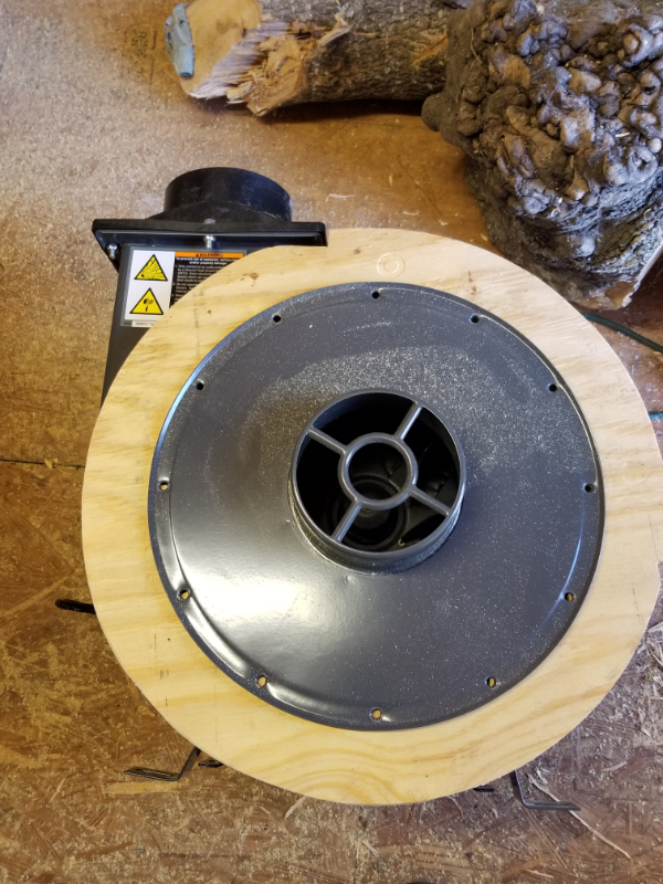

I'm getting close to finishing the main dust collector unit, but I have a question. Here is the assembly mocked up.
From bottom up... barell, lower plywood ring with thein baffle, dust collector center ring/seperator, upper plywood ring, and then the impeller/motor assembly.
Would it be best to leave the original 5" inlet plate on the impeller, or open it up with the larger hole in the plywood ring?
