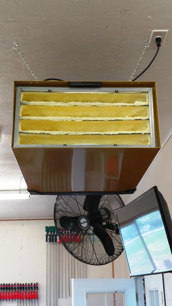

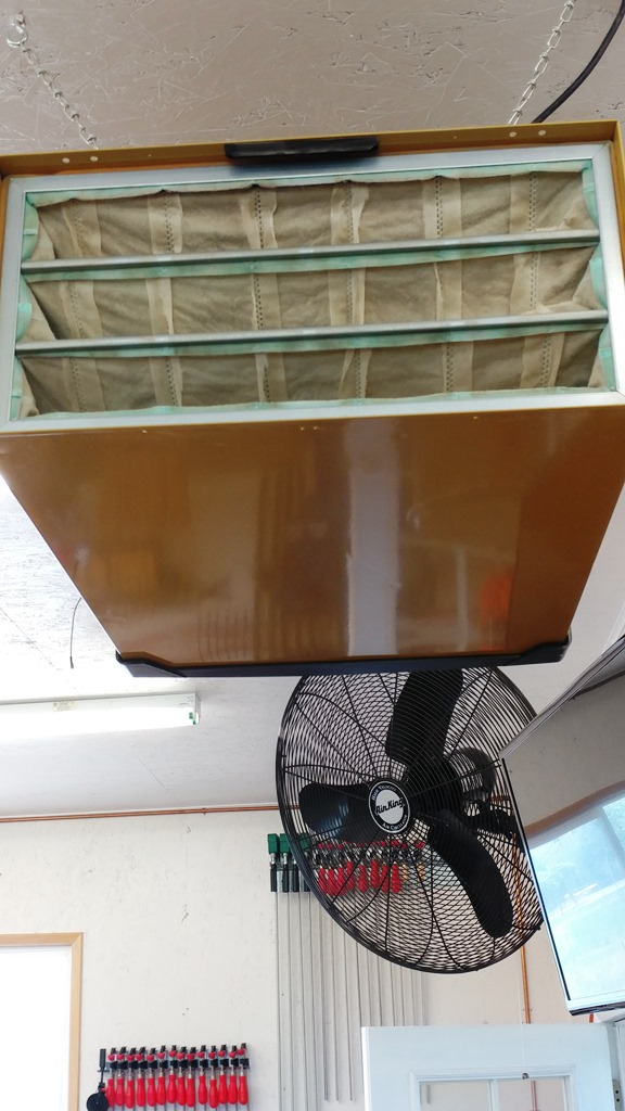

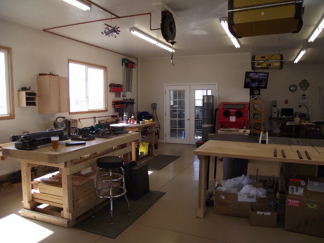

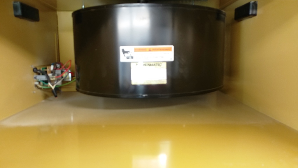

Here is an example from my shop. I have two Powermatic ambient air filters hanging from the ceiling. They came with 1 micron inner bag filters. The shop building was built in 2009 and by the time I got the inside finished and the filters hung it was 2010. In June of this year I decided it was time to replace the inner bag filters. I had removed them periodically over the years and blown them out. I replaced them with Wynn 0.5 micron filters. The original filters have 3 bags and the Wynn filters have 4 bags. That is 1/3 more filter area.
https://wynnenv.com/ambient-filters/
I had never cleaned the inside of the filter cabinets. The first picture shows one of the filter cabinets after 7 years. Yes there is a very small amount of dust but that is 7 years worth. I don't have a picture of the other filter cabinet but it had no visible dust. It is the one in the last picture over the table saw.
The second and third pictures show the original OEM filter bag and the Wynn replacement. The last picture shows both filter's placement in the shop.
Filters from the big box stores, even the best ones will not do the job. Yes, they will get dirty with the biggest particles but that is not the problem. It is the smallest particles that you can't see that do the harm. Again, don't be fooled into thinking a $10 filter from the big box stores is really cleaning the air.
