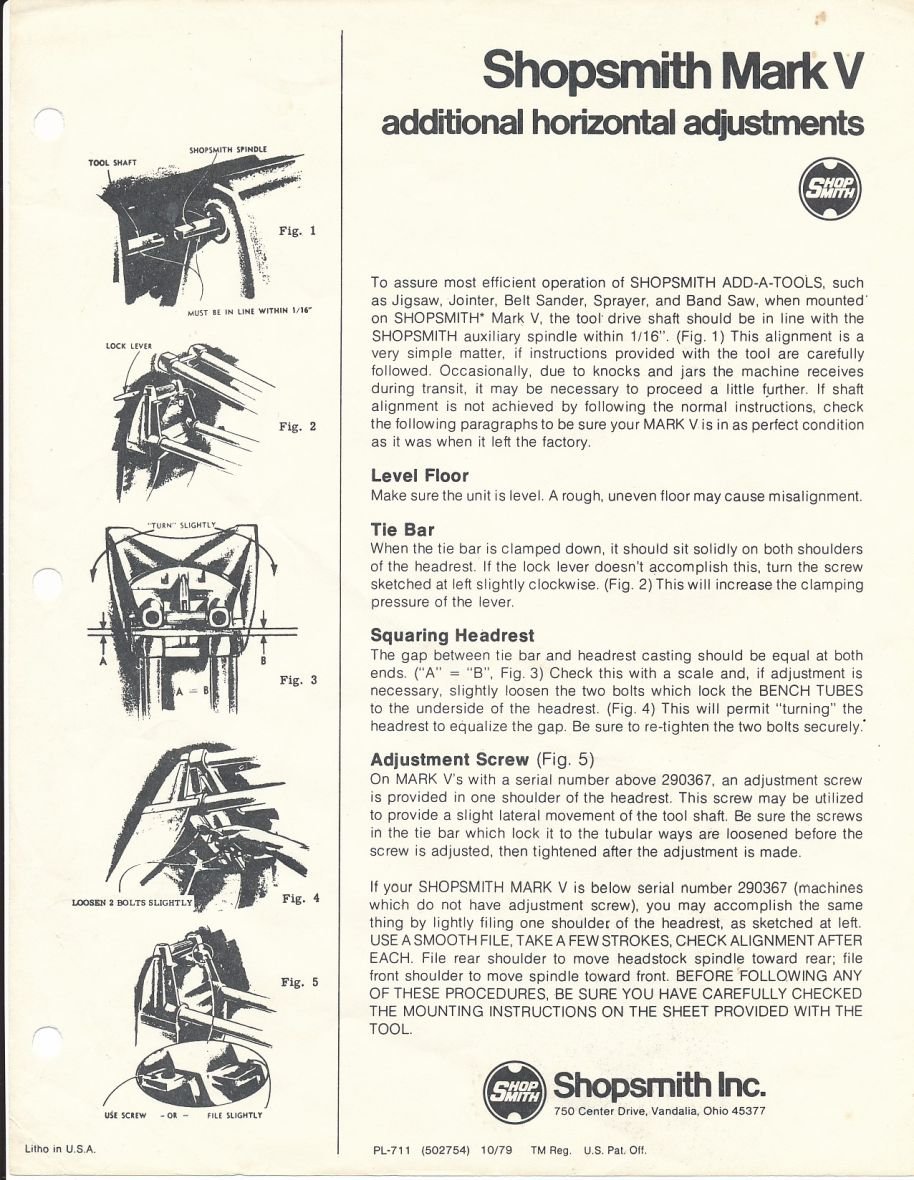

I can see the pic in reible's original post on page 2. I'll try re-posting it: - Daviddb5 wrote: Wed Dec 30, 2020 4:19 pm I read through this which is the exact problem I have. Unfortunately MG_20180123_0002.jpg is not there. So, what is the solution?

In my view that 'fix' creates other problems. The newer tubes should accommodate this. The older (straight) tubes require shifting the legs/end casting(rotating about a vertical axis).db5 wrote: Wed Dec 30, 2020 4:19 pm I read through this which is the exact problem I have. Unfortunately MG_20180123_0002.jpg is not there. So, what is the solution?
All been said earlier.
