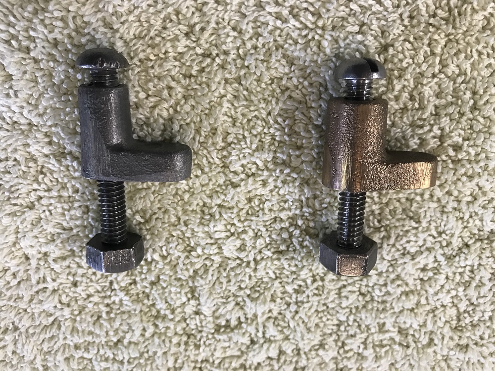

One of the differences I have noticed between this early Model 10E and later 10E's is the use of brass parts. The early wedges were brass and so is the Stop Flange part number 103-12 used in the table trunnion assembly. My 10E S/N 4708 also had this part in brass but later Model 10E's S/N 8865 and above that I have or have had no longer had this part in brass nor brass wedges.

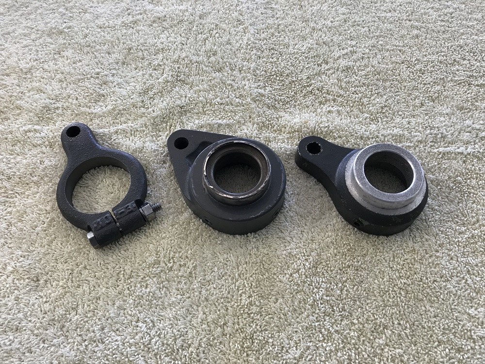

In doing the comparison of parts I am reminded of one I found when restoring S/N 4708 and S/N 8865. As with this 10E, 4708 has the early Quill Gauge Collar which was replaced by the collar which allows attachments to the quill such as the Mortise. 8865 has a cast iron version of the collar where as others are Aluminum. The Cast Iron Collar is the center one below.

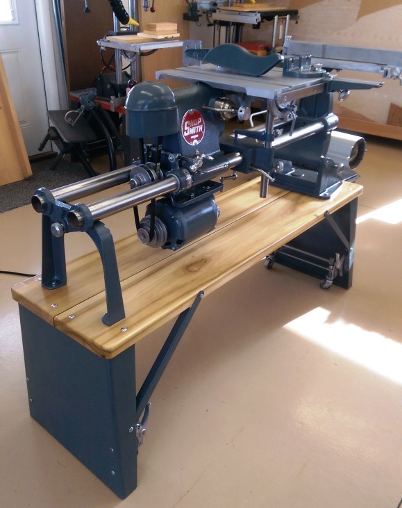

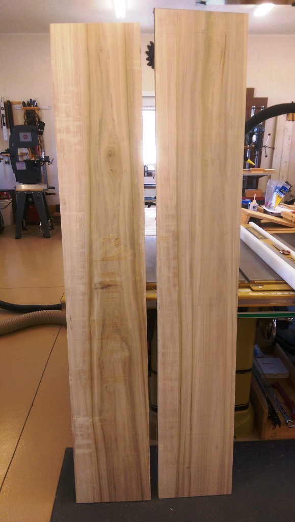

Re: New to Me Model 10E Serial Number 1077

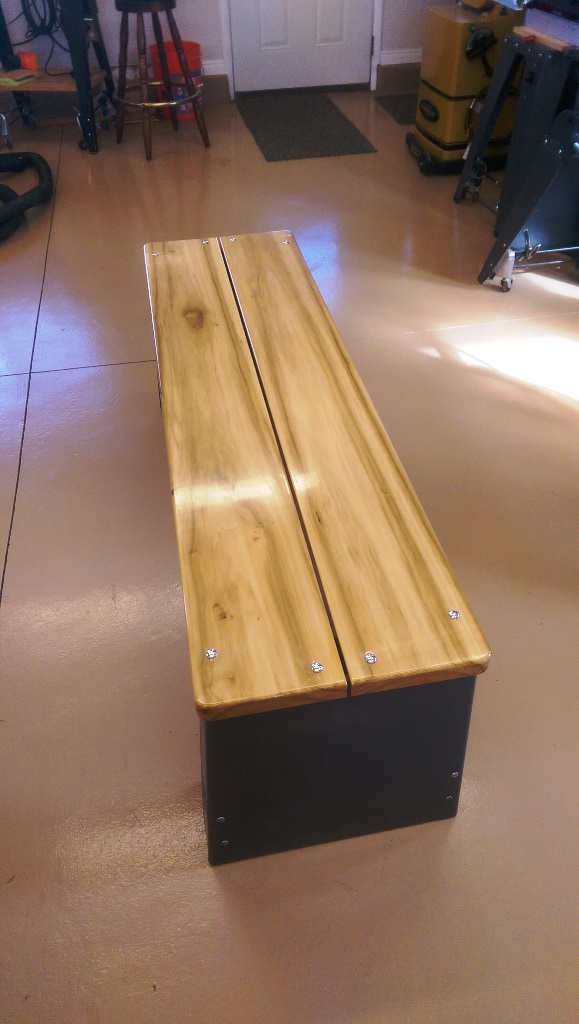

I would use something "nicer" particularly given the serial number of the machine. I used 6/4 popular. Maybe it is not "nicer" but different. I spaced the metal legs the distance Magna specified but I made the boards wide enough and long enough to overhang the legs 1/2". The outside top edges were rounded over with a 1/4" round over bit. The two inside edges down the center were rounded over with a 1/8" round over bit. Finished with 3 or four coats of Helmsman poly.chapmanruss wrote:Sorry for not posting for a while but I was busy with other things and just returned from vacation. Next I have some honey-do's to work on like moving a wall, adding a closet, remodeling a bathroom and installing about 850 Sq. Ft. of flooring so my progress on the 10E has slowed. Soon I will have to build it's bench using Shopsmith Metal Bench Ends and Retractable Wheels I have but I need to decide what wood to use. Should I use standard 2" x 8" boards or something nicer? On the first one I restored (S/N R64000) I used KD 2" x 8" lumber which came out very nice looking with a good finish on them. My wife was upset that I used such nice pieces of wood for a bench to mount a tool on and that it should be for a bench to sit on. As I get the painted pieces finished it is nice to start mounting them on the bench beginning with the Base and re-assembling machine. That way they are not getting moved around the shop and knocking paint chips off of them.
- IMAG0239.jpg (175.28 KiB) Viewed 22482 times
- IMAG0250.jpg (163.78 KiB) Viewed 22482 times
- IMAG0329.jpg (121.96 KiB) Viewed 22482 times
- Posts: 4538
Beautiful wood on that bench John. That is kind of what I was thinking about. Wood with a more interesting grain pattern than plain fir boards. Besides nice wood a great job on the restoration of that 10ER.

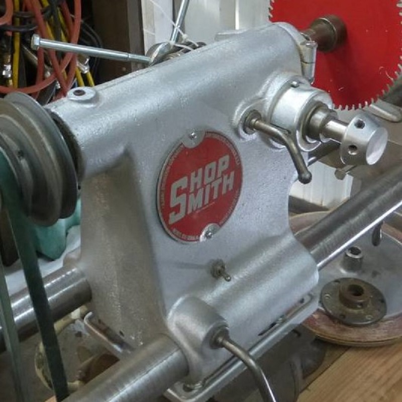

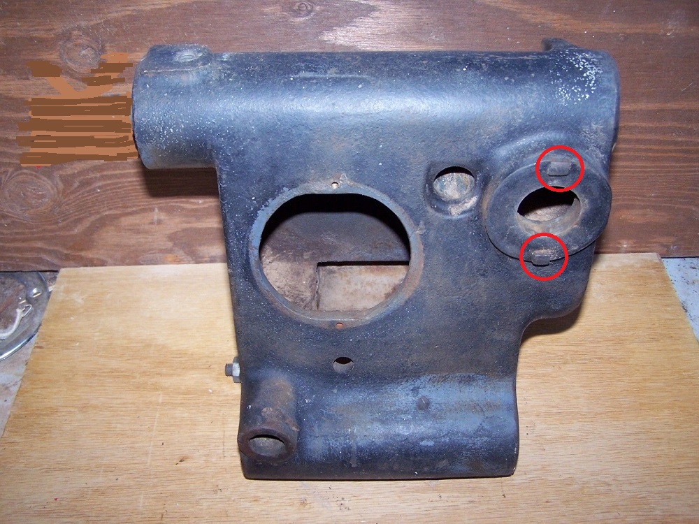

In my comparison of parts from my early 10E (S/N 1077) and later Model 10's I noticed the following from a 10E S/N 1922 for sale near me. It appears to have the same pin to hold the Quill Spring Housing in place as my 10E S/N 1077 instead if the more common cast on blocks. I have not been able to see it in person as it is about three and a half hours away from me.
Below is the more common cast on blocks on a later 10ER Headstock.
Hi Dennis,
Thanks for adding to this. The headstock with the wider cast on Spring Housing Blocks is the last version of the headstocks. It is a picture I happen to have to show this version of the headstock, not from one I have owned. I had not noticed until now the two widths. I just went out to look at the Model 10's I currently have. Here is what I found-
S/N 1077 has the pin (headstock version 1)
S/N 4708 has 2 narrow castings (headstock version 2)
S/N 17731 has 1 narrow casting - lower only - never had an upper one (headstock version 2)
S/N R36013 has 2 narrow castings (headstock version 3)
S/N R55037 has 2 wide castings (headstock version 4)
S/N R64000 has 2 wide castings (headstock version 4)
S/N 69236 has 2 wide castings (headstock version 5)
The first three have plain Spring Housings and the other four have the Indexing Spring Housing. A good thing to know if someone is changing the Indexing Spring Housing for some reason and wants to get the correct cast on block width opening. With that said, yes I found there are two different Indexing Spring Housings. One for the narrow casting blocks and one for the wider casting blocks. I did not know that before. It is interesting that Magna did this since they then needed to recast the Spring Housing to match the wider blocks.
This is how I have been defining the different Headstock versions which is a little different than Everett has. The serial numbers listed are ones I own or have owned.
5 Headstock versions (plus the preproduction headstock with the front drive sleeve set screw)
1 – First 10E’s Pin for Quill return spring housing instead of cast on blocks as on all later headstocks, brass double wedge quill and way tube locks (10E S/N 1077)
2- Double wedge quill and way tube locks (10E S/N 8865, 13223, 17731, 19541) Early 10E brass double wedges for quill and way tube locks (10E S/N 4708)
3 - Double wedge quill and way tube locks & keyed quill lock (10E S/N 25951, 10ER S/N’s R33231, R36013, R41856, R42458, R50474)
4 - Single wedge quill and way tube locks (10ER S/N’s R55037, R55582, R57367, R60582, R63716, R64000)
5 - Single wedges but cutout behind logo plate (10ER S/N R64381, 69236, 76928)
I looked at the pictures of the ones I have already restored and sold to see how they fit into the Spring Housing block castings. Below is the results with the five I still own. I did not have pictures good enough to identify what 10E S/N 13223 had.
Pin with plain Housing (1077) Headstock 1
Narrow castings with plain Housing (4708, 8865) Headstock 2
Narrow casting - bottom only with plain Housing (17731, 19541) Headstock 2
Narrow castings with Index Housing (25951, R33231, R36013, R41856, R42458) Headstock 3 & 4
Wide castings with Index Housing (R50474, R55037, R55582, R57367, R60582, R63716, R64000, R64381, 69236, 76928) Headstock 4 & 5
When you look at all the changes made to the Headstock it appears we may have at least 7 versions not counting the pre-production headstock.
