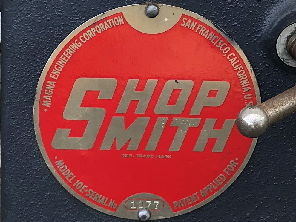

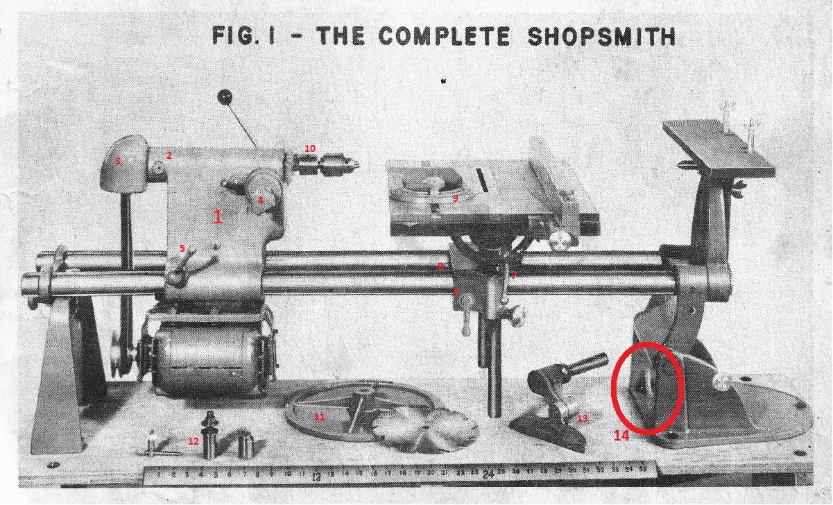

Just picked up another restoration project, as if I did not have enough with the 4 I already have waiting. This one needs to be saved as if I am not mistaken, it is one of the original 250 shipped out October 15, 1947 to Montgomery Ward stores on the West Coast. It does answer some questions about the original 10E and the pre-production one shown in the original manual sent out with them. It has the first 10E headstock not the one shown that Everett has named the Model 10. The base, arm, headrest, carriage, tie bar, etc. are the same ones common to the 10E. Of note is the 8" Lathe Tool Rest. It is the one shown in that original manual with it's post to mount it in the arm a screw in part. It did not have an arbor with it so I am unable to answer the question about an earlier arbor like the one shown in the original manual. I will add that it is in very good shape for a 70 year old machine and has very little rust. More in the PDF below.

Great find! I noticed that in the PDF the extremely scarce large back Rip Fence Lock Assembly is present so this guy got an upgrade somewhere back in the day.

It does have the Rear Fence lock addition but still had a wood extension table and not the original wood. This is my third Rear fence lock and one is in the box still, never used. I bought this from the nephew of the original owner and I'm hoping he can find some of the original paperwork in his uncles stuff. I live just outside of Portland, Oregon and it was here. Being on the west coast gave me a better chance at finding it. Portland had one of the Montgomery Ward catalog warehouse stores. It's 10 stories tall and the first 4 floors were retail space and the rest was the catalog warehouse.
I would love to get to Ohio sometime and tour the Shopsmith factory. Is SN 0002 one of the pre-production units used as demo and factory machines that look more like the one shown in the original manual? I hope you can get some pictures. Maybe you can find out more about the documents from Goldschmidt you have mentioned before. I have to ask do you believe as I do that the Serial Numbers for production machines sold to the public started with 1001? Not counting the 10ER's sold in Australia the lowest numbers I have seen are 1032 from Skip's list, 1036 that was for sale a few years ago in eastern Washington and this one at 1077.

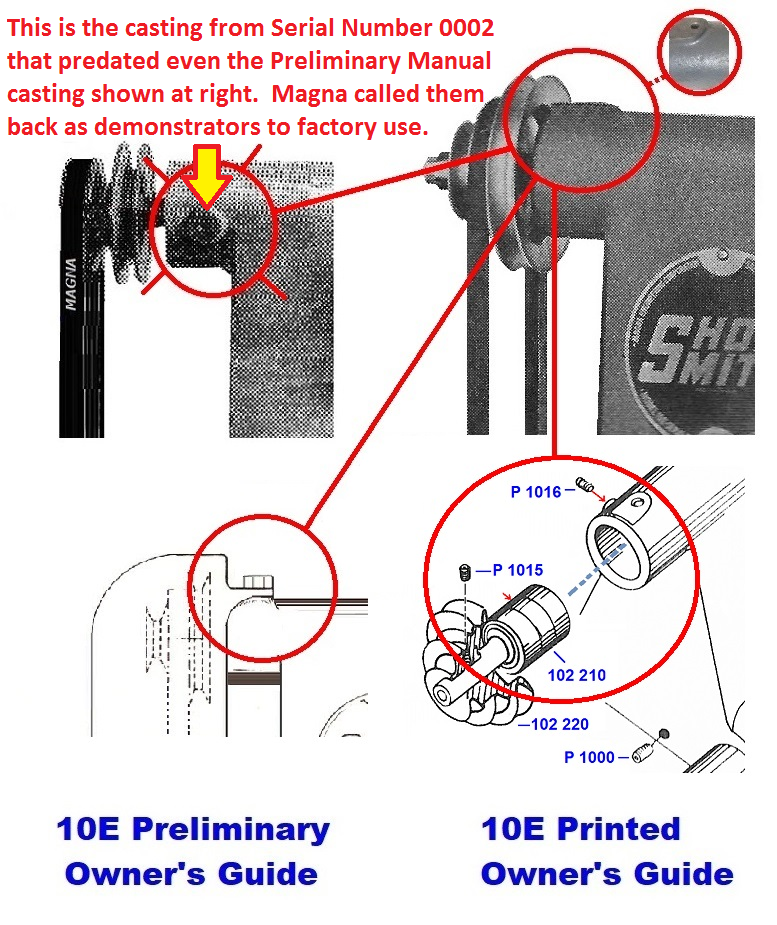

To my understanding the original casting headstocks were the first handful of demonstrators that were ALL pulled back to the factory and used as precision drill presses in production of the 10E that was sold to Montgomery Ward.
These headstock castings are different than the 10E (10 Enhanced as I have heard some old-timers call them) and opposed to the 10ER (10E Revised again as I have heard some old-timers call them)
That is why I named that Casting the 10, which was so early in manufacturing, that even the Preliminary Manual already had the 10E headstock shown with the revised casting.
I understand keeping 1077. If you ever change your mind.... contact me first.
Everett
10 vs 10E Headstock Casting.png (661.33 KiB) Viewed 40914 times

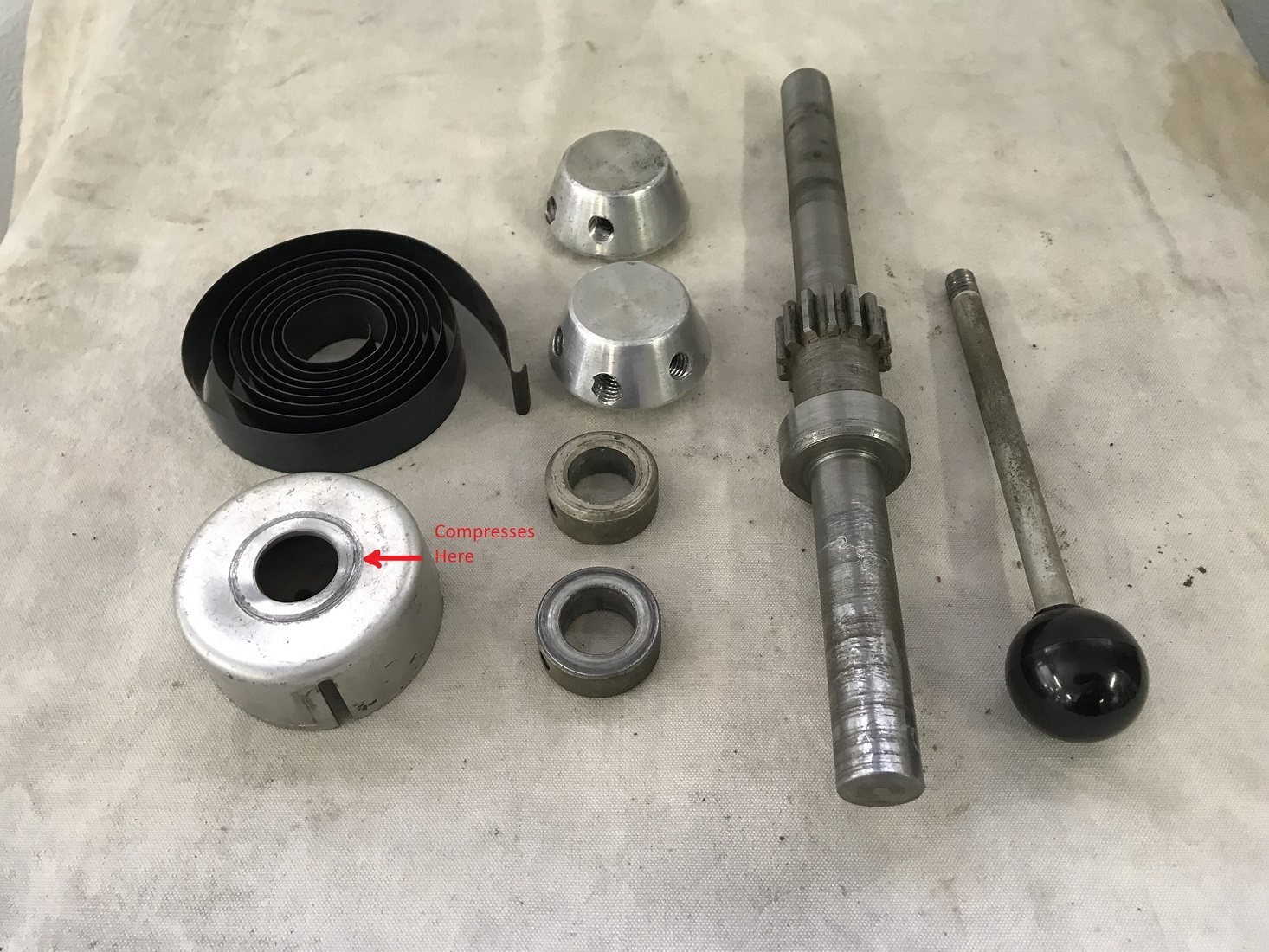

Brass Wedges all around. We may have an additional headstock version depending on how you want to address changes. This one does not have cast on blocks to hold the Quill return spring housing in place but has a single pin instead.
Headstock Pin.jpg (285.42 KiB) Viewed 40688 times
Also the Quill return spring housing is made of aluminum and bends quite easy. Probably why they changed the material it was made out of. I will try to save it but for function a steel one may need to replace it. The collar compresses it in around the hole that slides over the Pinion Shaft until it pinches the spring against the larger pinion shaft sleeve, next to the gear teeth. To keep the spring from unwinding because it is not being held tight against the headstock and pin the collar has to be readjusted in. I hope that makes sense. It may be hard to show that in a picture and I have almost everything apart right now.

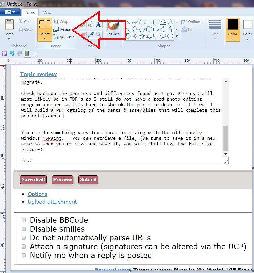

You can do something very functional in sizing with the old standby Windows MSPaint. You can retrieve a file, (be sure to save it in a new name so when you re-size and save it, you will still have the full size picture).
Just (paused a second while I grabbed a screen shot of this and illustrate how to do it) You can resize by Percent or by Pixels. Easy to do in pixels and you just select the Horizontal or Vertical you need to bring it down to, and plug in that number. Paint resizes it, and you save, and then you can upload to Forums in a size they will take. I like using it as no matter what Windows based computer I may be on, has MSPaint installed.
Everett
See below:
For Russ.png (121.37 KiB) Viewed 40822 times
