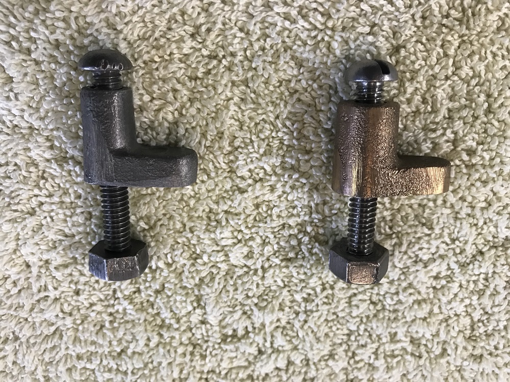

One of the differences I have noticed between this early Model 10E and later 10E's is the use of brass parts. The early wedges were brass and so is the Stop Flange part number 103-12 used in the table trunnion assembly. My 10E S/N 4708 also had this part in brass but later Model 10E's S/N 8865 and above that I have or have had no longer had this part in brass nor brass wedges.

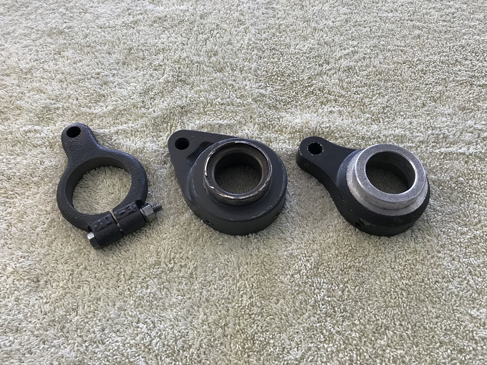

In doing the comparison of parts I am reminded of one I found when restoring S/N 4708 and S/N 8865. As with this 10E, 4708 has the early Quill Gauge Collar which was replaced by the collar which allows attachments to the quill such as the Mortise. 8865 has a cast iron version of the collar where as others are Aluminum. The Cast Iron Collar is the center one below.

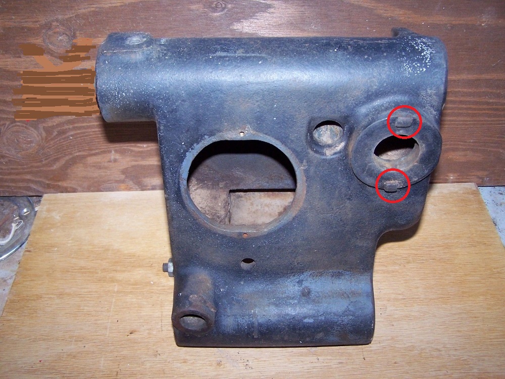

In my comparison of parts from my early 10E (S/N 1077) and later Model 10's I noticed the following from a 10E S/N 1922 for sale near me. It appears to have the same pin to hold the Quill Spring Housing in place as my 10E S/N 1077 instead if the more common cast on blocks. I have not been able to see it in person as it is about three and a half hours away from me.

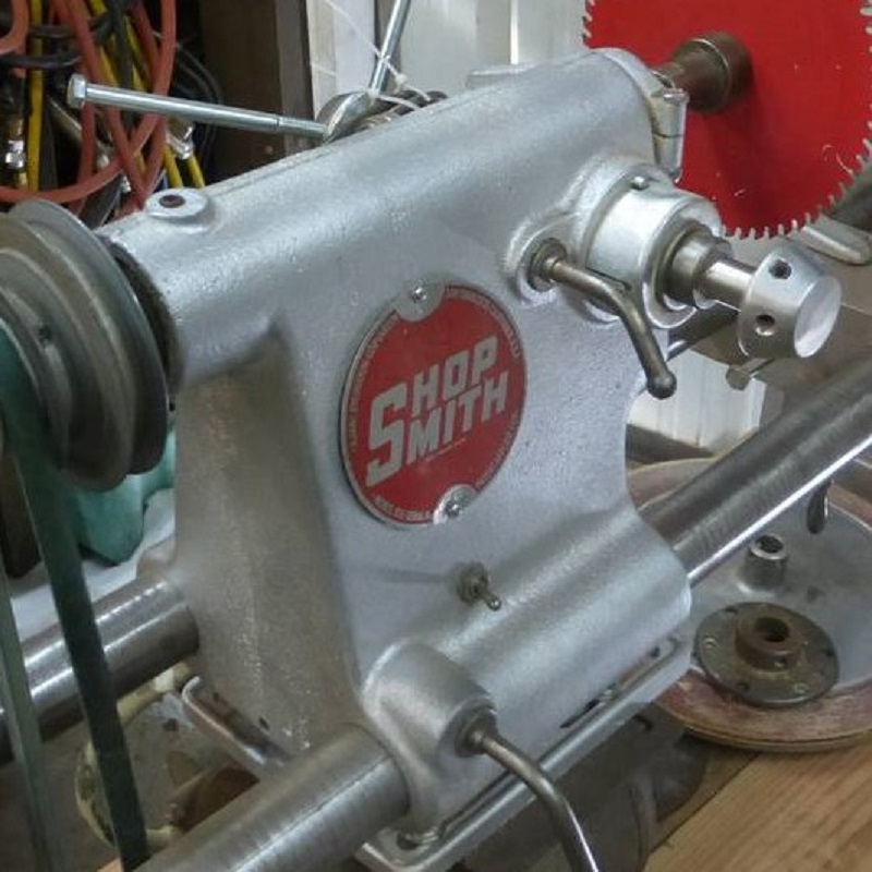

Below is the more common cast on blocks on a later 10ER Headstock.
Headstock 102 110 V5 r.jpg (297.63 KiB) Viewed 22425 times
Everett,
If I am correct that 10E S/N 1922 has the pin, then does your 10E S/N 1414 also have the pin instead of the cast on blocks? Also is your Quill Spring Housing aluminum or steel? On 10E S/N 1922 above it looks like the side of the Housing is "pushed" in similar to my Aluminum one on 1077. Steel ones do not tend to "push" in like that. I wonder if that is the reason they added the extra washer.

Russ, my 10E SN 1750 has cast bosses and a steel spring housing. But the cast bosses appear to be a bit smaller than the ones in your photo.

Thanks for adding to this. The headstock with the wider cast on Spring Housing Blocks is the last version of the headstocks. It is a picture I happen to have to show this version of the headstock, not from one I have owned. I had not noticed until now the two widths. I just went out to look at the Model 10's I currently have. Here is what I found-
S/N 1077 has the pin (headstock version 1)
S/N 4708 has 2 narrow castings (headstock version 2)
S/N 17731 has 1 narrow casting - lower only - never had an upper one (headstock version 2)
S/N R36013 has 2 narrow castings (headstock version 3)
S/N R55037 has 2 wide castings (headstock version 4)
S/N R64000 has 2 wide castings (headstock version 4)
S/N 69236 has 2 wide castings (headstock version 5)
The first three have plain Spring Housings and the other four have the Indexing Spring Housing. A good thing to know if someone is changing the Indexing Spring Housing for some reason and wants to get the correct cast on block width opening. With that said, yes I found there are two different Indexing Spring Housings. One for the narrow casting blocks and one for the wider casting blocks. I did not know that before. It is interesting that Magna did this since they then needed to recast the Spring Housing to match the wider blocks.

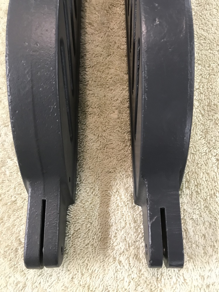

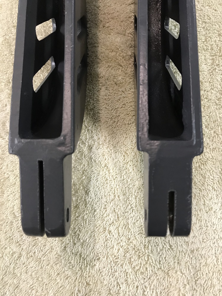

Last night I was spending a little time working on the Shopsmith. I noticed something about the Saw Guard part 103-34. The slot where the Splitter goes is not as deep for the Saw Guard that belongs to this 10E. It cannot use the same splitter as later ones have.
1077's Guard is on the right
103-34 Saw Guard top 1077s on right r.jpg (295.95 KiB) Viewed 21943 times
Later 10E Guard is on the left
103-34 Saw Guard bottom 1077s on right r.jpg (315.03 KiB) Viewed 21943 times
The Splitter part, number 103-35, was missing for this machine. It is hard to know what it looks like since the Original Manual pictures of the 10E do not show the Saw Guard and Splitter. Only Everett's diagrams at the end of the manual show a splitter which looks the same as later ones.

chapmanruss wrote:Last night I was spending a little time working on the Shopsmith. I noticed something about the Saw Guard part 103-34. The slot where the Splitter goes is not as deep for the Saw Guard that belongs to this 10E. It cannot use the same splitter as later ones have.
$matches[2]103-34 Saw Guard bottom 1077s on right r.jpgThe Splitter part, number 103-35, was missing for this machine. It is hard to know what it looks like since the Original Manual pictures of the 10E do not show the Saw Guard and Splitter. Only Everett's diagrams at the end of the manual show a splitter which looks the same as later ones.
Everett are the drawings for the Original Manual you restored from that manual or did you create them?
Check the 10E preliminary manual Everett restored from my original. It shows the guard and spliter in the diagrams at the end of the manual. There is only one view but it might give you a hint .
