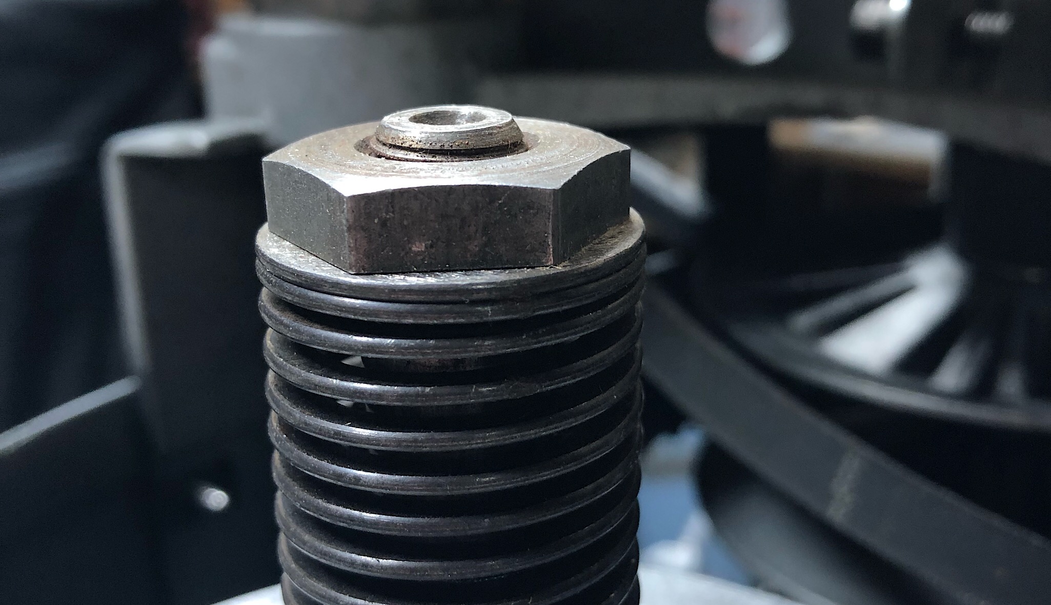

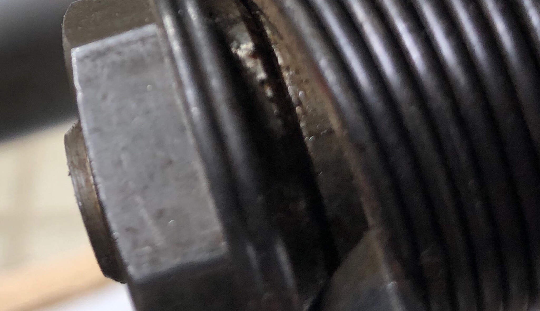

Also, this is a pic of the nut on the end of the motor shaft.
Based on the amount of the protruding shaft, is the nut too tight? If the protrusion was less there would be slightly more room for the sheaves to expand. Dangers?
And, what would be the pros and cons of milling 1/4” off the front end of that stub on the motor sheave? Just thinking.

Been awhile since I did fastener inspections but IIRC, minimum of one full thread should be exposed after tightening a regular fastener or flush with a nylock fastener. There is one thread exposed as shown in your picture so I would not loosen it any.

I believe the nut should be tightened until it bottoms out. BTW it is a left hand thread.

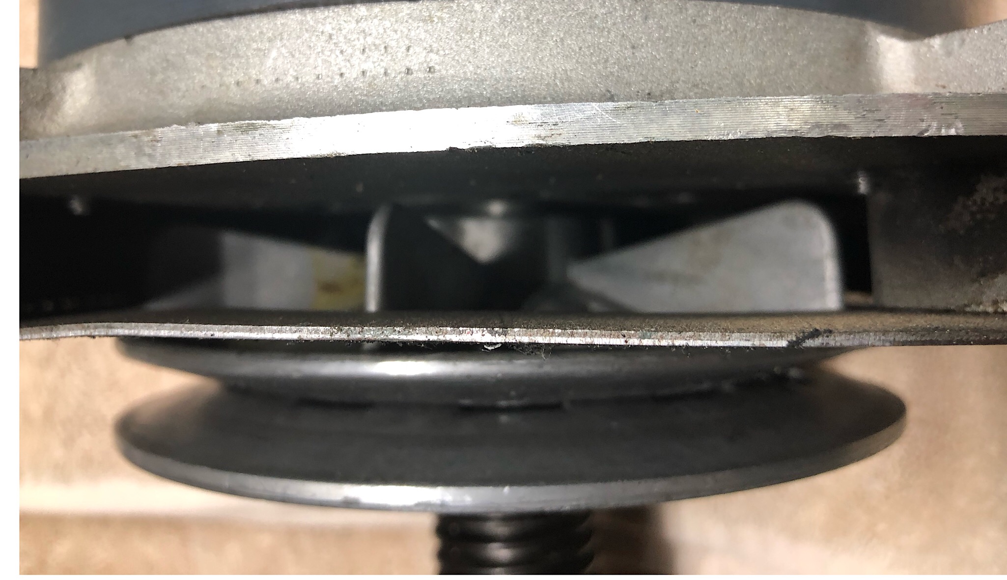

Thanksgiving is over, back to work. To verify the spacer was grounded against the motor bearing I had to take the machine apart. I have a 3/4hp A O Smith motor. The only access to the Allen screw that secures the fan sheave to the motor shaft is on the side of the motor that faces the motor pan. So I had to take the motor out. On initial inspection it appeared the spacer was grounded.
But I reseated the spacer and the sheaves anyway. Both before and after the reseating there was a very small, less than 1/16”(?), of in/out movement of the motor shaft.
With the original OEM belt installed I plugged in and ran the machine. It runs but at an even faster speed. And the speed control binds at “D”.
Something I have not mentioned because I don’t see any relation to my problem- I’ve wired this motor to run both forward and reverse. Have not had any issues with running in either direction. Except it runs fast and the speed controller binds at slow speeds.
Your thoughts?

Well so much for THAT theory! :(
Obviously from that pix, the floating sheave is closing fully against the fan sheave.

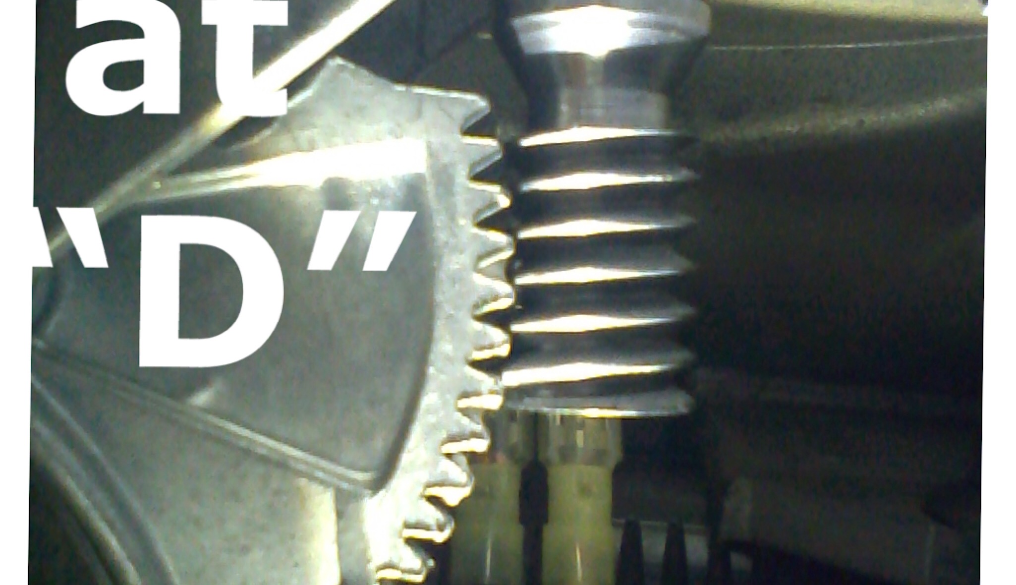

The speed controller stops at “D” because the stub of the motor sheave grounds out at the nut on the end of the motor shaft. There’s no more room for the motor sheave to move to allow the sheaves to open to allow the belt to move closer to the center to produce a slower speed.

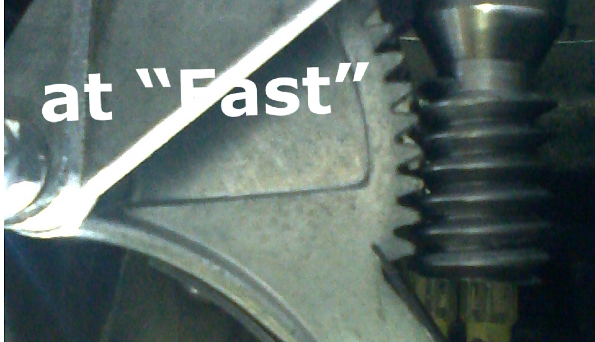

For the record these are pics of the quadrant taken from under it (camera laying on the motor). The text on the pic shows “Fast” and “D” positions.
