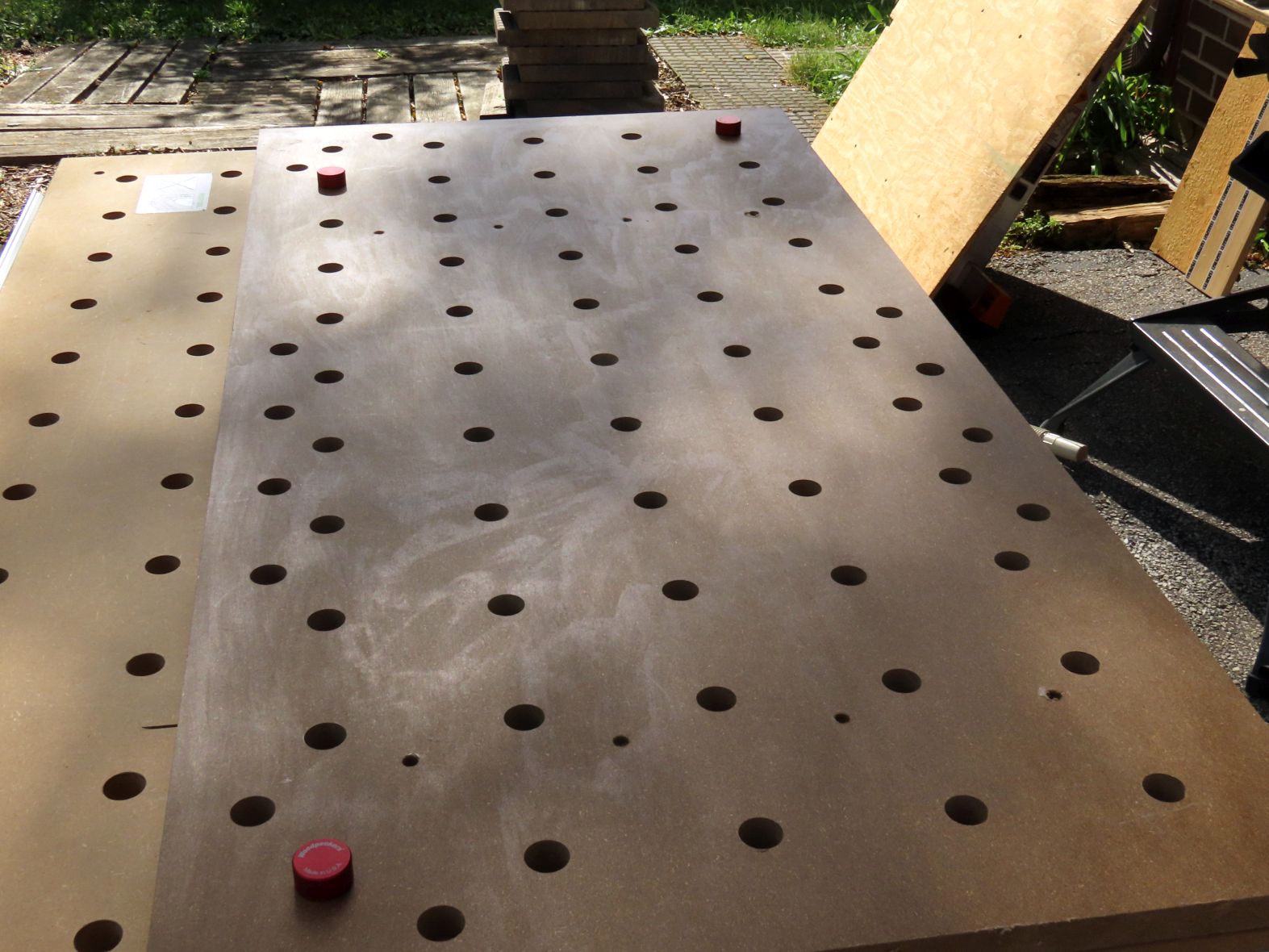

I have used indexing pins many times on my CNC for two sided machining and have found the to be very accurate if used correctly. I have no fear that I can attain better than .001" accuracy for each move of the tape board. Compared with the possible error generated by an increase span distance that is insignificant. Repeatability is one of the SO's strong suits. As long as there is no change in the tape layout and the geometry there is no reason it just doesn't keep cranking out the same results in hole placement for each sector. But we will see how it works out.
Re: Today in the shop (shopsmith MFT V2)
If you can really get .001" accuracy from the starting location to each pin then it will pretty likely work. Certainly try it.
I really don't have the time or desire to explain how this tolerance thing should work but for things like an MFT in theory all measurements should be from one point so that any one of them being off will not effect the others. By using index pins you create groups with each group being as accurate as the others but if any error creeps in during the indexing then the over all hole placement will be off.
I wish there was a way to really get accurate measurements of this sort of thing. I didn't really expect holes on each end of mine to align yet they did. I was expecting the error to be progressive away from the 0,0 point.
This was my very first try and when I got the first two in I figured the other end, in this case the one closest to the camera wouldn't fit. But it slid right in.

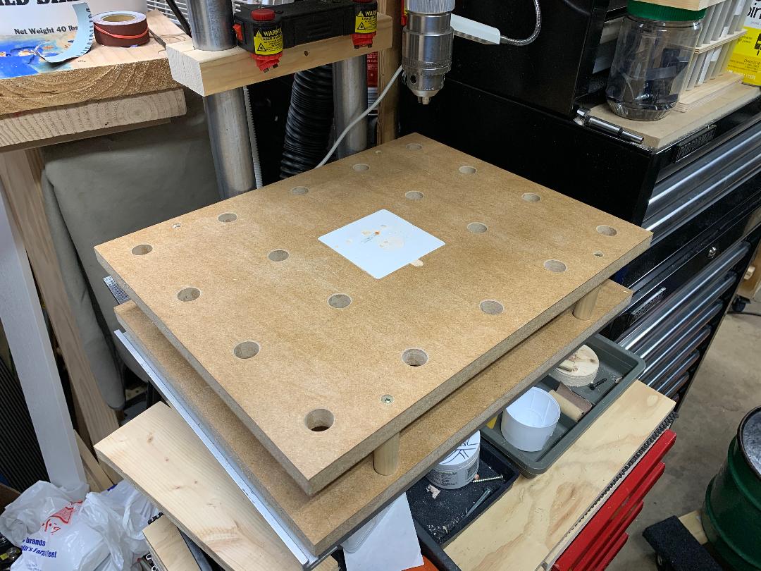

This is my drill press table with the 20mm hole and 96mm spacing. I clamp it to my shopsmith main table which allows some additional placement adjustments.
I pretty much leave it on but not attached so I can adjust placement or take it off and get it out of the way.

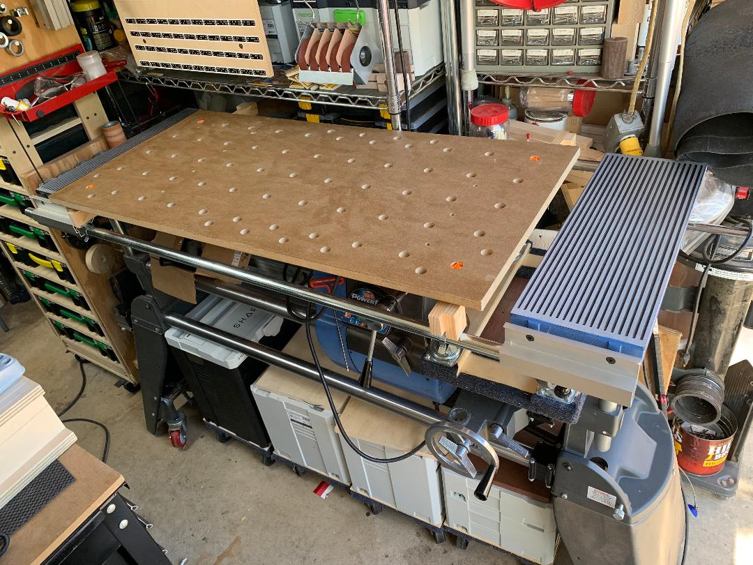

The last couple of days I had my shopsmith mft set up for some projects so just before I took it down today I shot a picture.
It was nice having the table pretty high for this usage, and as you might notice I have the extension tables mounted backwards to give me more room in the front, it all works.
