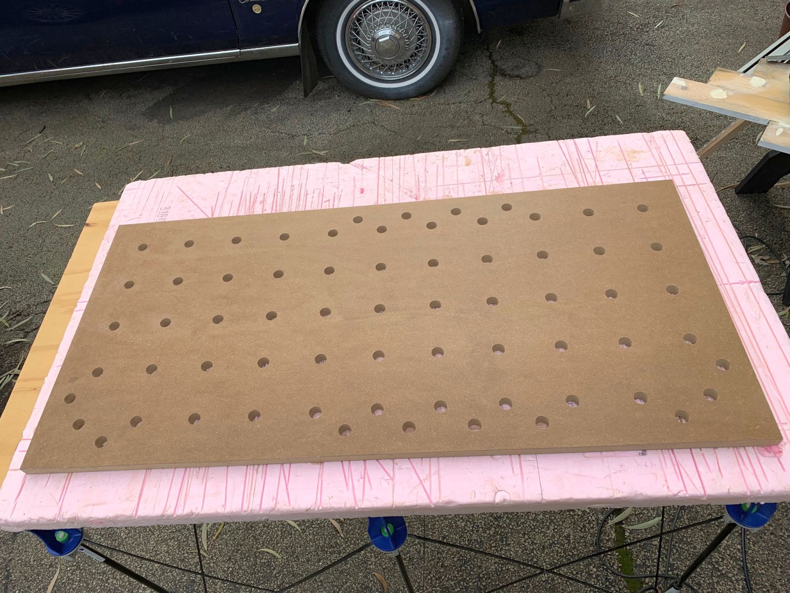

Got some SO time this afternoon and did the holes for the table. Not sure when I will get back to it and get the other parts built but at least this much is done.
Now it's already to have the rest built.

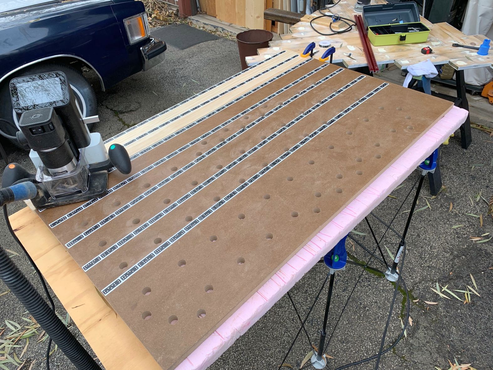

One sure could make the variation of tops that have sprung up since the MFT system became well known. The MFT/3 top has a 7 x 11 hole arrangement while the one I just made is a 5 x 11 with some extra holes.
The actual cutting goes pretty fast. Once the file is placed you just go from hole to hole and hit the green button, it helix cuts it and comes back up, then move to the next hole. I didn't time it and I was multitasking so while most of it was done this afternoon so was a few other things.

I now have the top put together and ready to clip on. Felt to tired to do that and it was getting late so I'll save that for another day. I just hope I didn't mess something up.

If you have a MFT/3 it is indeed a good idea to just invest in a new top since the material is better then the MDF you get at the box stores. What may not be obvious is that top can possibly be rotated and certainly be turned over to extend the life. If and when I get to the point of needing a new one I will more then likely order one rather then make my own unless I find a source for the material.
Now I have the woodpecker jig, the SO and a set of dogs I had made up which uses the old MFT for hole locations. All of these work well with smaller tops and the SO so far seems to be accurate enough for a base which can use the holes for location and square cutting.
There are drawings and even cnc files out there that would allow you to go to a shop and have your own made up but I have no idea how much that would cost you. I've read that a "one of" might be more expensive so people will have at least a pair made to reduce the cost of each. But if you go custom sixe or shape then you may have to go another path.
